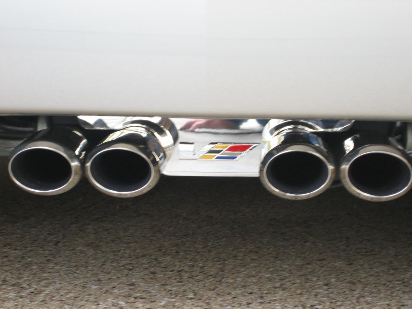

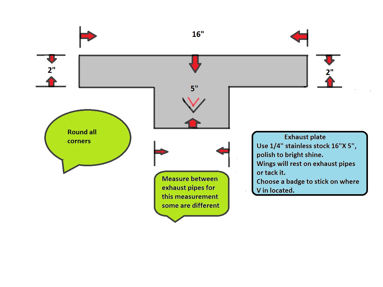

exhaust plate.JPGMember wanted dimensions of my XLR-V exhaust plate, thought I would share. Click to enlarge.
Plate slides in on top of exhaust pipes & as it passes the bumper, raises to vertical & drops in behind the tips & the wings rest on the exhaust pipes. Will not come out unless you want to polish it.

With a change in exhaust you could measure & make a cardboard design until it fits then have it made. A corvette plate would fit as long as you haven't changed the tips very much. I had one on my 04:dunno:
Hi, This will fit factory xlr-v mufflers? Also how is it attached? I'm working with Diana to hopefully make one soon. Thanks for your help😀 V/R,Eric
