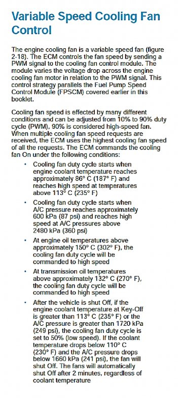

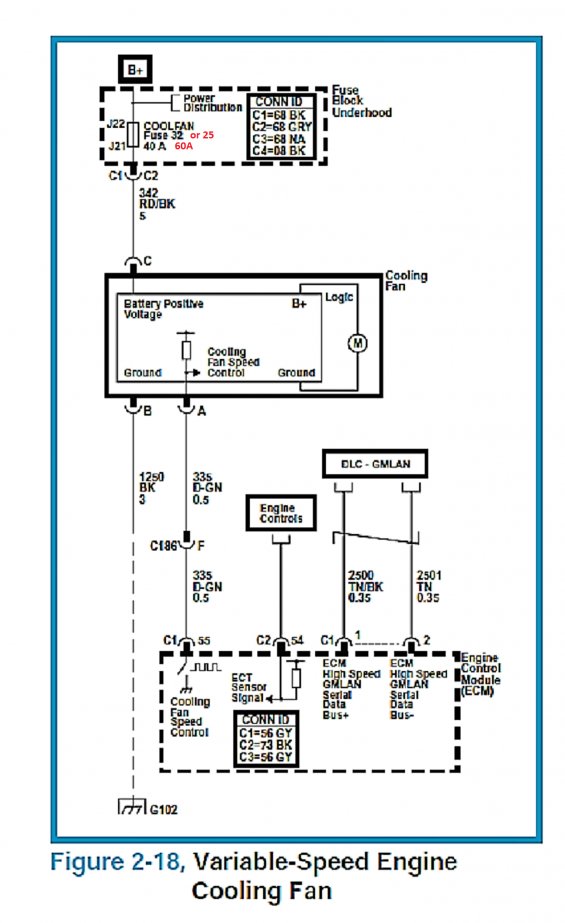

The module of the fan works closely with the engine module (including sensors ) and it speed will varied from slow to very fast depending the oill motor/tranmission and the coolant needed temperature or pressure
Find how it function with the ECM, ( if all grounds are cleans ). having work shop manual and a scanner thech2 would be ideal to fix your XLR problem.
PS. The fuse is also #25 60A, on this diagram it shows #32 40A
IAN :wave:
