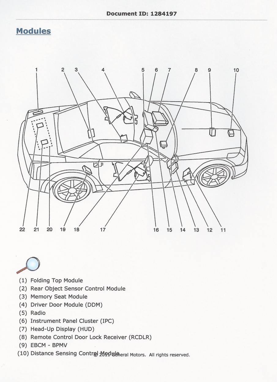

Where is the ECM located?
Not exactly awealth of info but I do have this document I saved.
BTW: What Color/model do you have?!
If I'm not mistaken its in the drivers front wheel well like behind the xlr badge on the fender. Their are a couple modules there. You access everything by taking the inner fender out.

ECM Location
The ECM is mounted on the right side of the dash above where the passengers feet would be.
