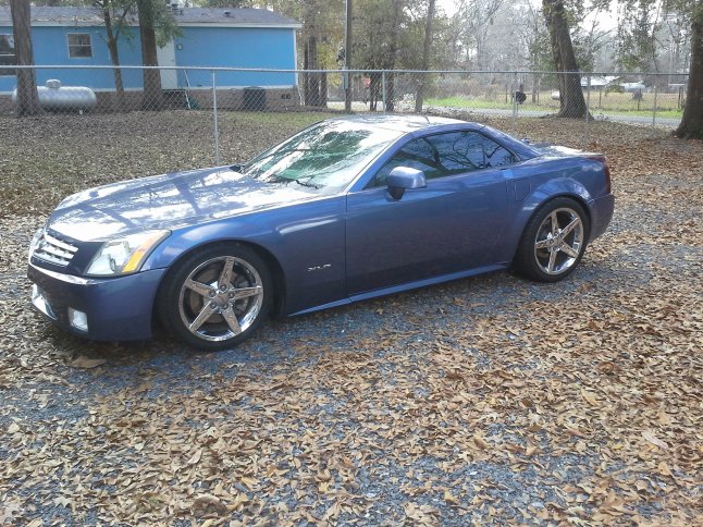

Not sure if this helps at all or not but recently I just changed my wheels from stock on my wife's XLR to the Centennial wheels of a 2013 Corvette and WE LOVE THEM!!! I ordered them from WCC, West Coast Corvettes in CA and Joseph who works there was a big help. I kept the size to 18" and I used 56 mm as a reference point. IOW, if you buy a wheel and it's offset is 57-59mm, you should be safe with the wheel fitting correctly. It just so happens WCC had the wheels I wanted at 18 x 8.5 x 56mm anyway they're on the car and look FANTASTIC! And by staying with 18" wheel, you won't have to worry about recalibrating the speedometer or computer (not sure which) to compensate for the larger diameter wheel. :thumbsup
On the other hand, if you just like the look of 19" wheels, then all of the above is mute! :dunno:

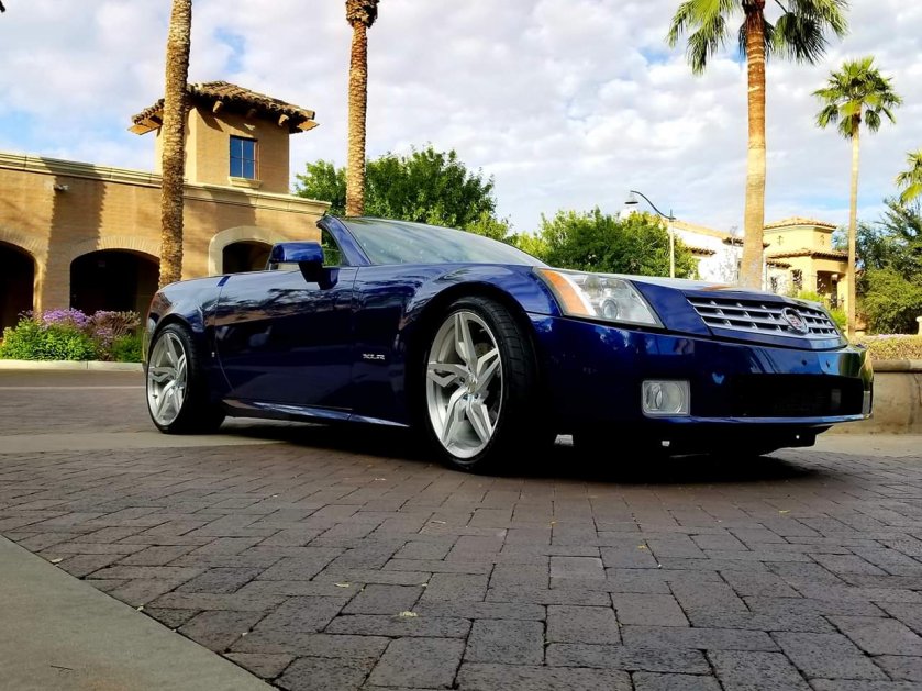

Corvette 245/40ZR18 front 265/35ZR19 rear Love the new aggressive look with a much more accentuated forward rake with the stagger. Ride is a little rough but not so much that it bothers me.

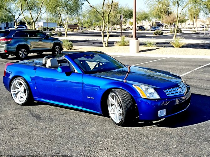

I had these AMF 20" forged, monoblock wheels made. Front's are 20x9 et 45 with 255/35/20's & 20x10 et 45 with 275/30/20 Nitto NT 555 G2's. LOVE them! ...No rubbing!

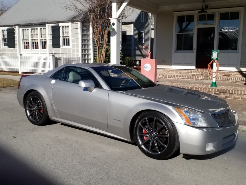

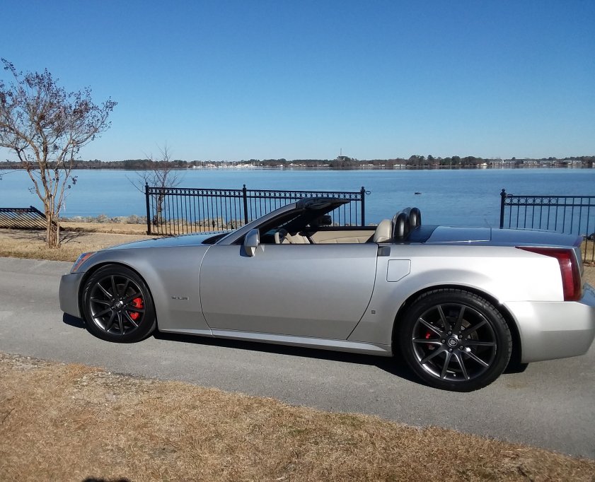

235/45 19 front
245/45 19 rear
I am running 19" 235\45 19 fronts 245\45 19 rear

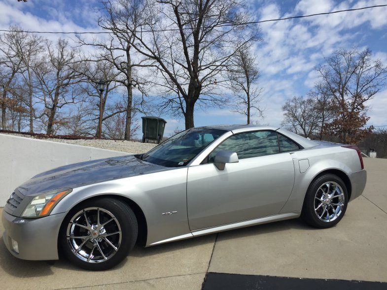

Hi All,
Good afternoon. Just another sunny day in Paradise. Here are the new wheels:

I run a 275/30 in the rear on a 20x10 et45 (see pics above in the thread.) 255/35's on 20x9 et45 up front.

I run a 20X10 +45 with a 275/30 in the rear. They rubbed inside & out until I cut away the inner fender liner & wore away the fender lip! No joke. It's as big as can possibly fit. The D-3 setup mentioned earlier rubbed & smoked like you wouldn't believe. They also ditched the mag ride, went to a Z06 rear leaf, then ultimately to coilovers that were so stiff the rear wheels would bounce off the ground when it hit a small bump over 50 mph.
If you decide to cut away the inner fender liner, you'll find sheet metal that protects the retractable roof gear. I let it rub just enough to show me exactly where it needed to be trimmed away. Crude to be sure, but worked great.
