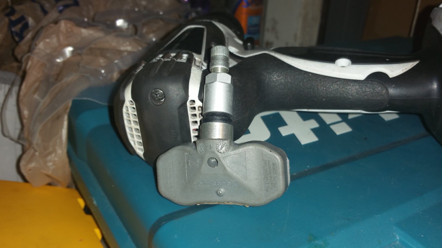

Are the batteries replaceable in the valve sensors and if so where can they be purchased?
They are sealed units. This is what they look like. All sealed up with epoxy on the other side. I have 2 fresh ones ready to be changed out first chance I get
