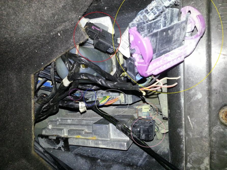

i havent drive my 04xlr in a while due to an accident and it also been in some intense rain and im ready to fix it and the top and trunk will not open .The trunk unlocks with the key and with the FOB and i can open it manually but it will NOT go up automatically
after reading almost every forum about water getting in the trunk box (which i didnt knew we have to check that) i check it and found NO water but found a lot sand dust and one big relay that has a purple lock cover in corrosion and i barely touch it and the cables broke as show in the picture ..
Do i have to replace everything ???What can i do to fix this pigtails ...... and is this means that all this was cover in water or can somebody tell me wat might have happen.
also the dash keeps saying ""SERVICE RIDE CONTROL " and "" NOT GO MORE THAN 80MPH"""
thanks!!
your information would be greatly appreciated ,
I personally would find someone with a tech2 to scan the car. As for the clips be careful. If your not competent or confident in how they disassemble don't mess with them. Theirs a lot of expensive hardware in that compartment. They sell tools to properly clean the connectors that fit the connectors. You do not wanna just start jamming stuff in the connectors. Other than di electric grease for the physical connection that's about it. Maybe bring it to the dealership to have them scan it. Good luck!
It looks like that compartment has been full of water at some time or another. Look at the rust marks on the bolt head in your turnk and other components down in the well. Your ride control module is one of the boards located in the well along with the pump and top control board. Once these parts get wet they are done and it looks like they stayed wet for a while since your connectors and wiring is also failing. GM does make replacement plugs and sockets that can be spliced into the wiring harness and that will be you least expensive part of this repair. You need to find parts at a junk yard as you are looking at well over $2k to buy them new.
If you read all the threads I'm sure you saw my saga. Good grief, hopefully parts are in stock now. Power top module, suspension control module and Power top pump. I could tell you retail prices, but I'll let the dealer surprise you. Plus wiring and connector issues... A reminder, 04 & 05 use unique components, not shared with 06 & later, makes parts shopping more difficult.
Make a friend with a Tech II, and a good honest mechanic. Or just replace the suspension control module and call it a hardtop.
Best of luck with yours.
Bruce
There's nothing going on with your previously-flooded trunk compartment that a lot of money won't fix.
The "relay" you mentioned is a bale lock connector. If it fell apart, you have an electrical mess on your hands.
To properly clean connector pins, you need a pin extraction tool and each pin needs to cleaned and inspected under magnification. Spray-on pin cleaners are hit or miss (-usually miss for long-term reliability.) There isn't much room to do it, so you may end up laying in the trunk for awhile, cleaning them by hand. Depending on the level of corrosion, it may be more practical to have a pro splice in new connectors or replace the wiring harnesss. Again, this will not be cheap.
Your suspension module is fried and your pump and pump control module most likely are smoked as well. Inspect the tip of the drain hose to see if it's crimped shut. If so, cut the tip off so it's a tube again. You should be able to see light through it when viewed from above.
It appears you have been consigned to the seventh level of XLR hell. Your only salvation lies with massive contributions to the church of GM.

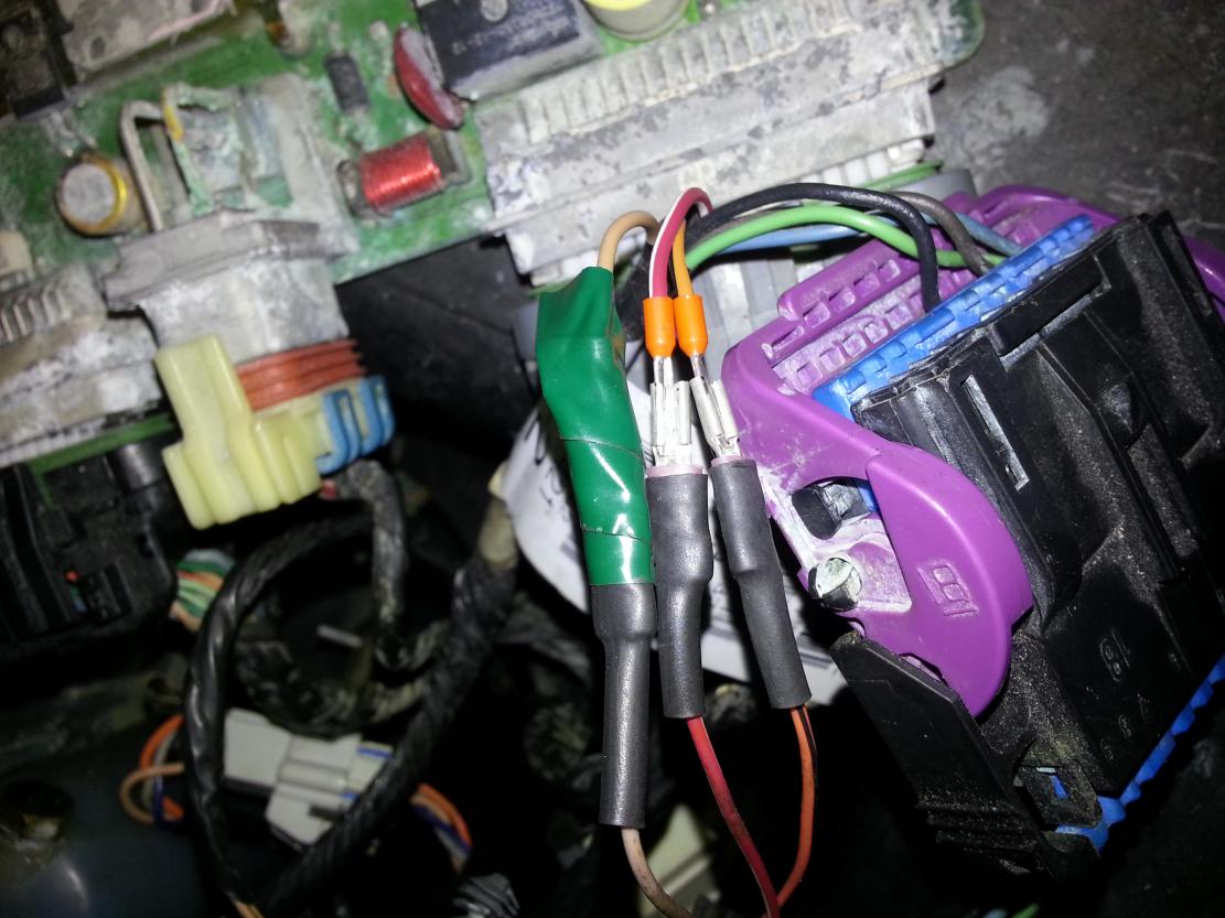

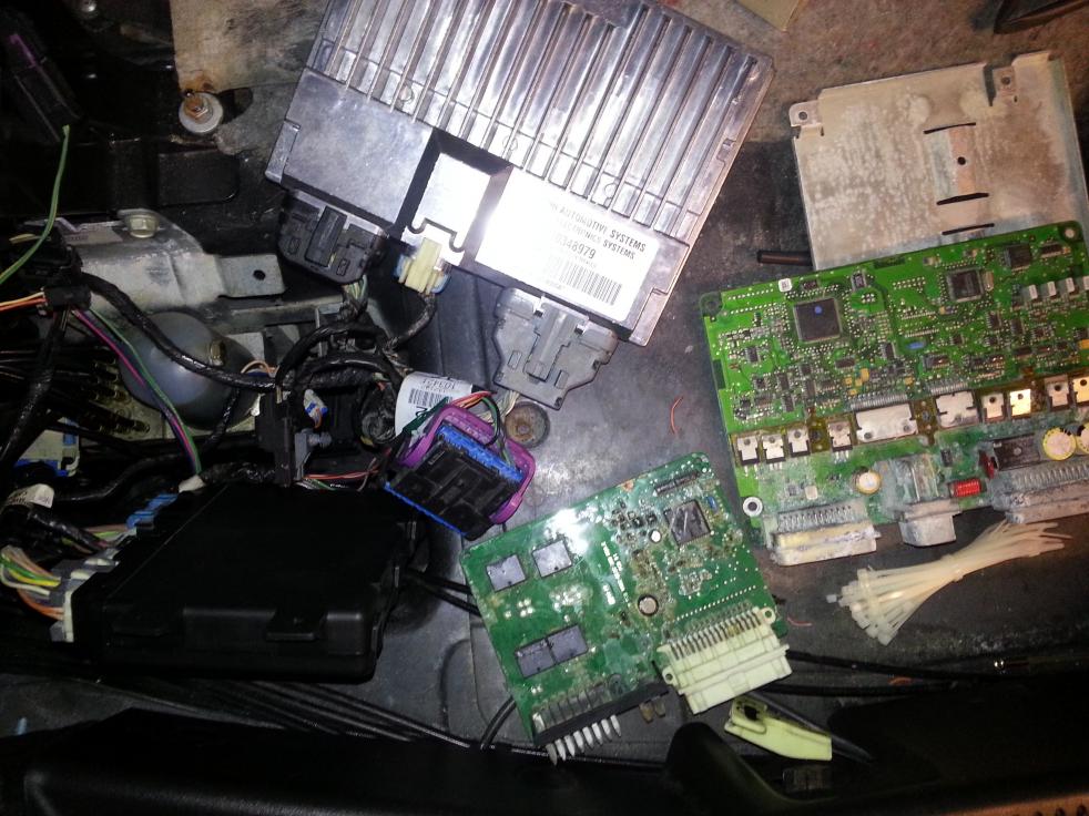

I purchase the suspension module and the top module clean all terminals fix them , connect the modules and wait 10minutes and then connected the battery ... but im having a few issues now...
Interior light on the rear view mirror never turns off.
Passenger door wont open corre tly rom out side..(sometimes it works sometimes it dont)
Driver door window stuck a the middle and only goes up 4" n down 4" after replacing the regulator with motor n module (but if i hot wire it it works perfect .up n down)
And all the ABS & T/C DONT GO MORE THAN 80MPH SERVICE RIDE CONTROL lighs in the intrument panel are still on ..
And of coarse top n trunk still not work
Now i havent driving it yet..because its raining.so i havent taking it to d dealer either .but i would like to if i can fix anything before cadillac charges me another arm and leg
pics
Left side is the new module and on rights is the old rusted modules

Did you buy the vehicle new? If not, have your run a dealer do an inquiry to find out where it was originally purchased and subsequently serviced. As a previous post mentioned, a lot of flood-damaged vehicles go to auction and end up in different parts of the country. If so, your car may have previous damage that took awhile to develop. You also mentioned a wreck, but not the damage from it.
Assess the condition of the battery and proceed from there.
The second picture above shows two uninsulated spade terminals nearly touching and another covered with what appears to be electrical tape, indicating a DIY attempt at a repair. If that's the way the car came into your possession, it may have problems built in.
Again, there is nothing wrong with your vehicle that handfulls of money won't fix.
You can buy parts all day long, but without knowing what the real underlying problems are, you're already going backwards financially. Problems like this can be solved by isolating the harness from the rest of the system and testing from there. You may be in way over your head on this one.
Let someone who's trained to repair your car properly do so and you'll be back on the road enjoying it a lot sooner. Just have it towed to a dealership. I don't expect it will be cheap, but it will be right.
You could be frying new, replacement modules and not know it if shorts remain in the system. You need the right tools, schematics, and a lot of practical experience to troubleshoot grounding and short problems. Every power and signal path must be verified point to point and checked to ground as well. This is why you pay a trained GM tech to work on cars like this.
The XLR is not much of a DIY repair vehicle. You could be causing more harm than good. Obviously, your trunk compartment has been flooded. The amount of corrosion in the pics indicates extended exposure to water . . as in submergence. Once a harness is submerged with power applied, other problems can migrate through the vehicle. If the water was salty, the aluminum will corrode a lot worse; the damage to the wiring and connectors will follow.
You'll save money in the long run by having a professional service it.
Just my .02. Good luck!
