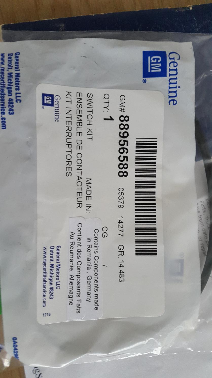

Have been waiting for so long on the rear tonneau sensor to come (ordered all 3 position sensors) and when they finally came, I got the switches, not the sensors.
It sucks living in Norway, so far from the XLR parts departments in USA!!!!!!!!!!
Same part number as the sensors?? It is described as POSITION SENSOR - With part number 88956588 on their website - but on the package that I recieved it says switch kit with the same part number (88956588).
Man, I'm frustrated!
How can I be sure I get the sensors, not the switches, next time?

Hi again.
Remi
This a picture of the sensor part number on the box when I got mine replaced
https://www.xlr-net.com/forums/cadi.../7996-rear-top-sensor-pictures.html#post56390
Here's a part number I got off an invoice from a Top Sensor replacement I had done seven years ago: 89023658. It comes up as a switch on the GM parts database.

This is the best news I've heard all day! I'm glad you have your top functioning. What was the final outcome of the part number mess?
CC :wave:
The correct part number is 19210515. The sensor can be used in all three places, the difference is just the cable clip.
