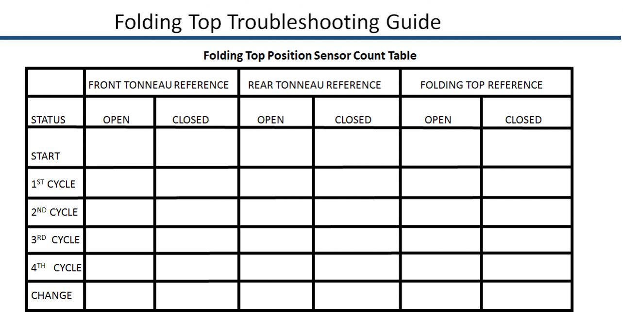

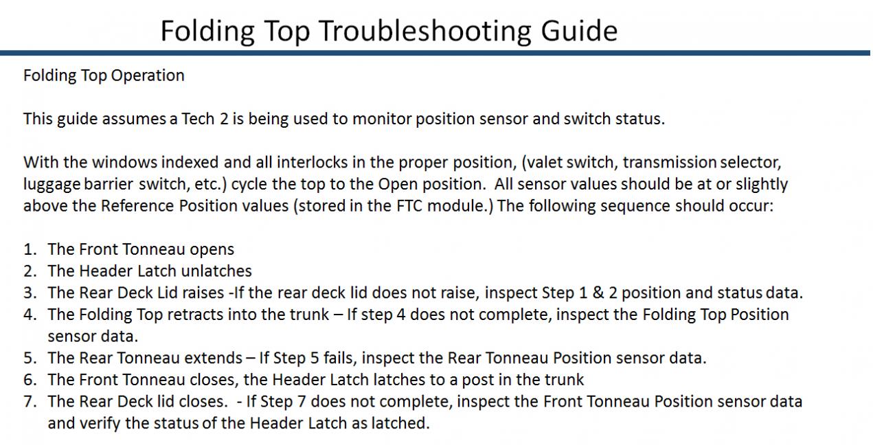

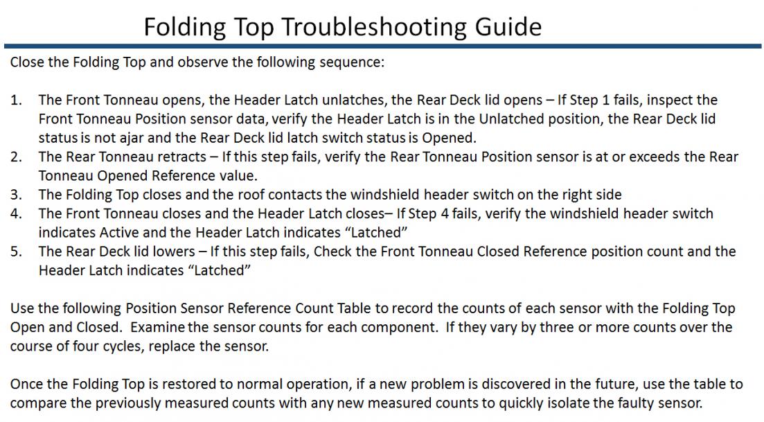

I've attached a few pages of info I threw together to help you progress. I know I've asked this before, but have you performed a re-learn procedure after installing new or swapped sensors? This is important as the FTC module will halt the process if the introduced sensors counts don't match with what it is stored in memory. When you perform a re-learn, the FTC module's memory is cleared and the new sensor counts are entered and saved during the completed open/close cycle. The enclosed table has several uses. Using it as a reference the next time you have a problem, (once this issue is resolved) will allow you to find the faulty sensor immediately by comparing values.
Once you install and successfully test a sensor, it is recommended to bond the sensor in place around the edges with epoxy, ensuring no epoxy fouls the shaft of the sensor. When a sensor loosens over time through normal wear and tear, it gives inaccurate position readings (counts) and the process may halt. It's a design flaw to only have one fastener retaining the sensor; it should have been secured against a shoulder if only one fastener was used to prevent it from rotating. Hence the epoxy.
You should be able to use either of these part numbers: 88956588 or 88956589 when ordering sensors.
