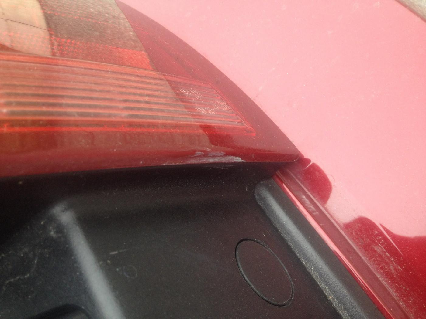

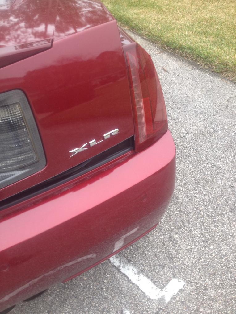

This is another eye sore for me. Is it only on the older models or is this a flaw with all of our cars image.jpg the passengers side tail light when the trunk shuts. It's scraping the edge of the light lens when it closes. Is it because it is out of alignment or is it just because it is so heavy. image.jpg
Mine doesn't hit either lens, so I'd suspect your alignment is messed up. :dunno:

Ok thanks. I guess when I head over to the dealer next, I'll have them check it out
This is another eye sore for me. Is it only on the older models or is this a flaw with all of our carsView attachment 3692 the passengers side tail light when the trunk shuts. It's scraping the edge of the light lens when it closes. Is it because it is out of alignment or is it just because it is so heavy. View attachment 3693
Mine doesn't rub on either tail light,I think your's is out of alignment.look at the left side and see if there's a wider gap than on the right? this will show it is out of alignment. it could also be the bumpers on lower outside edges of trunk, mine were all mushy and easy to replace.
I guess the cold weather here in Florida is taking a toll in this trunk align. Because today I opened it and then shut it. To me it seems to be getting further over to the right. Guess I better bring it in ASAP to the dealer. Just have lots of appointments and workers here at my house this week. So I might find time next week. Fingers crossed

so the broken sw was pulling the trunk to the right causing it to rub on the tail light? are the scratches light enough to polish out? and thanks for the follow up :cool: Al
