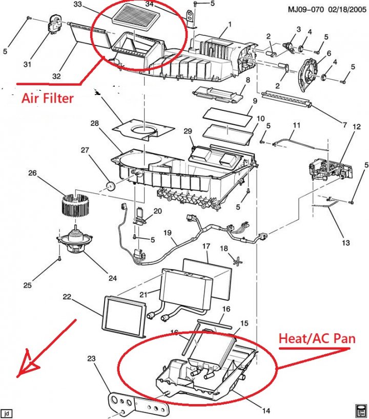

Find enclosed an explodes drawing showing the AC/Heat components, the cores are sitting in the pan number 14 on the RH side ( LH for you ) is a nozzle, that seems to be were the overflow hose is connected.
Visit an A/C repair shop of your area, it could be many thing that gets the core with ice and then turn in water, has Bill mentioned it could be only the hose that needs to be clear of debris.

Picture breakdown is helpful. A/C lines come through the firewall directly behind the middle of the engine. Very little vision of exactly where & how they exit looking from above, even with engine cover removed. When I can safely raise the car I will investigate from under the car.
In the mean time if someone can enlighten me on where the drain tube is routed & where it precisely exits it would be appreciated.

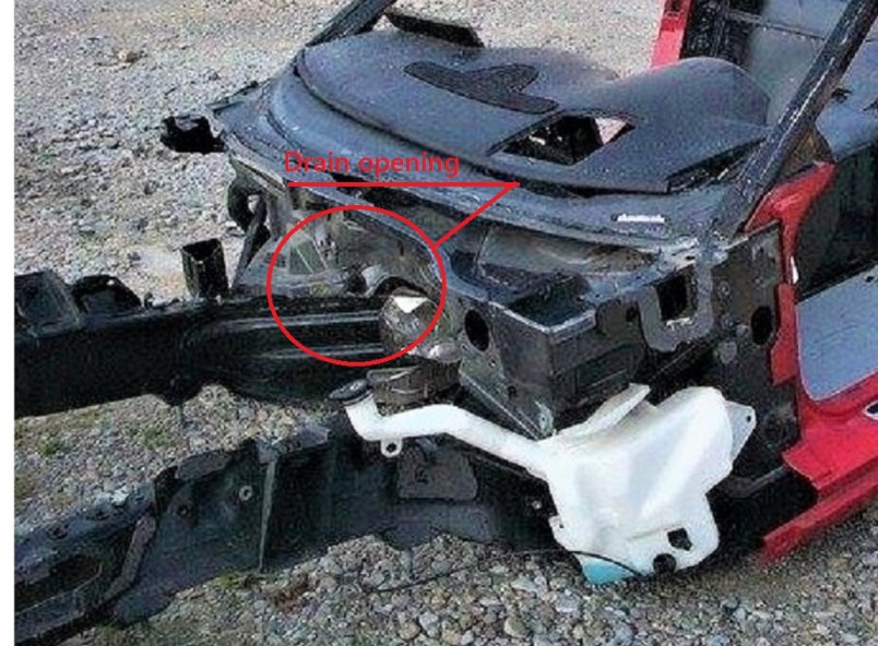

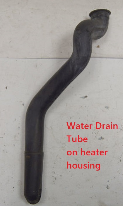

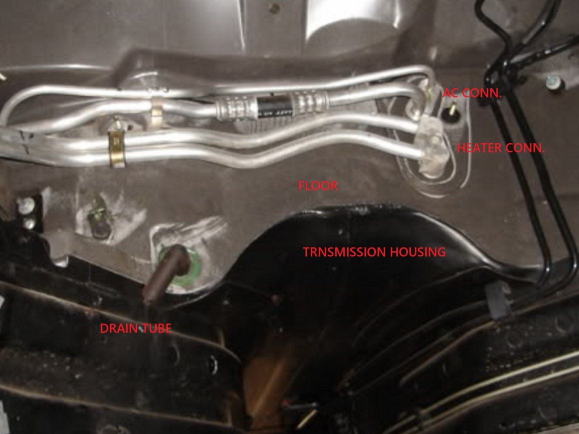

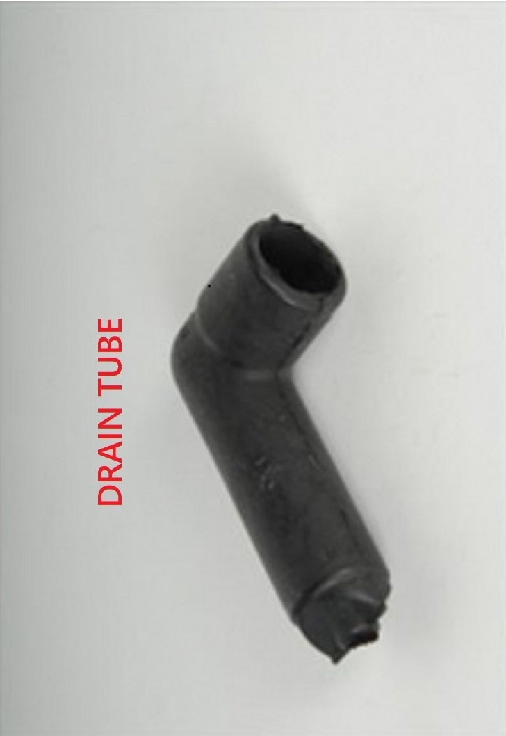

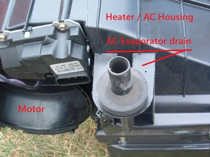

Hy
Attached a photo that indicate were you can find that tube ( hose ) also are the other photos of the drain tubes.
Good LUCK.
IAN :thumbsup

Your pictures are VERY HELPFUL!!!!!
Thanks a million...…………………………………...

From the above of the car it could be hard to see the drain, enclosed are 2 photos ( again ) to help you in identifying it.
Good luck
