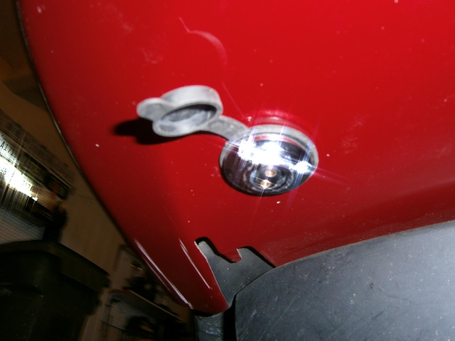

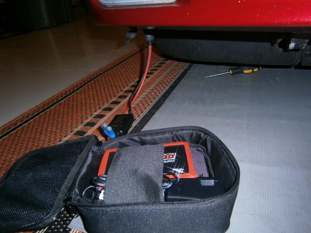

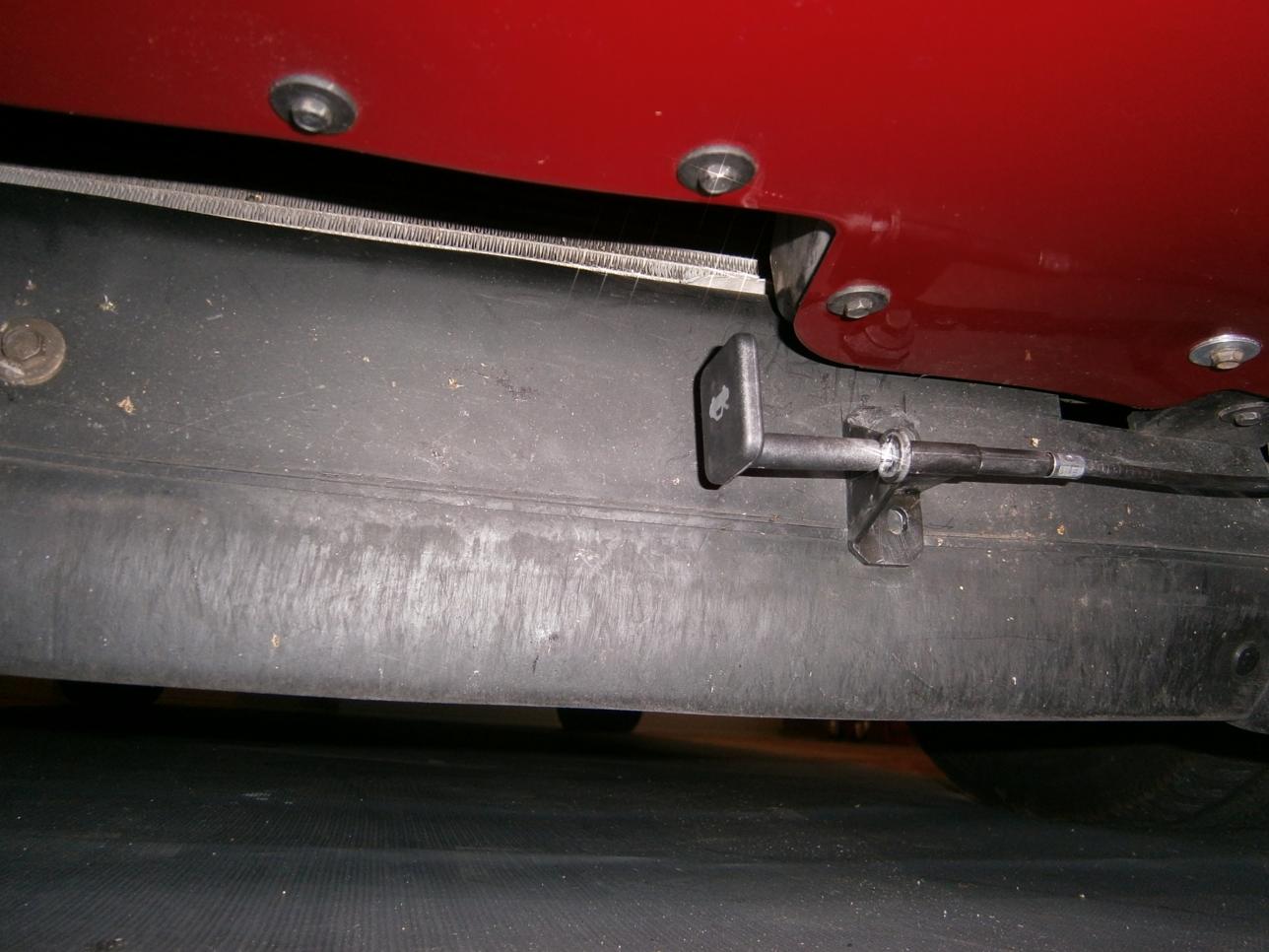

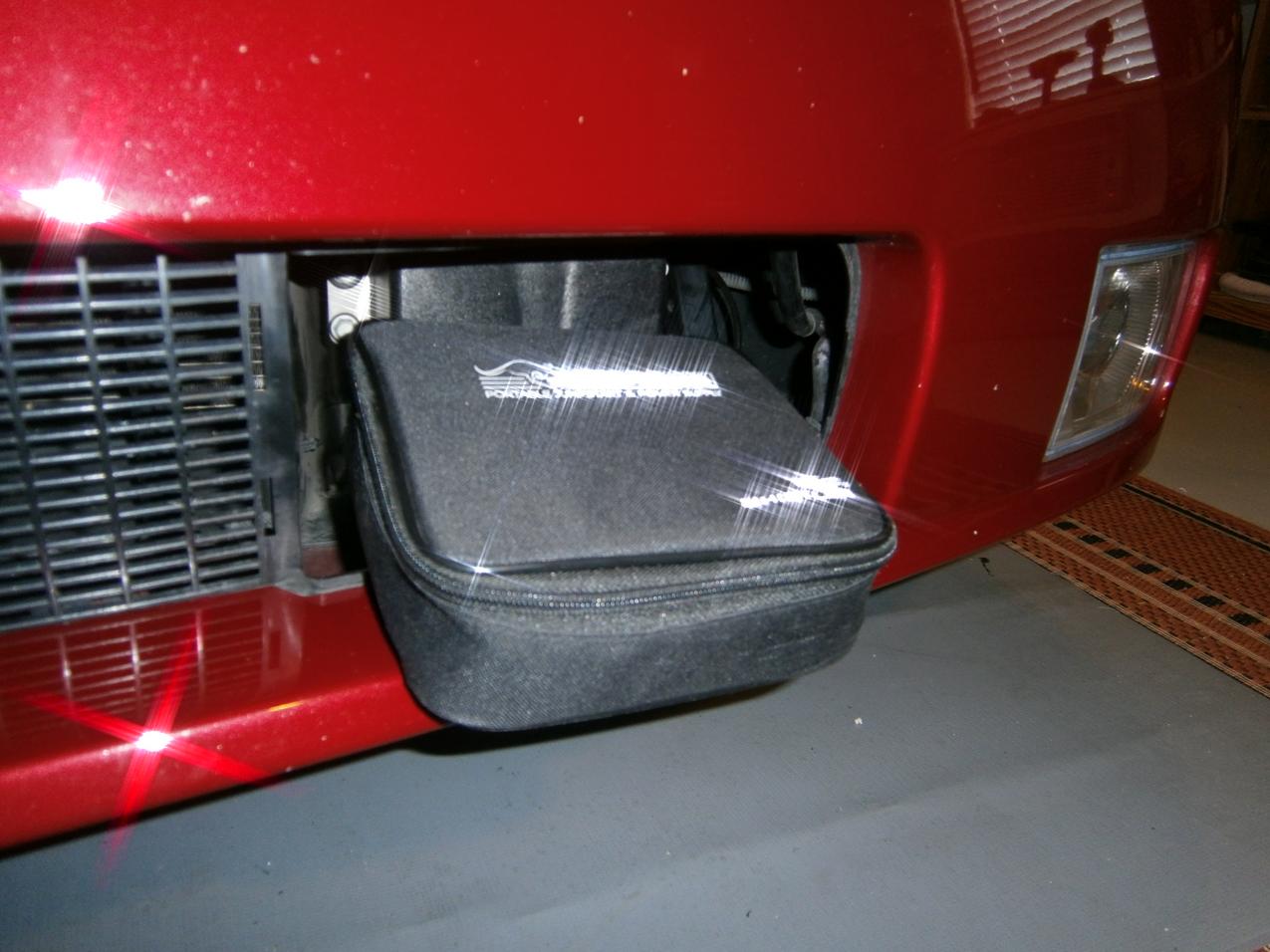

FYI I have solved that problem, installed an external hood release, an external battery plug with a whisler jump & go stored behind the left grill panel.Will try to download pics.
David J.
