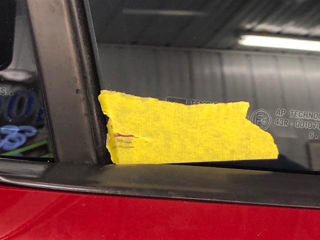

My passenger window does not drop the same distance each time. More often then not, it drops too little to clear the roof bezel. I have re-indexed it several times, and I am convinced that is not the problem. See the photos below:
The above photo shows tape placed on the window in its fully-up position. Spoiler alert, the three lines show the three different levels to which it drops with the purple one being the only one that clears the roof.
