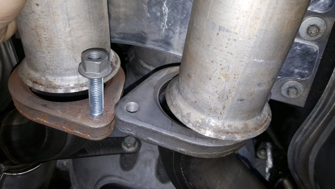

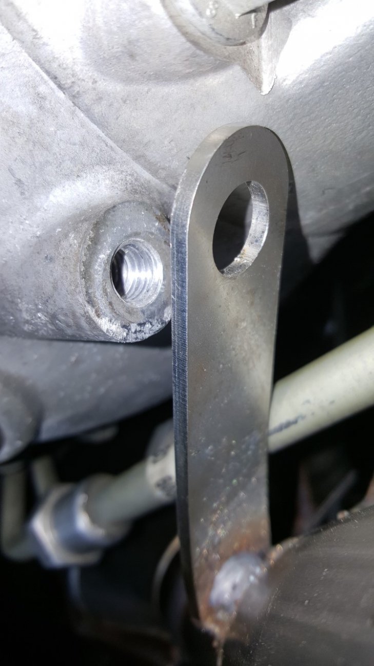

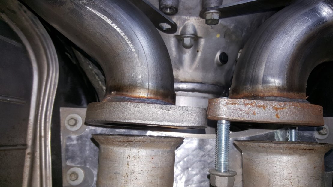

Stick with the stock manifold. Magnaflow has terrible customer service, and they don't have a CLUE about what they sell for the XLR. It's hard to get the manifold off, but not impossible. The manifolds I got from them came with bolts that wouldn't even go through the holes in the manifold, let alone fit the head bolt holes. All they have told me is to return them (after spending months with them telling me it fits, and if it doesn't something is wrong with my car) or pay MORE money to have them modified to fit (which they pretty much suggested from the start, which tells me they 100% know they don't fit some XLRs).

Here's a couple pictures showing how far off the fit is.

finally got my magnaflow manifolds and corsa exhaust installed and it is magnificent. Looks and sounds just like I thought it would. Manifolds fit perfectly on my installation, although very tight to work in there. Exhaust bolted up quickly and was off to the races. Perfect combo of nice highway rumble and the loud sound of power when you fell the need to let it fly.
I was pretty sure they would fit late 2006 and after. The right manifolds are different part numbers from 2006 on from GM.
