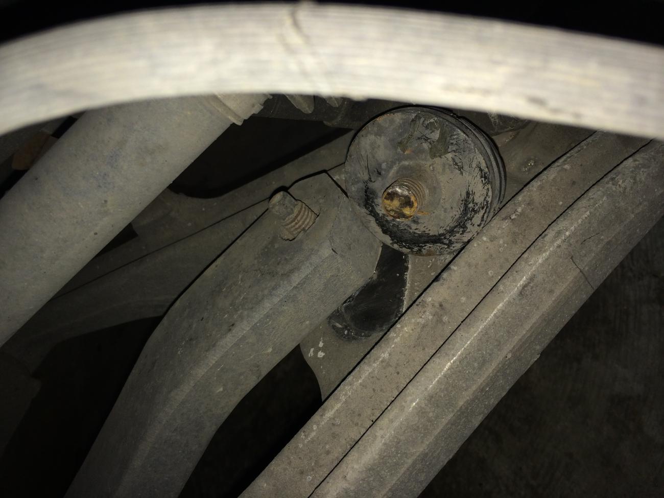

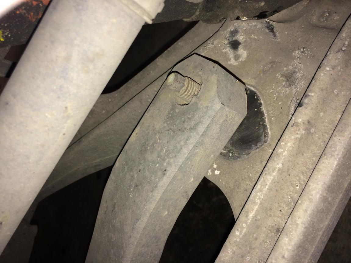

I went and saw the car up on the lift at the dealership.
Basically, item # 15 in this diagram has completely warn away on the left rear (it has a 3" round pad that presses on the spring):
[FONT=Verdana, Tahoma, Calibri, Geneva, sans-serif]Suspension Subframe Crossmember/Shocks and Struts for 2005 Cadillac XLR
[/FONT]
However, the dealership is stating the entire rear spring has to be replaced because they cannot replace just that 1 part.
[/FONT]
There is no visible damage to the leaf spring. But again, they claim there is no way to just replace the part that is missing.
[FONT=Verdana, Tahoma, Calibri, Geneva, sans-serif]They have stated that I need to replace the right rear control arm due to a design change (I guess GM realized this part needed to be re-designed due to issues?), and that the load may not be even if I just change the left control arm.
I'm tempted to just take some sort of durable gasket doughnut and just shove it there to see if it fixes the $1500 problem.

I researched C5 corvette rear suspension parts and the control arms have the same part numbers. The leaf spring looks the same, but has several different part numbers for suspension options. (FE 1, FE 2.) The upgraded lower control arm has a redesigned ball joint, so I understand why they need to be replaced as a pair.
This still begs the question: Did you see any damage that warrants replacement of the lower control arm? With your dealer's demonstrated knack for throwing parts at your car. . .
You may be in luck indeed:
I Googled "C6 Corvette Rear Transverse Spring Pads" and there appear to be aftermarket pads available. A drive to a corvette shop should reward you with a knowledgeable answer for obtaining a premium part at a cost much lower than an entire spring assembly.
There is no way I would continue to drive a car that bottoms out for any length of time; the risk of causing more damage, and incurring even more expensive repairs is too great. PS: Here's a better explanation of how the rear suspension leaf springs work than I could ever make up: Corvette leaf spring - Wikipedia, the free encyclopedia
CC :wave:
One of the Corvette places called me back, and they said that this a fairly common problem for C5 and C6 Vettes.
In the old design- the rubber sits flat; the factory didn't install lubrication when they installed it- so the dry rubber against the dry aluminum causes wearing.
The revised version moves the angle of the pad so that it doesn't bite so hard.

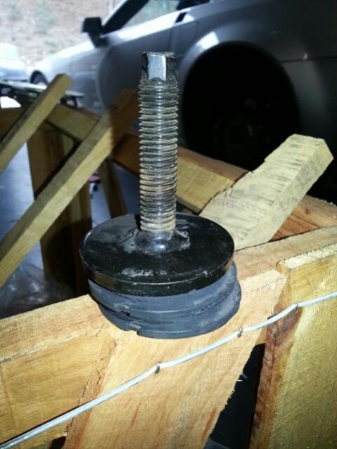

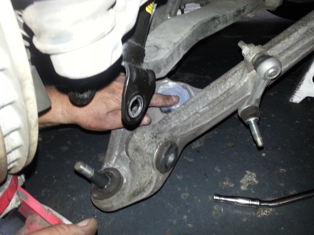

This is a relatively simple, cheap fix. The stealership is trying to gouge you again. There are aftermarket "trim height adjustment bolts" designed for corvettes that will solve your problem. You can get a pair - though you only need one - for $50. This bolts right into the leaf spring. You will likely need a longer bolt though, than what is normal for corvettes. So you are really buying the aftermarket pad, then swapping in a matching but longer bolt - an extra 2" or so should be good. You will have to separate the lower control arm from the knuckle/spindle to create enough space to remove the adjustment bolt. The bolts are typically quite stubborn, a high quality 10mm socket w/ 3/8" drive is recommended due to the torque necessary - 1/4" drive will likely snap. It well help to soak the bolt in penetrating oil overnight as well. I use a 50/50 mix of acetone and "marvel mystery oil" for stuck bolts - which is what I did when I had the same problem. I highly doubt your control arm is damaged enough to warrant replacement. Most likely just a few knicks from the damaged bolt - but inspect it yourself - don't believe what the stealership tells you - they lie, cheat, and steal for a living :mad: (independent mechanics are more likely to be honest - but this is not given either).
Here's a couple pics of what I had - the bolt had snapped, not just pad fell off - control arm was fine, but I only drove a few blocks like this, b/c I knew something was wrong right away.
When it's all back together check that your ride height is level side side to side, you turn the bolt to adjust the height - hence the name. I can provide much more guidance to perform the repair if you want to do it yourself and need help. Parts cost should not be more $60. A fair price from a vette shop for this repair would be $120-$150 - 1.5 labor hours max.
View attachment 4759 View attachment 4760
here's the control arm.....applying lubrication is the key to stopping the friction which caused the pad to fall off in the first placecontrol arm.jpg

They replaced part # 15 in the diagram I previously posted (a $10 part they had sitting around), which the dealership said was impossible to replace.
There was some very very minor rubbing on the driver's side control arm, but he was able to buff it out....as good as new.
They also had me sit in the car to take measurements, and adjusted the trim height adjustment bolts to get it perfectly even from driver to passenger sides.
He said that I should have NEVER replaced the rear shocks- had nothing to do with issue.
What's interesting is that he told me there a a kit from Casper electronics for $300 that allows you to swap out the Magnetic ride control shocks. So you can buy 4 high performance regular shocks for $500 instead of $600-$1000 PER OEM magnetic ride control shock. Lots of Corvette owners have done this. I know a lot of folks on this board go on and on about how awesome the magnetic ride control shocks are- but I honestly can't tell the difference compared to regular shocks on other cars I've owned (Miata, S2000, Accord). It's mostly just marketing hype- and dealers LOVE all the profit they make replacing them.
I'm tempted to file a Better Business Bureau complaint about Marvin K Brown for all the crap they pulled. Probably not worth the time and effort.
At least now I'm glad I've found a reputable shop that I trust. My car just turned 90k- so going to have them do the transmission flush, change the rear diff fluid, etc. They are going to get ALL OF MY BUSINESS from now on. And I'm happy that I don't have to go new car shopping....I really do love my XLR, especially now that everything is fixed correctly. :thumbsup
So a lesson to everyone ...if your dealership claims you need expensive repairs- take it to independent Corvette shop for a 2nd opinion!
