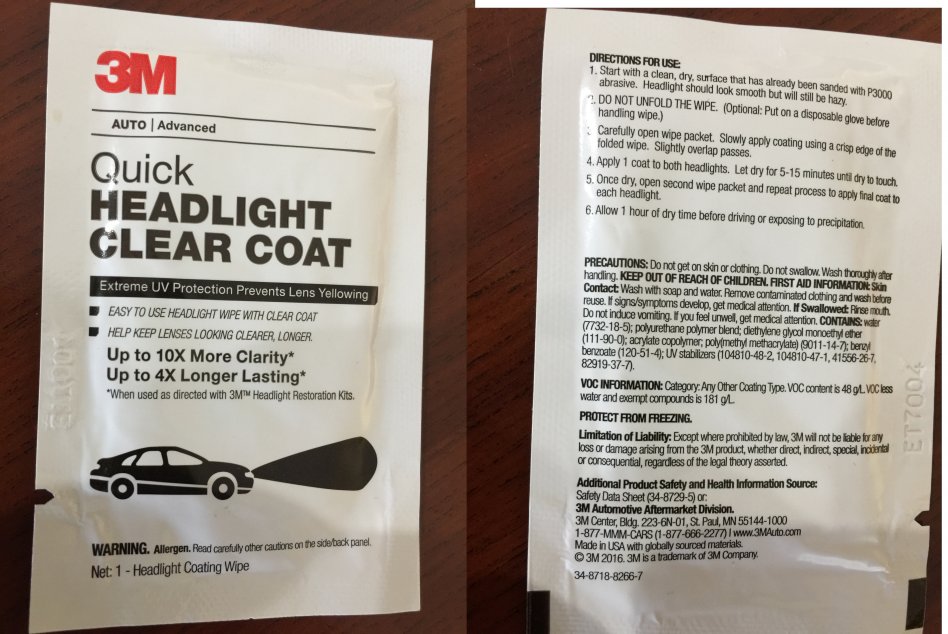

I ran across this 3M Headlight clear coat protectant the other day. I tried it and it works really good, lightens up some hazing and cracking and gives it a UV protectant to stop the crazing of the headlight lens. I am going to do my tail lights too. The P3000 abrasive they talk about in the instructions is just a 3000 grit sandpaper.

Where can it be purchased???

Why No Before & After Pics ?

come back in 4 months with photos pleas, that "4x" means instead of one month it may last 4 months before turning yellow as butter.
