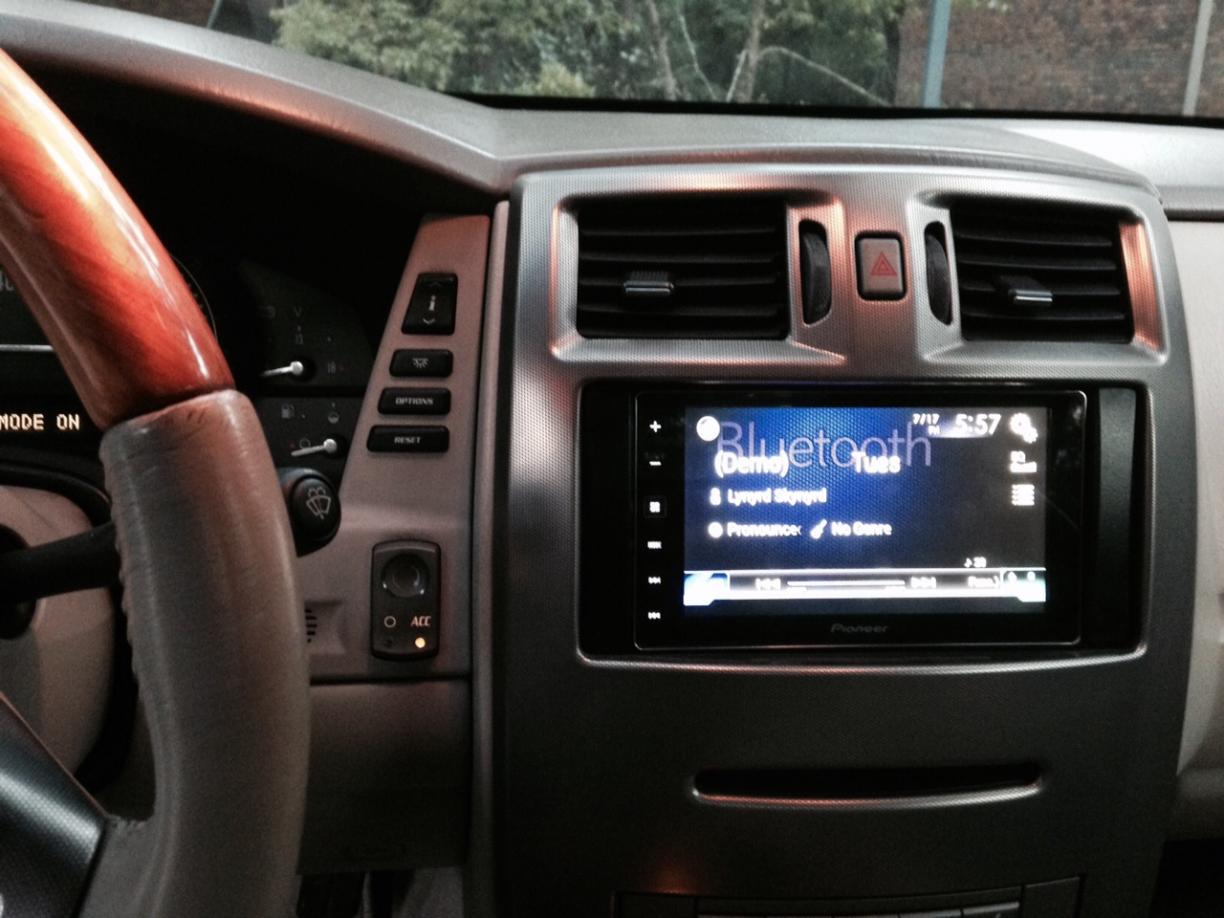

Some of you commented on my introductory post where I stated I intended to install an aftermarket stereo. I am happy to report I have completed the AppRadio 4 install and it looks good, but more importantly sounds incredible. It is full touchscreen with Apple CarPlay. I can easily place and receive handsfree phone calls, send and receive text messages, use navigation, and listen to my Pandora stations. One of the reasons I purchased this specific unit, is the ability to integrate DashCommand onto the screen via bluetooth ODBii transmitter. While I have gotten the scanner to work and am able to monitor the performance and engine metrics on my phone, I have yet to discover how to get it to display on the AppRadio. I will spend some additional time with it this weekend. I am enjoying the Siri integration and feel like I have updated this wonderful car to the conveniences of a modern voice controlled system available on most any new car.
As a side note, I retained all my steering wheel controls functionality and it does not affect the ability for the adaptive cruise control nor On-Star to function as intended. There does not appear to be any adverse effects of this installation, and the acoustics sound amazing. One should note, while the AppRadio is only $400, by the time one purchases the installation kits, CAN Bus modules, and harnesses, it is a little over $600 worth of gear and several hours of time to install...but TOTALLY worth it.

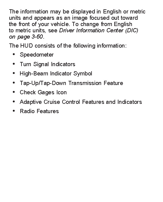

Does the HUD still work? What is displayed where the OEM head unit info was displayed? Does XM still have all it's functions?
View attachment 5450View attachment 5451View attachment 5452

As far as the HUD, there is nothing in the display except MPH, Adaptive Cruise details, and blinker display. This XLR already had an aftermarket Pioneer double-din installed so I am not sure what is missing. Likewise with the XM. The new Radio has that functionality built in, so not something to integrate with the vehicle systems.

2. Apparently all I am missing on the HUD are the radio functions, because I have seen all the others

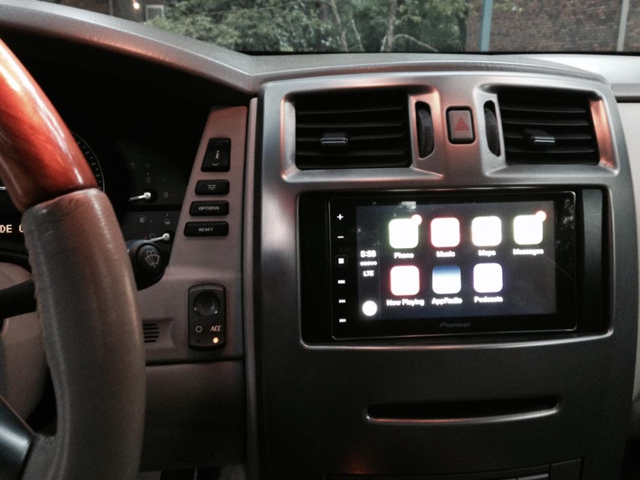

3. The AppRadio part functions via Bluetooth flawlessly, but if you want to use Apple CarPlay you must hook up via USB. I will explain more in the review.

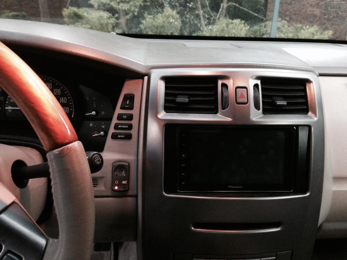

Ok...finally home and have a few minutes to write down my initial thoughts.
First a few pics of the final install with the new dash:
View attachment 5484View attachment 5485View attachment 5486

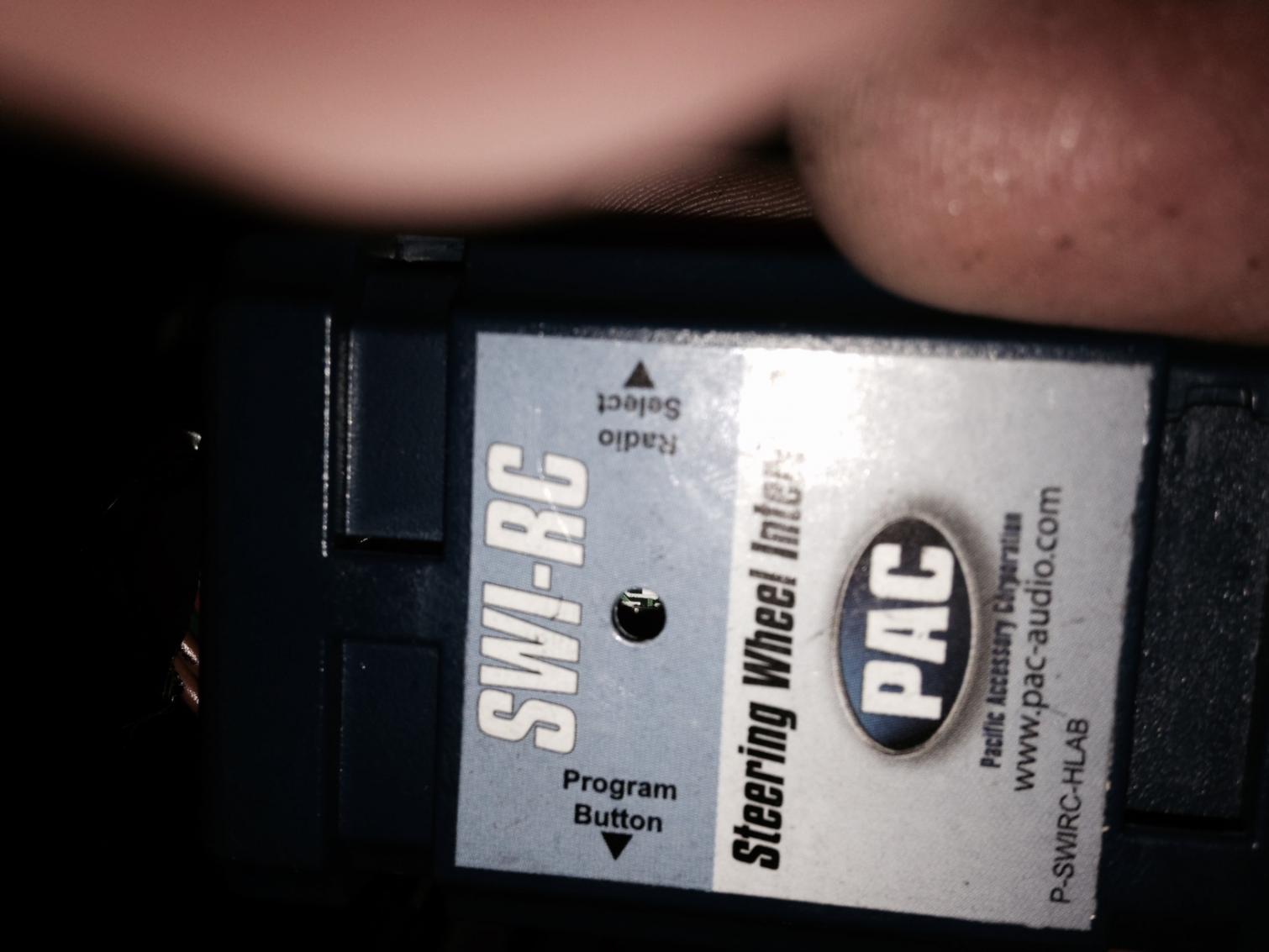

Now for the disclaimer. The below pics of the module that currently function flawlessly integrated into this XLR were not installed by me. The original install was poorly executed, but it was working so I did not redo it. These are the ones installed by the previous owner so I do not have any instructions on the settings and integration programming other than they work. However, I do have the additional Scoshe module information for the units I purchased prior to driving the car...with the expectations of replacing what was currently in the dash. I prefer Scoshe as a brand to PAC, but that is a personal preference after having performed more installs than I care to remember.
Now for my thoughts on the AppRadio 4.
The integration with Siri makes the other minor frustrations tolerable. If you use an iPhone, you know what I mean. With the handsfree ability to send txts, place and receive calls, and navigate, I am quite productive on my daily commute to and from the office. Sound quality is great and the party on the other end has no issues hearing me as long as the top is up or I am going slow with the top down.
Connectivity to the phone:
There are three very distinct ways to connect a phone to the AppRadio...which leads to the minor frustrations mentioned above.
1. Bluetooth wirelessly:
Pros: Connects immediately upon power-on and I can use any source on my phone to play audio. This includes Pandora, voicemail, and audio books in my iTunes.
Cons: no video, no CarPlay and no charging of my phone
2. USB cable into the USB into the rear of the AppRadio:
I keep this cable in the center console and it is not inconvenient to plug-in
Pros: Charges my phone, CarPlay is fully functional immediately upon connection, and integrates Siri into my vehicle
Cons: Kinda clunky leaving the CarPlay app and starting Pandora through the AppRadio interface and then coming back into CarPlay for navigation etc. Limited number of Apple only apps.
3: HDMI cable into the HDMI into the rear of the AppRadio
I also keep this cable in the center console and it is not too inconvenient to plug-in, but more difficult than the usb because of the HDMI adapter
Pros: YouTube, Videos, Plex, and screen Mirroring for applications like DashCommand. Nice integration into the other AppRadio features
Cons: No Siri
Conclusions:
If you do not have an iPhone, this radio is a great extension of your android smart phone. If you do have an iPhone, having Siri in your car is AWESOME. If you don't have a smart phone, well, this radio sux. The sound quality through the Bose is really great, the steering wheel controls function flawlessly, and it does not impact the Cruise Control or other XLR features. I am quite happy with this purchase and the install...but I am a techie too. :cool:

These are the ones currently in the XLR, but since I did not install them, I cannot speculate on the configurations. With the Scoshe modules I have a direct dealer help line.
GMOS-06 GMOS-06 [GMOS-06] Axxess Integrate, Comprehensive Interface Products
PAC TR7 Pac-Audio.com Product Details | iPod Integration for your car and More by Pac-Audio - Connecting you to the future
PAC SWI-RC Pac-Audio.com Product Details | iPod Integration for your car and More by Pac-Audio - Connecting you to the future
