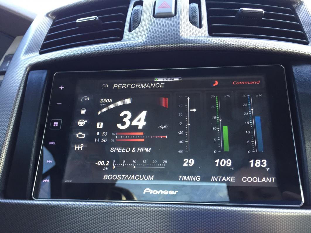

For those of you wondering, below is a quick shot from this morning on our way to Cars and Coffee with the ODBCii connected and running the DashCOmmand on the AppRadio. I think it's totally cool :D
