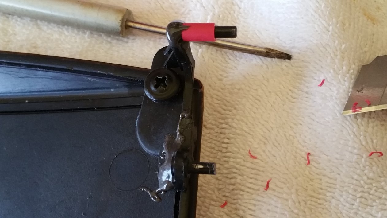

The X is going to the shop tomorrow for the broken shift linkage but thought I'd putter around with the broken console cover hoping I'd figure out how to repair it instead of springing for a replacement console. Anyway, first off was to remove the shift knob and console plate. You have to remove the power supplies which are all quick connect and I was taking the lid/console inside to my work bench. Here's a picture of the rear console cover with pins that have not broken off.

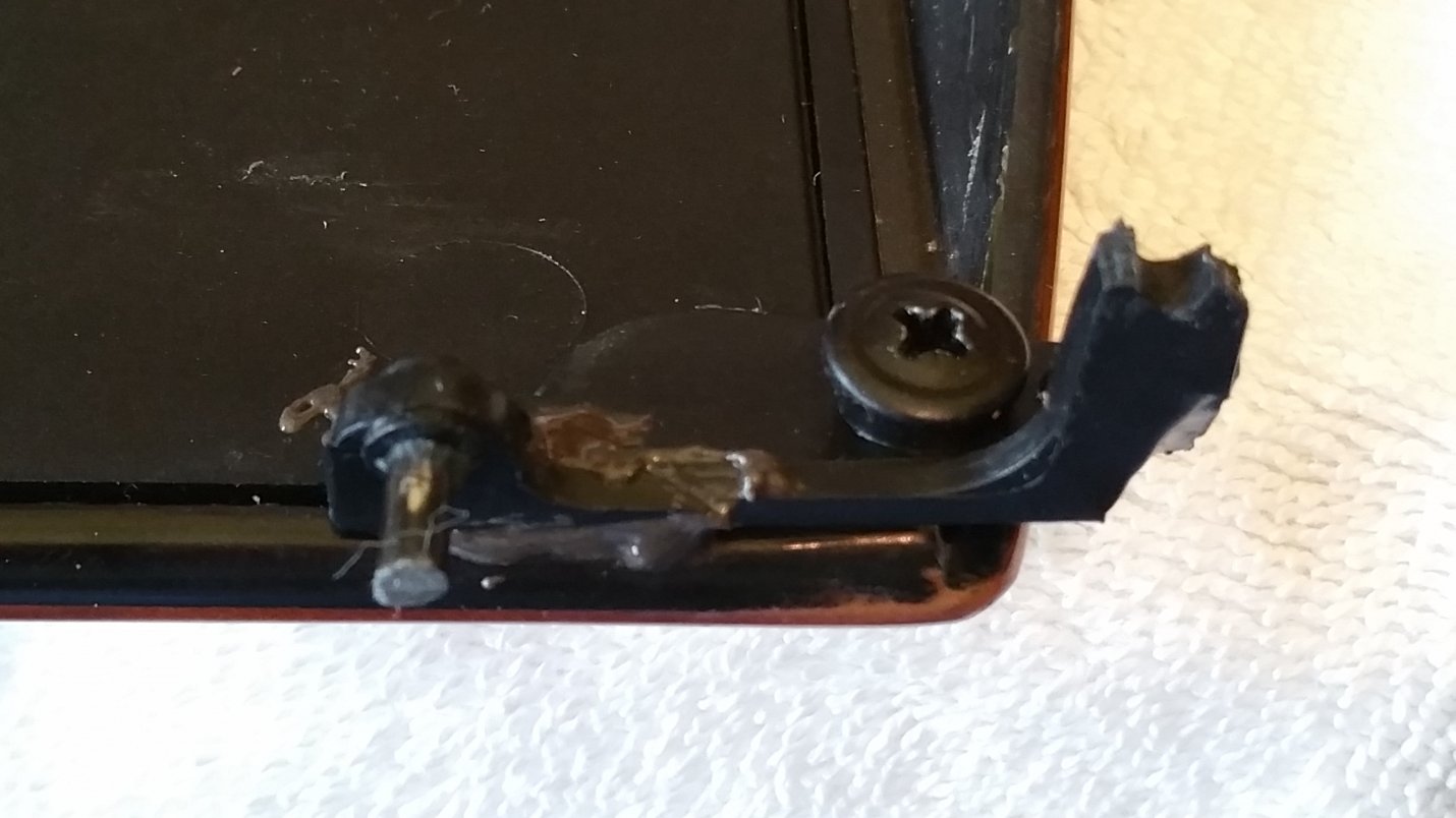

Here's the pic of the broken end. I've already used JB Weld to reattach the smaller guide pin. I found almost all the broken pieces once I removed the cup holder and console plate.

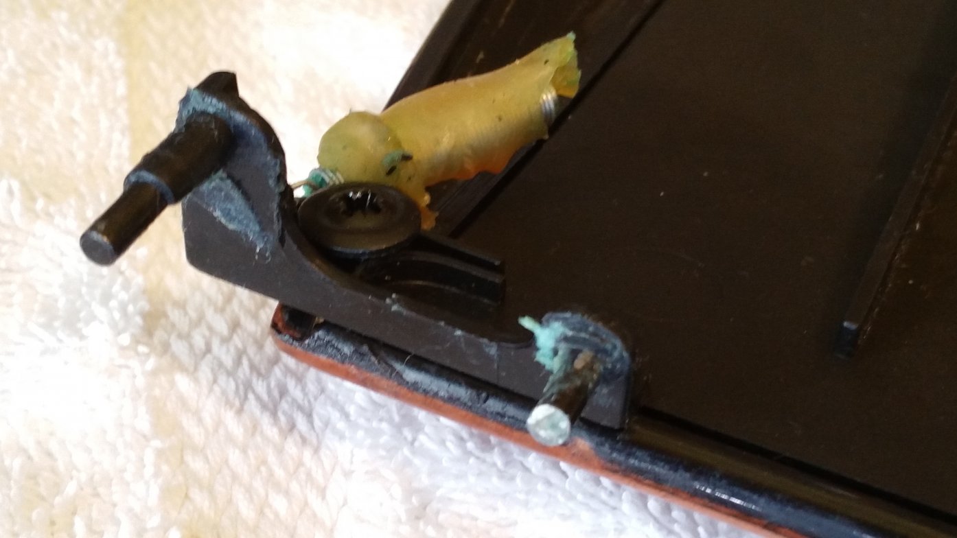

Here's a pic showing both pins reattached with JB Weld. I'll be letting this stuff cure overnight before attempting to put all back together.
After a few minor setbacks I've got the console back together and all is working as it should. The soft close and open works and after a few shims it's even with the fixed wood plate on the shifter side. I had to make new screw bolsters on the outside edge as the old ones were completely broken off.

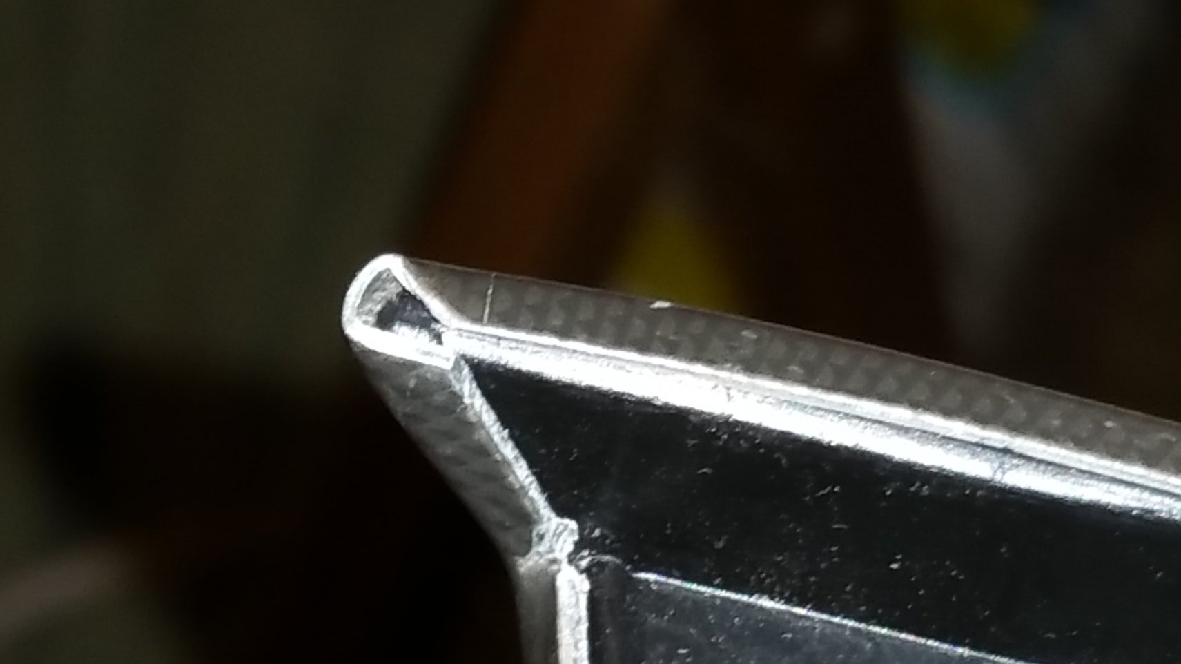

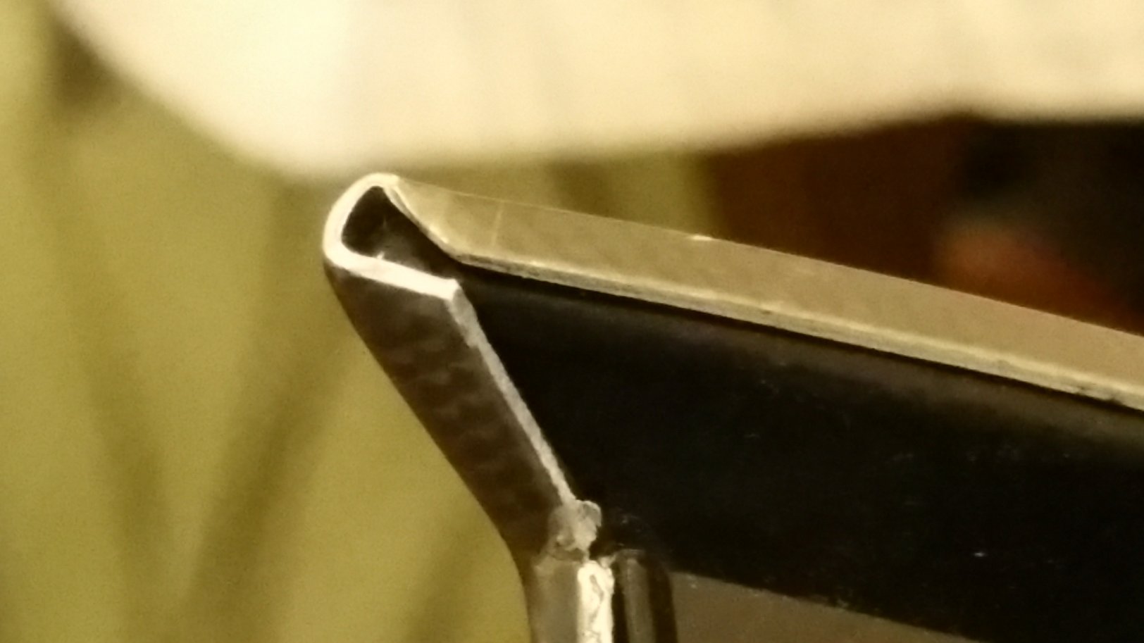

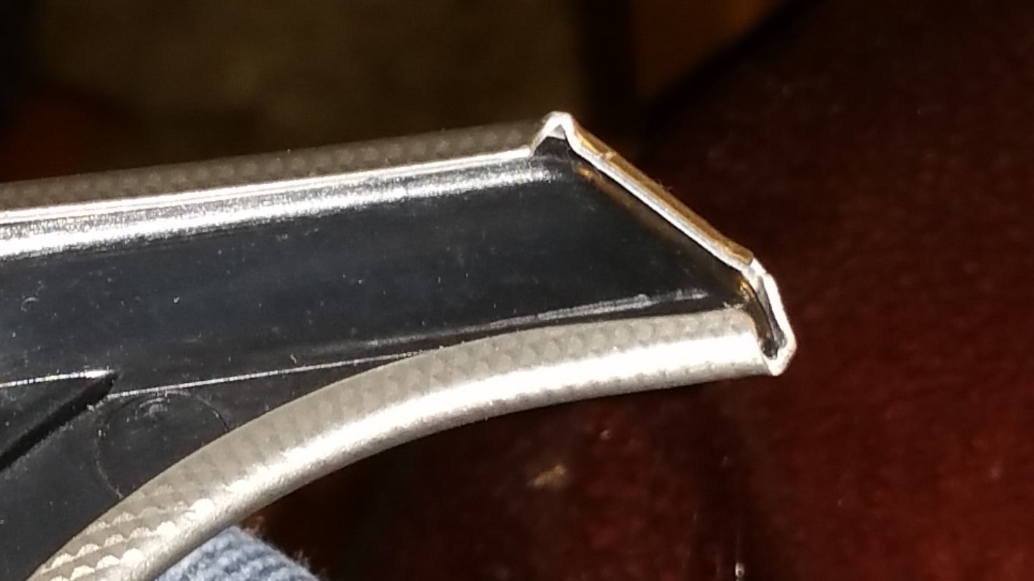

My eBay console cover came in yesterday, not in bad shape at all, but some small scratches on the aluminum trim that I didn't care about as I'm still using my original cover. The cup holder part is perfect condition and lid had some very light scratches that I've already buffed out. Forget about disassembling the aluminum skin from the plastic frame. I've attached some pictures of what it looks like underneath. The stuff is virtually crimped on and any attempt to remove it will be FUBAR. And there's no way to access the skin from
the back side unless you grind out the plastic underneath first.
