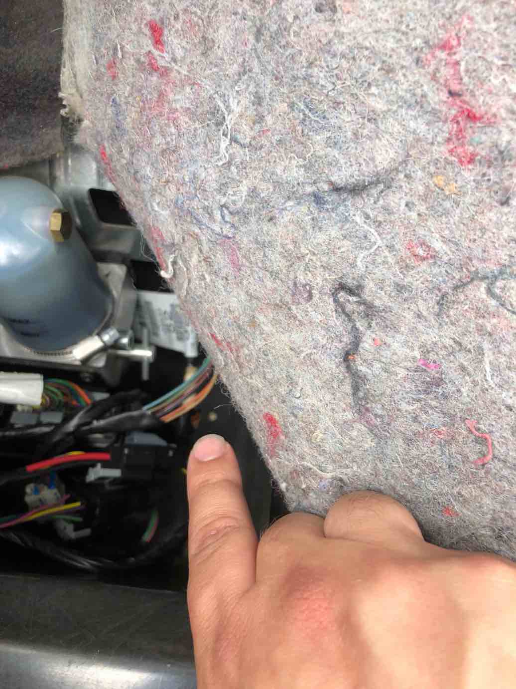

Just incase anyone hasn’t checked this, I’ve read that this little drain hole gets clogged with leaves and I had some in mine. Hard to reach so I used a leaf blower to clean it out. Worked well! Has anyone thought to make the hole bigger just in case?
yes enlarge hole.
can add an extra hole while you are under there, i did other corner.
can also add 2 holes to passenger side compartment.
do it from underneath with a drill.
while we are on this topic, 'doe anyone else notic that the cove panel that goes on top of the compartment doesnt lay flush?
it kind of is bumped up a bit by the reservoir ?
mine is that way.
and in the pics in this thread it looks to be the same ?
