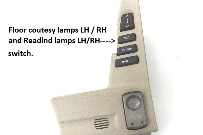

HI Steeve.
The switch '' ON and OFF '' on the dash RH side is for all interior lamps…...the floor courtoisy lamps ( LH &RH ) and the reading lamps on the mirror LH& RH, if the reading reading lamps are ON then when the doors are closed, the reading lamps will stay ON.
On the mirror, just close to the reading lamps lens are a pushon switche for each reading lamp, if they are OFF they will shut down OFF when closing the door, if they are ON…. it will stay on for 20 minutes.
When closing the doors the lights should comes OFF after 10 seconds, and when the theft system is on it will comes OFF after 20 seconds.

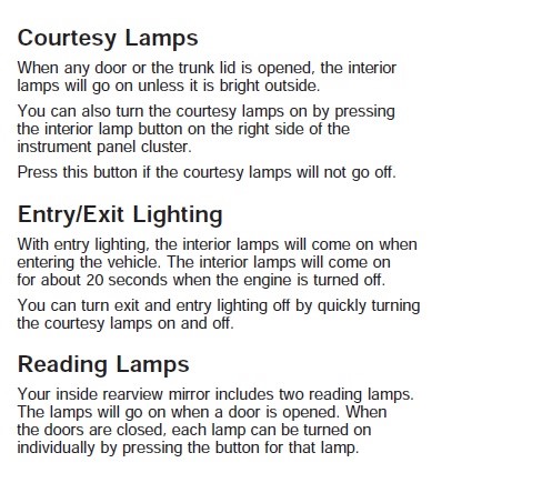

In searching in my owner book for other informations, i found the following on the section 3 and the paragraph 33, in the own words of GM for the interior lamps.
