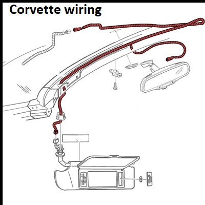

The following photos worth more then thousands of words, if you decide to go forward and if you have the ability to execute the work.

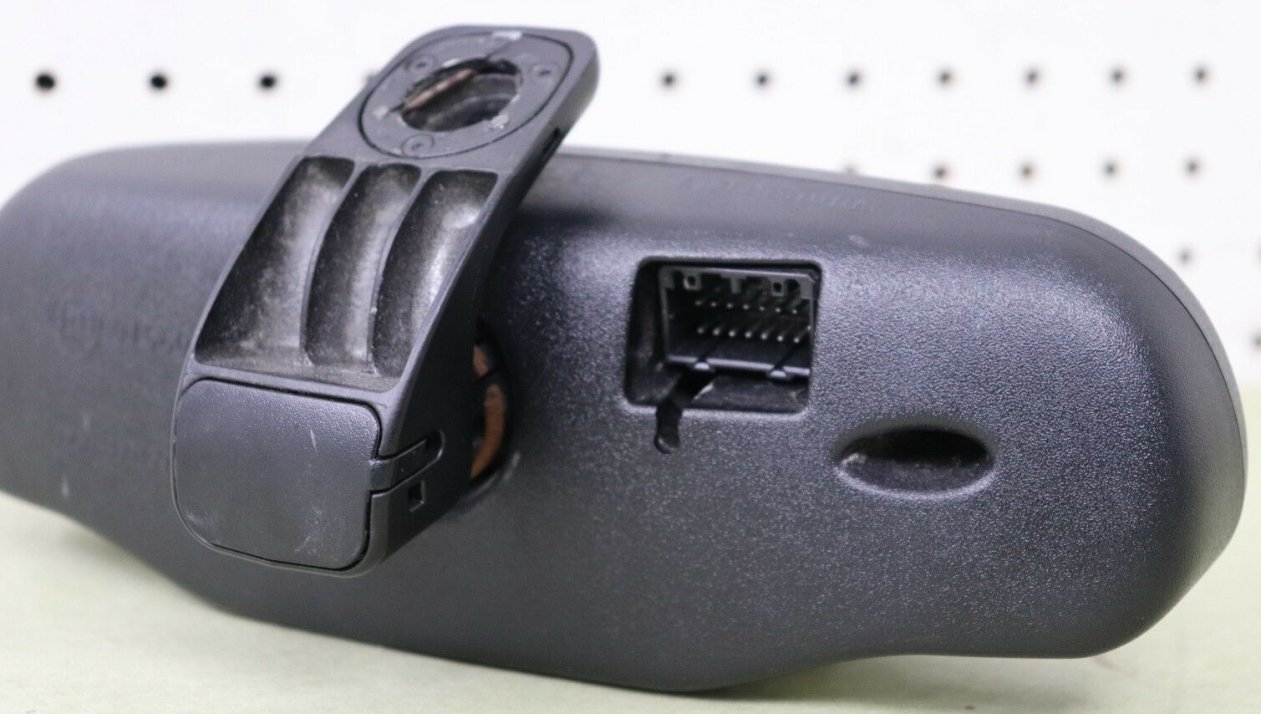

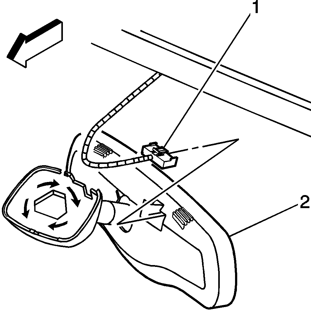

Included is the wiring of a Corvette similar to the XLR, the front view of the mirror showing were the connector fits in ( the opening on the LH is the majic eyes for the headlights control ) and also from my workshop manual is a photo that shows how to remove the rear interior mirror.

The mirror head is hold by small metal tubings with pressure inside of the socket portion of mirror head.
As the drawing shows the narrows indicate a movement clockwise is needs to release it and then there is only a way to go off would be down way with a reasonable hands pressures.
The pressure metal tubing will go backward and off the round head of the bracket, hold on windshield frame, that safety feature is made for in case of an accident occur and of an impact of the inside passengers body.
As far is for the connector, it should come out by releasing the small plastic retainer with a small screw driver with reasonable pull away with your hands.
As far is that the mirror would not been flush with the windshield , it could be that the mirror head is not entirely in place and is hold partly by pressure metal small tubing.

Next remove the connector and then the mirror arm by pushing it inward and turn it clockwise…. you will feel the release of the mirror when it will come out from its support.

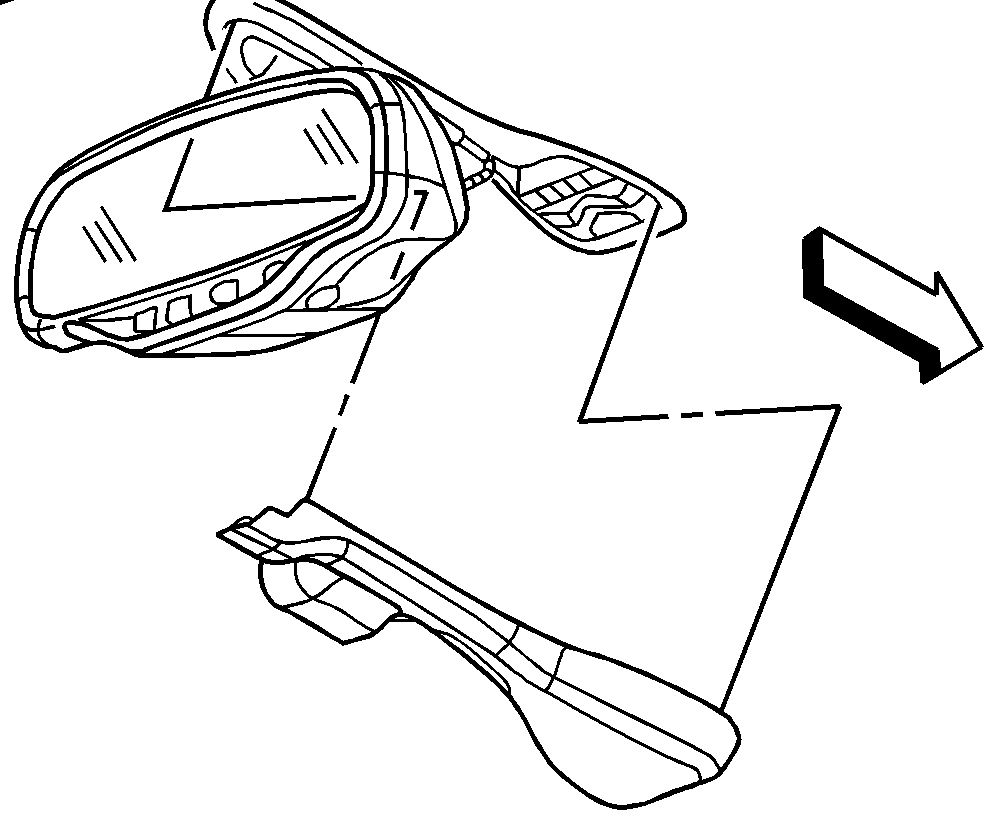

Enclose is a drawing that shows how to remove the cover.
Hope this will finally help.

Ian, Thank you for all of your kind help! Question: "This picture of the plastic cover that is on the wind shield,behind the mirror, shows the larger part of it is on the bottom, towards the dash; The cover on mine is the reverse -Larger part is at the top of the wind shield, is this because the picture you sent is of a Corvette part??"
Steve.
That is unusual, about photos of it to determine the whys and how, the drawing send to you is for the XLR.
