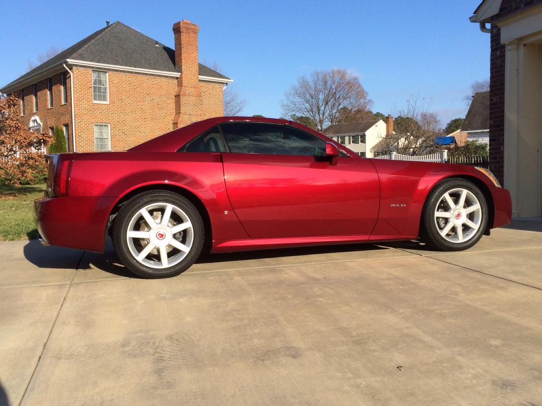

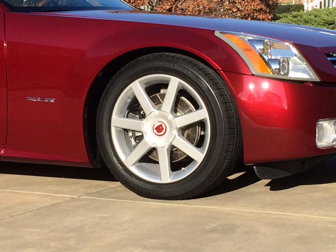

The result of my "Overhaulin" & early Christmas for me!
I am a conservative, "keep it OEM all the way" kind of girl. But my OEM alloy wheels were trashed, & Beauty has enough blemishes from her daily driver days that she's never going to be a show queen, so I decided to have them sand blasted & painted hyper silver. HOWEVER, Mike got in the middle of it & approved a "surprise" add-on. Turns out it was having the crest & wreath in the center cap painted infrared to match the car. I was really not too sure about it when I saw it on the car in the garage, but today I got it out in the sun & LOVE it! Not really anything dramatic, but still a nice little touch. Plus the wheels overall turned out great (shop put in extra effort to make the finish perfect when they saw how clean & shiny I keep her inside & out), & I agree with Mike that I wish I'd done this long ago.
Maybe doesn't quite fit in with Madcurl's thread, & YMMV on whether you like it, but here it is:

Thanks! I checked on other options & there weren't any (other than buying new wheels) because the alloy was popping off, and once that started happening there was no way to "re-alloy" them. I also had a curb-rashed wheel, & they said you can't repair that on an alloy wheel. Chroming was not recommended because of the salt/sea air here which makes chrome last about 5 years before it starts pitting.
The paint job is warranted for life & easily fixable if there's damage. It's actually better than powder coating too, since there's more color variety available & powder coated wheels also can't be repaired if there are scratches, chips, etc.
