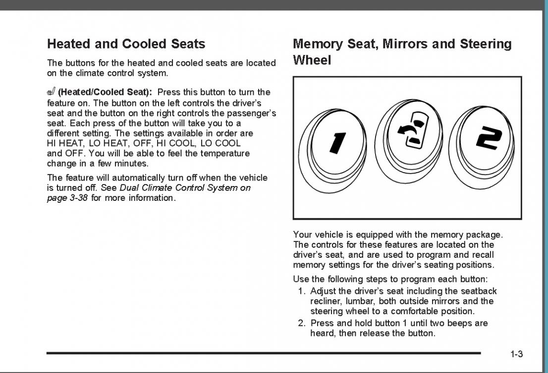

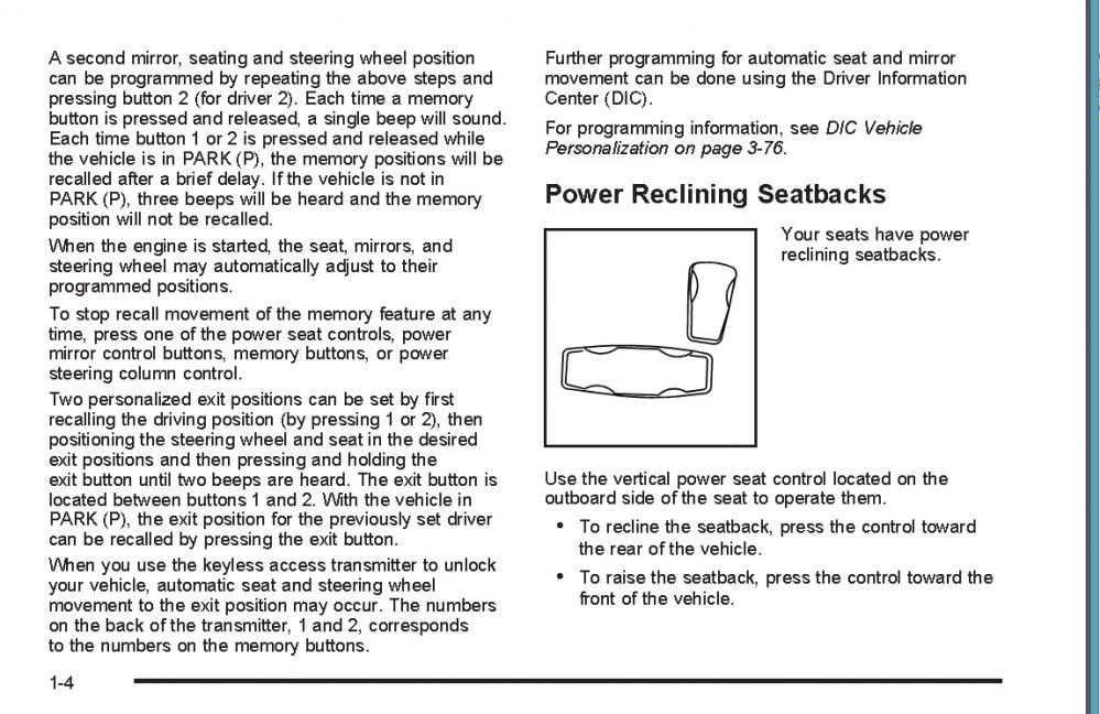

Yours must be different than mine, I can program all of the positions; 1,2, exit 1 and exit 2 using the same method of press and hold the button.
Does your problem happen for both driver 1 and 2? I'm thinking the exit position may have accidentally been programmed to a low position.

It is corrected! It never occurred to me that I could reprogram the 'eject' by setting things in the correct positions and pushing and holding the button on the side of the seat.....:(.... I am a wee bit blonde sometimes.
It had been working and suddenly it was not. Whether I somehow had pressed that button long enough to reprogram? Perhaps the button on my shorts pushed into the switch or what??? The odd thing is that both my Driver 1 and the eject commands were both messed up. Have not checked Driver 2, Steve uses that fob, I should get him to check as I would not be sure if it is correct to him or not.
Anyhow: thanks for your input, all better! :thumbsup

Don't think you need the fob, at least I never have. Just set the position you want for fob 1 and hold the far left button until it beeps twice. To set memory for seat position 2, do the same procedure setting seat where you want it and push far right button. Same for eject, set seat position and push middle button. If your battery was disconnected or went dead it could have fouled the seat positions. I have my windows act weird before and had to reset them also.
Although you are supposed to be able to per the manual, I've had problems setting the two different exit positions without using the fob to go to the Driver 1 or Driver 2 driving positions.
