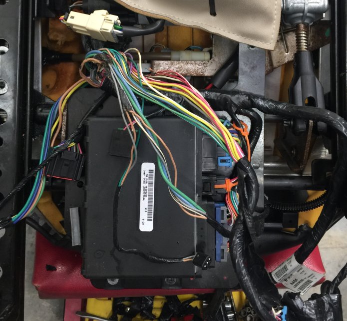

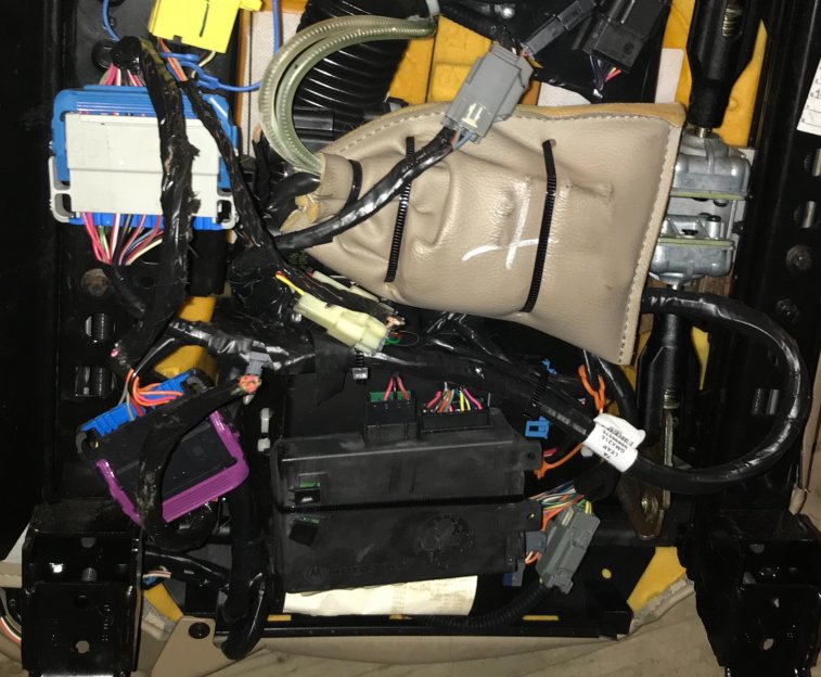

Yes it does,thats the only part of the wiring to seat that isn't messed up, i thought it strange if seat unpluged the telescopic sterring wheel doesnt work but its tied into memory settings i found out. Im trying to order the harness that pluggs into the connectors at floor on one end and bout everything else on other end, nearly all the wiring in the part if harness is damaged bad. I found one harness but not sure it will work because the seat modules look diff. Mine is all in one and the one im lookn st appears in pic to have two smaller modules. Ill try post pics maybe you can give me some insite 84F7C355-1BB1-4492-AA8F-C94433FE25C9.jpg2595836B-975A-4AC1-BEC6-5A6D1F55918D.jpgthe first pic is of my seat second is of seat i can get harness from. Ive only seen pic of it not seen in person. But dont there appear to b a difference?

Personally I would rather repair what I have than try and change to something different.
Ill have to repair it if i dont find direct replacement. But tepairing this harness isnt goin to b eady becsuse of location its at and the number of wires burned and how badly they are burned, melted togather where its difficult to tell one wire from the next. I may have to give it a go though, was hoping to unplug my damaged harness and plug replacement in its place. All the wiring is famaged at same location so the repail would make a buldging mess, might not work because of space, something caused it to fry infirst place couldve ben dragging somehow, i now ductwork at rear of seat is getting a hole in it fron dest track.
08-09
looks like 08 and 09 should be the same. I know the earlier ones looked differently. Just beware that several of the 08 totaled due to flood and you would need to dry everything out. and check connections. Good luck.
