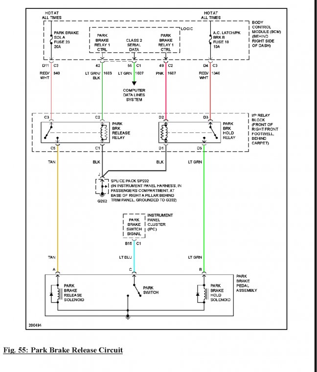

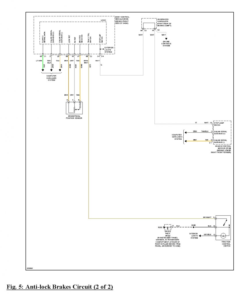

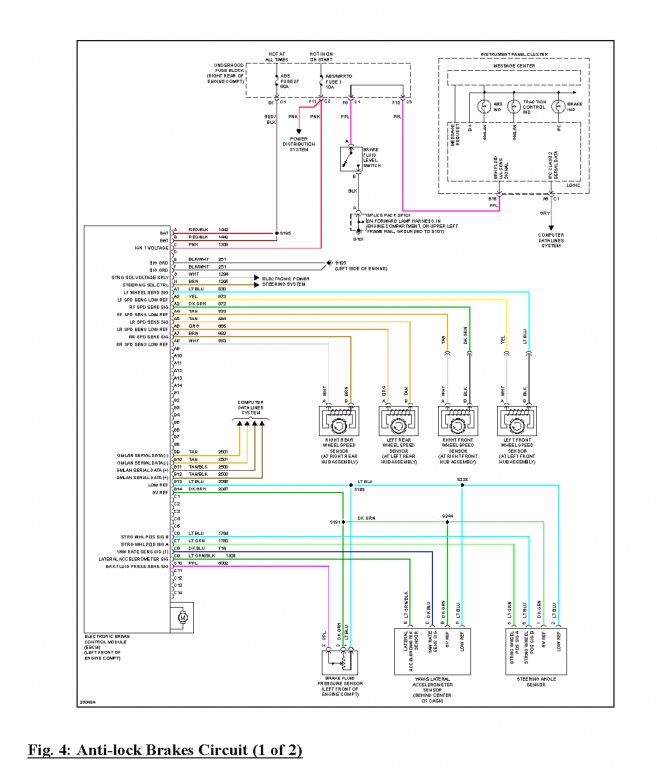

Enclosed are some images that shows the brake system and the park brake system that could help you to better understand the problem of your XLR, as you can appreciate it is a some complicated systems.
4 hours +/- could be a reality as the reaching of the position sensor is not easy... ounce replaced the system could needs to be equalibrated.

yeah, I would jack the car up and see if its all four brakes or only the rear. if its the rear not releasing then the switch for the park brake that is a little harder to replace still nothing showing up with that as a problem but if its the rear only thats what i would look at. still it should light up the dash for park brake on. I remember years ago ,every time my grand dad would pull up I smelt brakes and would go out and release his park brake. with the old drum brakes they just barely held and would smell but hardly wear. I will look to see were the switch is and even if you can buy it separately. pulling the 2 relays for the park brake should release it and that would be my second option. they may even be just a bad relay as they can get wet in that area.

If it is the rear, this could very well means that it is the mechanical and its electrical park brake components that do not works properly.
If this is the 4 wheels brake hydraulic fluid sytem and its electrical components that are defective, only a dealer and its scanner will tell and fix.
