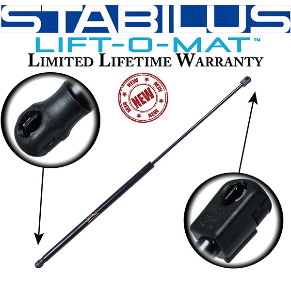

From 10 to 20 years ago in the auto parts business, I would never recommend STRONG ARM hood struts made by Arvin-Meritor Corp. as they seemed to
be always weak and didn't last a long time. Maybe they have improved their lift struts in the recent years, but I can't confirm that.
Personally, I would order the following struts:
MADE BY STABILUS FITS THE HOOD | SG130099
SKU: SG130099-W | MANUFACTURER: STABILUS
$24.90 Each V V V

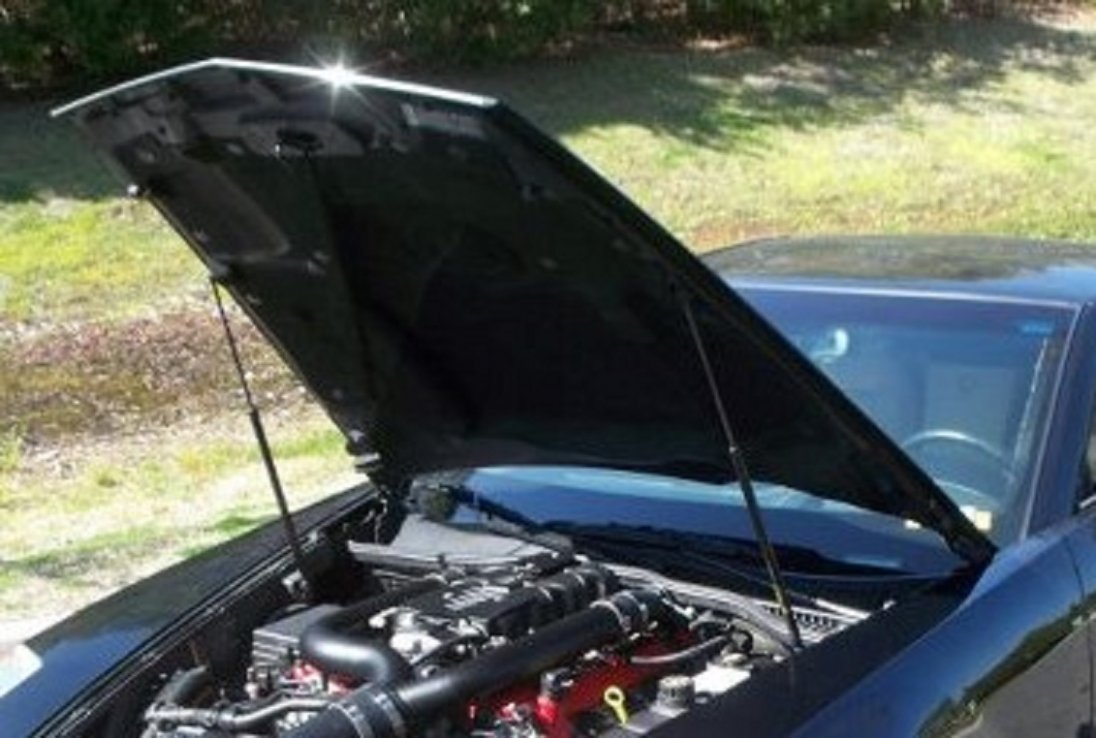

The struts for the hood purchased could be of the after market ones with a different concept that could fit the same but differently.
I have purchased in the past some after market struts that were fitting like the OEM.with the cylinder downward as per the photo
Enclosed is an XLR with the hood opened showing the OEM one installed and the after market ones that i purchased few years ago.... their push on clips fittings were the sames as the OEM, with no problem of installation.
