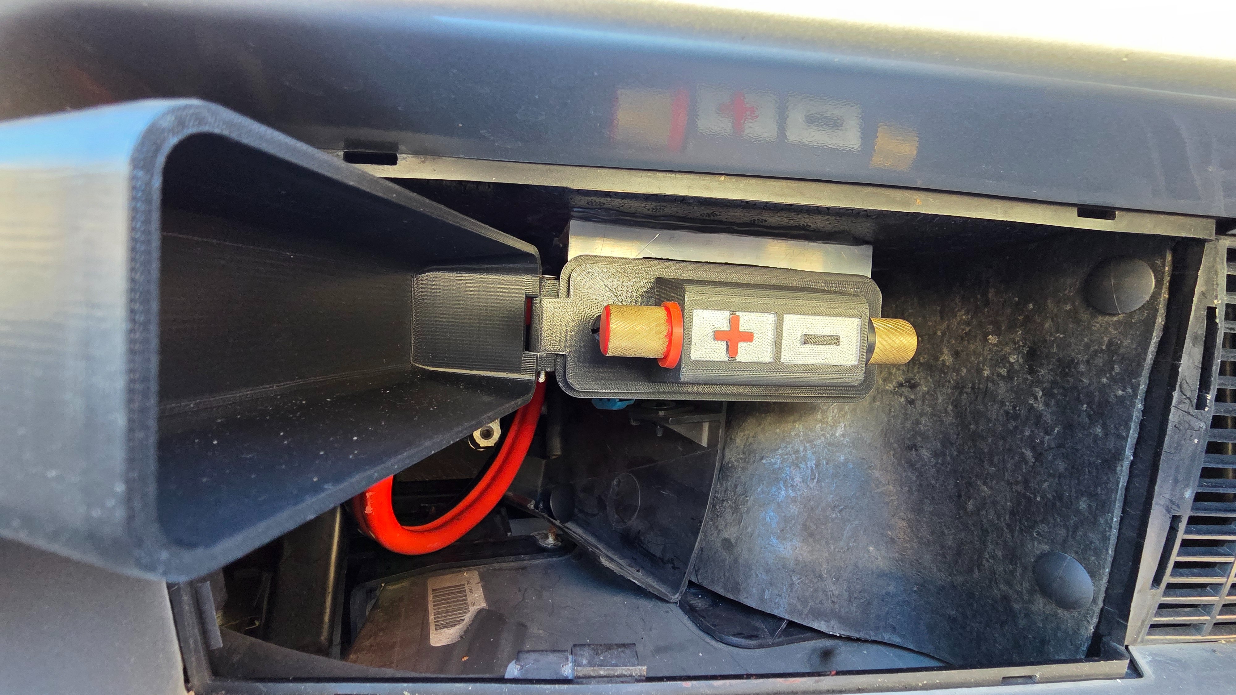

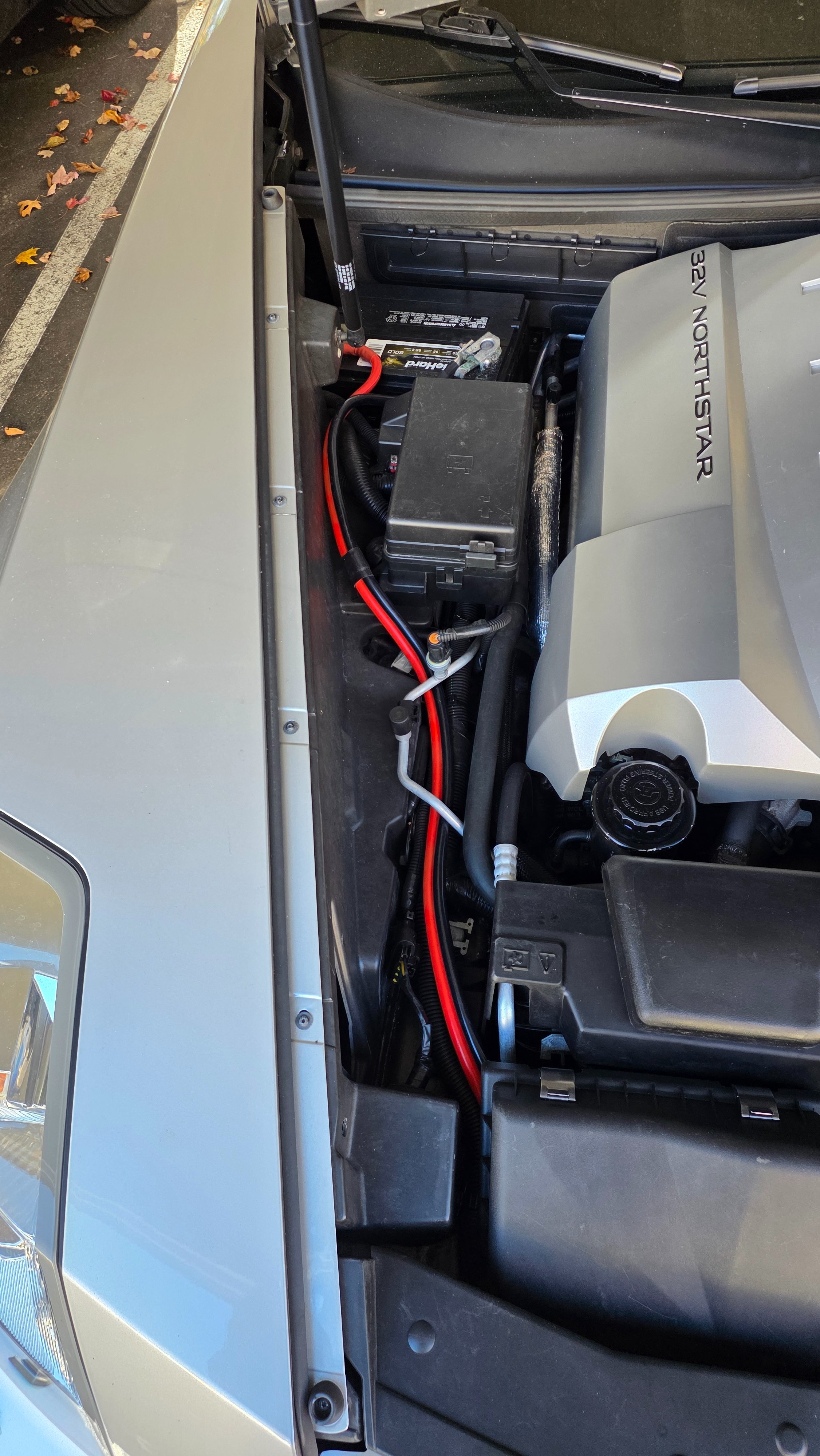

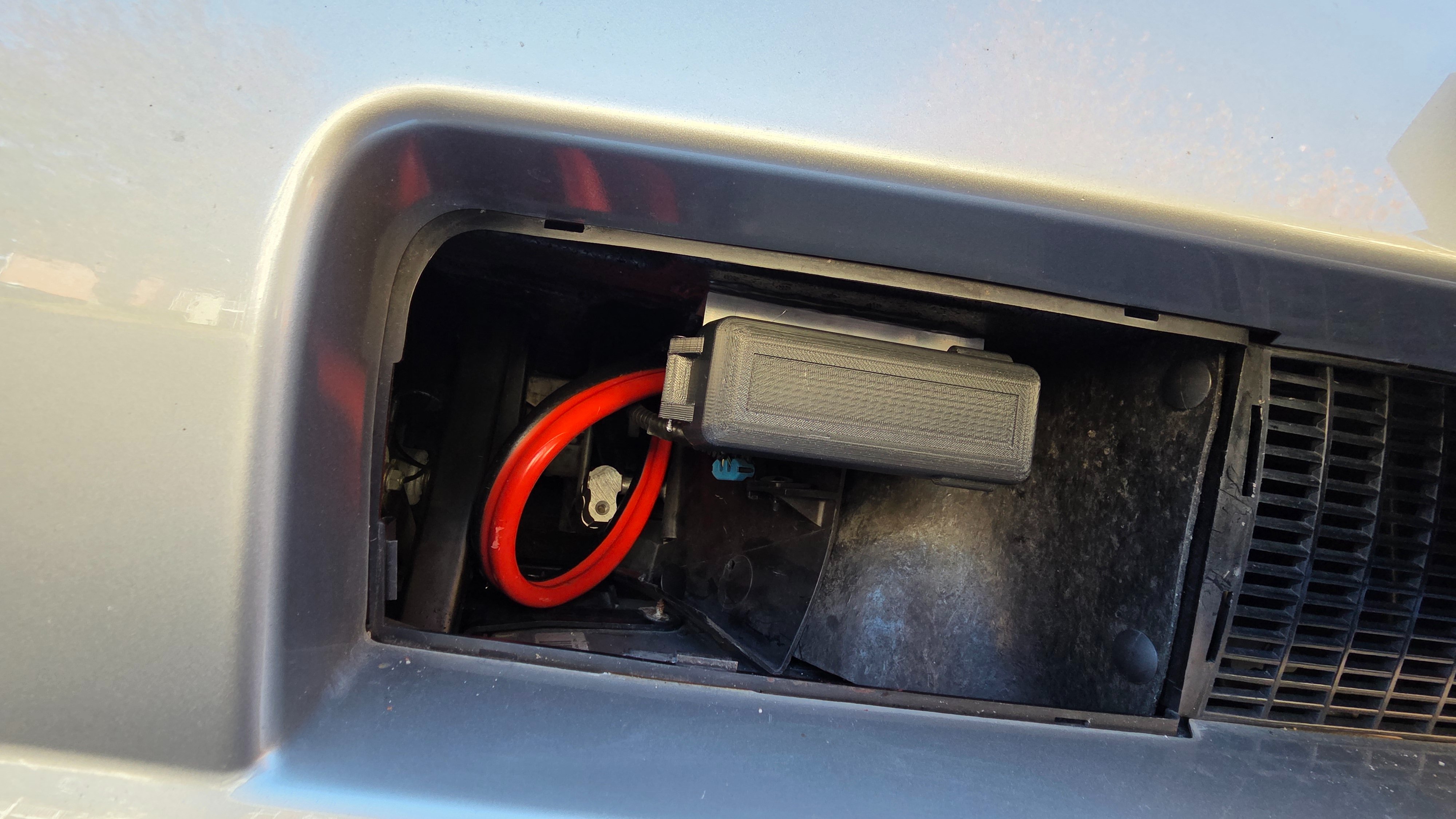

I recently found myself in an untenable situation. I was out of state with my 2006 XLR on business and the weather turned cold overnight from 50 degrees the day before to 25 degrees the next day. I went out to the car to run an errand and could not open the door. To my supprise the battery was dead, nothing from the key fob, nada. My mind raced as to what to do next. Here I am, dead battery, late on saturday afternoon, emergency key on the other key fob at home in another state and no GM dealer nearby. At a loss as to how the battery was dead with no previous symtoms I went back inside. Turned on my laptop and headed to the XLR net and XLR forum to try to find a solution. The only answer I found was to go to the dealer with the VIN to have an emergency key cut on Monday. Not satisfied I headed to the corvette forum to search for a solution. In the C6 section I found a post by Cincykid who had a similar situation in his C6 with a quick solution. He found the cooling fan control module on the back of the radiator at bottom, pulled the weatherpack connector, and hooked his battery charger to the Battery side of the connector and within a few minutes was able to power-up the car to open the door, pop the hood release and then jump the battery to get his C6 going. Now to all the skeptics telling me I will fry the electrical system, hang in there with me. After reading Cincykid's post and comments by C6 forum members chastising him for not hooking his battery charger to the positive terminal on the starter motor to accomplish the car entry to avoid any damage to car relays, modules or circuitry, I was not convinced I wanted to take the risk and started to make plans for visiting the dealer on Monday. Having a copy of the 2005 XLR GM service manual on my laptop I researched the wiring diagrams for the engine cooling system. While there is an early and a late design listed, my manual was missing the schematic for the late design, damit, now what? When looking at the schematics, I noted that the cooling fan circuit is fused at the underhood fuse block. I also noted that some circuit diodes were listed in the underhood fuse block. Not convinced that I could power the car battery (door circuits) safely via the cooling fan circuit, I decided to sleep on it before I made a move. The following day, I did some more schematic research and determined that the only way to get power to the battery of a locked XLR is via the cooling fan circuit and the battery cable at the alternator. Since getting to the alternator is not possible without jacking up the car, I opted for hooking a battery charger set to low amps (10 amps or less) to the cooling fan circuit and within a few minutes there was power to open the door and pop the hood, mission accomplished. Do not apply full battery power via jumper cables to this circuit as high amperage applied could cause circuit damage. I have driven the car since with no adverse affects. This procedure worked for me, but use at your own risk, consider this a pure emergency access procedure. I bear no responsibility for damage that could occur to your car using this procedure. Enclosed is a photo take from Cincykid's post with his battery charger hooked up to his corvette.
Everyone that owns an XLR fears of someday finding it with a dead battery. It's half-bad if the top is down or the driver's window is rolled down, but if the top is up and windows closed then it becomes an absolute nightmare.
I have come up with a solution that is relatively easy and inexpensive and doesn't change the car's appearance in any way. I mounted the unit behind the passenger-side lower grille panel.
The basis for this solution is a JUMP-MAX" XR-1 Battery Terminal Relocation Unit from Jump-Max.com Total cost for the unit and a tube of Flex-Seal Adhesive was ~ $125.00 If anyone is interested in the details, please PM me.
