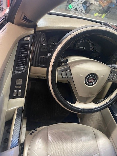

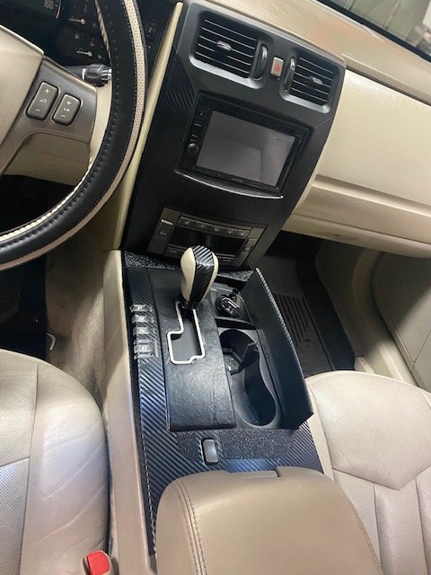

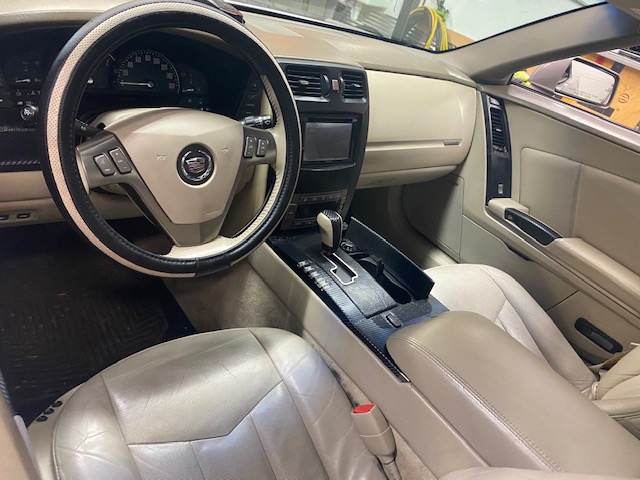

I just got done playing with some carbon fiber wrap. I think I like it so far.

Scarto, did you peal all the metal coverings off or go over top? Looks good BTW. Looks like we have the same install kit bezel. I have been waiting for warmer weather to tackle mine. Collecting samples of stuff. While trying to match the texture of the dash top I have a piece of Tolex (musical amp covering) that is vintage Fender that matches well. But its kinda thick and may not be as pliable as I need. Nice job!
I left the metal in place and scuffed it up with fine steel wool. Lots of patience and sharp razor blades and help with the heat gun! Ordered black XLR floor Mats to go with the black and “shale” theme, and I also did the headliner in black marine vinyl. Searching for a reasonably priced set of black seats and that would really complete the look I want.
