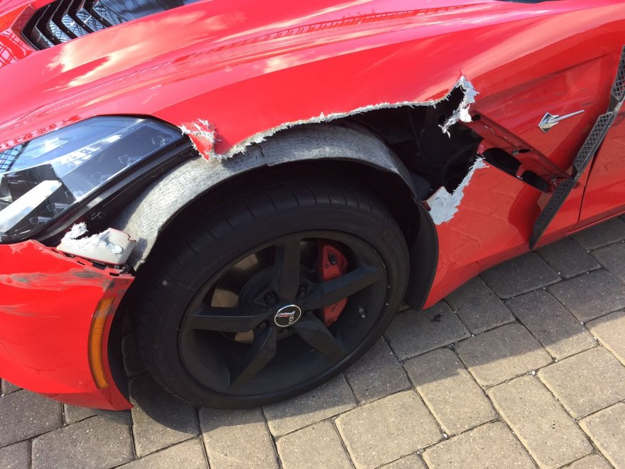

You owners replacing tires with 'non-run flats' are correct, you can fix a nail wound or puncture with the fix-it kit,,,,,but should you have a
blowout with non-run flats you are risking severe body damage. The dollars you saved will mean little if this should occur. WTH, you
bought a hi-end Cadillac and can't afford a great, run-flat tire? Picture of one who saved the extra dollars on tire expense V V V

Driving with used tires or cheap tires could get you that kind of problem, it is rare of our days but it could happen when the car is frequently drove hard, and having the tires side walls cut, etc .

the above post is true but .Run flats come apart also. They are just designed to be able to drive with little to no air in them and hold the car up. thus the stiff sidewall and ride. If you run over something that cuts the tire or you continue to drive on any tire for a distance with low pressure it may come apart. Run flats are limited to a few tires in our size where there are almost limitless regular tires with all sorts of performance not given in run flats. I do not know for sure but have heard if a nail in a run flat is driven on they are thrown away and a new tire is needed. A nail hole can be repaired fine on a regular tire. any tire damage can result in expensive damage if not taken care of immediately.

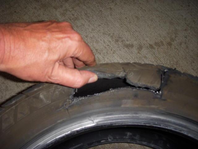

Back to #1 > Here is a picture of a runflat sidewall on a Corvette that took a rock shrapnel hit to the sidewall (rt frt tire) and of course all the air went out. No plug kit was going to repair this damage. This tire went 130 miles at 60mph to the nearest town that had a non-runflat tire to replace it.
How do I know this? I followed this Corvette the entire way staying behind it to warn the Corvette owner if the tire might come apart, and having them stop immediately. Made a believer out of us owners on that cruise event who witnessed this situation. The Corvette owner wrote the story and with pictures sent them to Michelin who were happy to hear the story. Michelin sent them a gift certificate for 'TWO new Michelin runflat' tires at no-cost to them'.
My suggestion > if one is going to do ALL in-town driving, then buy non-runflat tires for replacement. If one is going to do long mileage trips or high speed driving, then buy runflat tires and have piece of mind.

ian, run flats must be broken down and inspected. see photo . you cannot repair a run flat from the outside. The plug MUST be installed and bonded from the inside of the tire to keep from delamination of the inner section from the belts. tire companies all say tires of any style need to be plugged from the inside . Not that a lot of people still plug them from the outside. but do it at your own risk. this tire would show no damage from the outside but upon breaking down the tire is ruined as can be seen.run flat.jpg article found at tire rack on run flat damage
