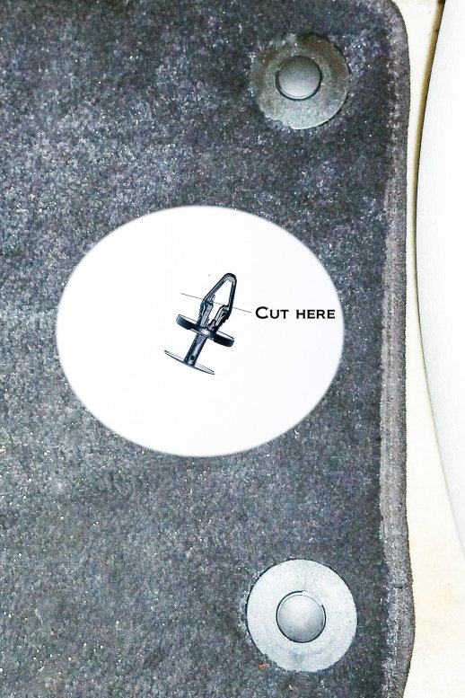

A couple of us got a pair of Lloyd's before the first of this year. I've found that the locking collar on the new mats are slightly larger than the pins on the carpet are. Several times in and out of the car will result in the driver's side mat coming loose and bunching up under the brake pedal. We all know how dangerous that can be. Took me some time to figure the fix out (at least for me). Used the self sealing black tape stuff, but that didn't work, wrapped it in electrical tape, that didn't work either. There were a few push pin retainers missing on the fender wells of the car and I had a bunch left over after I replaced them. I measured (eyeballed) the flange on the retainers and it's slightly larger in circumference than the posts on the carpet. I then slowly drilled a 1/8th inch hole in the middle of each post, cut off about 5/16th of an inch off the bottom of the retainer pin, and pushed it into the drilled hole. Cutting off a like amount on the push pin, and pressing the push pin in till locked gave me a clean look which still lets me remove the Lloyd's carpet to clean/shampoo out of the car.
A picture follows.
A picture follows.
