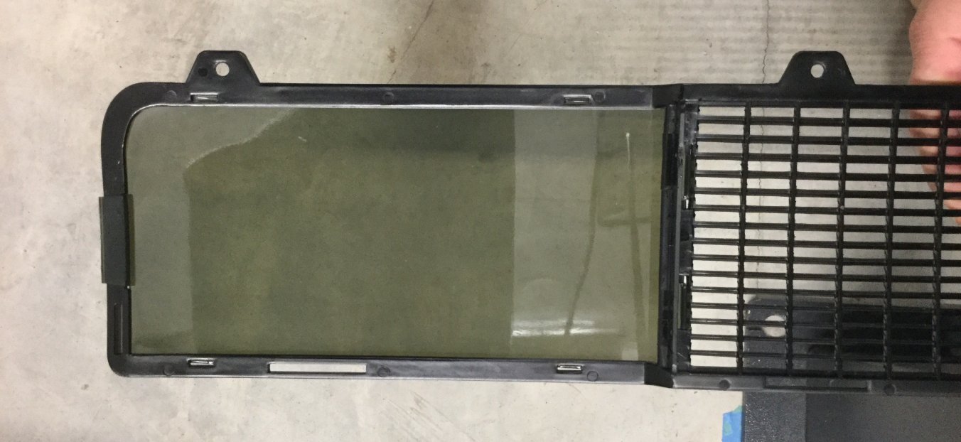

I doubt there's a way to tighten it without glue/tape/buy a new one. I got a replacement one for mine because a few grill pieces are broken. I looked at it & the smoked pieces are held in by plastic tabs. I'd bet yours are broken. There is info on p. 3-27 here on popping the driver side one out to clean it, not sure how that would work: https://www.xlr-net.com/specs/2006/2k06xlr.pdf
Here's a picture of the grill, hopefully you can make out how it's put together; it hasn't been installed because based on the tabs on top Mike determined he'd have to take the bumper off to replace it:

The first step to fixing this problem is to identify the cause of the problem, by removing the bezel and performing a visual inspection. Is it seated properly?
Are any of the retaining tabs broken? Is the lower grille affected? If so, then you can make the best decision as to whether to bond it into the lower grille or replace any defective parts.

Hi again all..I checked out the piece and all the tabs are there..it's holding on one side but precariously. it seems there may be a gasket missing as the other side with the ACC seems to have one showing slightly..That side is in tight..
any idea as to getting a new gasket ?.new complete piece.? Any thoughts
