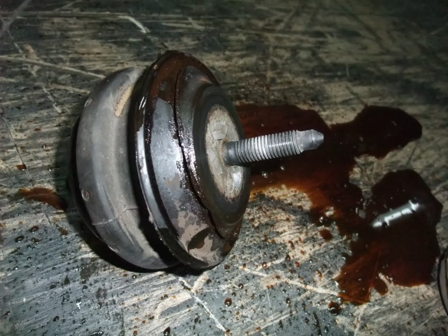

leaky motor mount.jpg apparently this. haha I have not seen one leak either. The corvettes use the same ones or at least the same style and I was correct above. some guys said they did theirs in an hour .looks like they like to replace them with a more solid bushing type. I will have to look but the aluminum mount on the engine block may be easy to remove then the rubber mount comes with it.

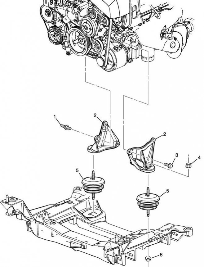

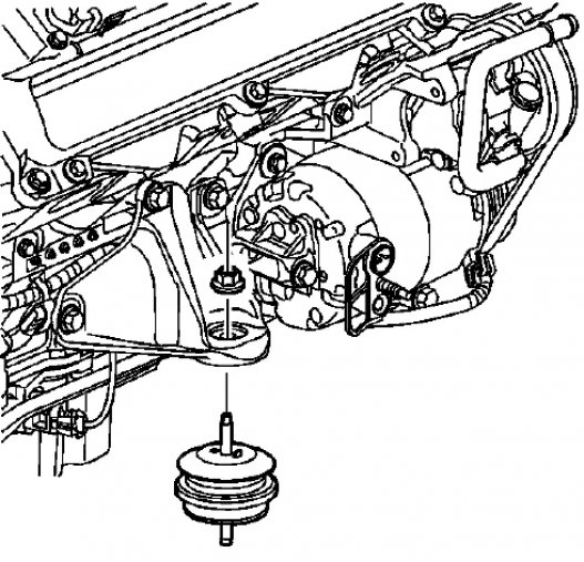

Replacing the engine mounts is usely not that hard to do, however since the XLR engine is deep within the chassis of the car, little room is available to work .
As you can see on the next image of RH side of the engine is the A/C compressor that will be on your way and on the LH it would be the generator ( alternator )
Also the manifolds are close to the engine leaving almost no space, lowered or removing the crossmember is the solution.
If your engine mounts are dry, it could means that there is no real leaks, the photo of sally indicate one with a leak, that is obvious.
