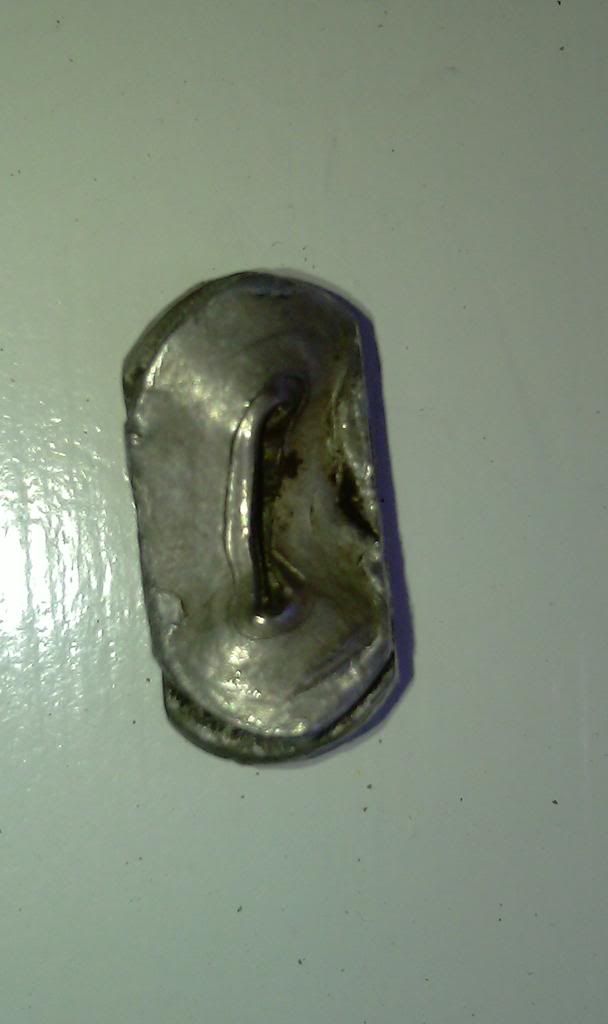

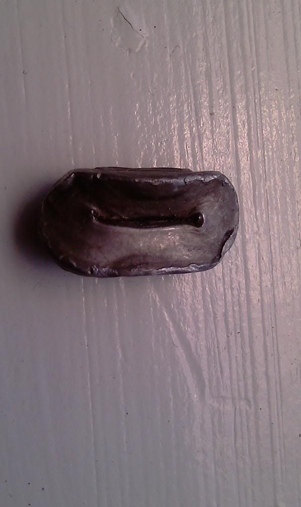

And here is the culprit..... :mad:

None of the above as yet, now I am told it needs a new oil pump. The oil pump has been ordered and should be in on Monday.

Geesh, the oil pump bit it too? I am so sorry! Your XLR is going to have completely new innards by the end.
My next question to them would be how long did they run it before they decided they had no oil pressure and needed a new pump! As an old aircraft mechanic if we found something like that in an engine it was time for a new engine!
I don't care how long they ran it with low/no oil pressure, they or nobody else can tell how much wear occurred without taking it apart. For my money that is the biggest red flag yet. I doubt there is any significant wear, but no one knows, they can only think, guess, hope.
from stella's post: Sounds like theirs a little progress good. What exactly did they decide replacing? I think what busa is talking about is the burn marks on the paths of where the cams ride the valves. The journals should have a polished look like some of the others. Means your getting to much friction ,heat buildup,loss of lubrication?
I almost didn't post this because I don't want to be negative. I just can't stand the what if! We all love these cars and want to keep that feeling. If it was my car and I was capable of wrenching on it, and it was my money I would probably take the chance. Its their money and owner can't repair.
X fire I feel bad for you but I would demand a new motor. When busa and I responded about the cam journals we didn't know about the oil pump. That shows that the top end of the engine wasn't getting oil pressure. So that means that either the oil pump was fubared on the initial start or on the second brain fart start. Was obviously started with NO oil pressure. I noticed in earlier pics. that the oil pump is in front of engine by crankshaft does that mean their gonna take the drivetrain down again? Whoever inspected your engine should have disassembled your entire engine mic'ed every journal and checked EVERY component. I wouldn't take any advice from anyone at the dealer about your engine. At this point their probably so fed up with your car, and loss of money, that they just wanna get you out of there. I totally understand that you just want your baby back how she was but today's motors are that much more precise. The tolerances in today's motors are tight the unforeseen is gonna be the devil for them and you. CRATE MOTOR remember these guys work at a dealer that services the car. How many engines you think your local dealer rebuild. I now know how many they've ruined!GOOD LUCK
