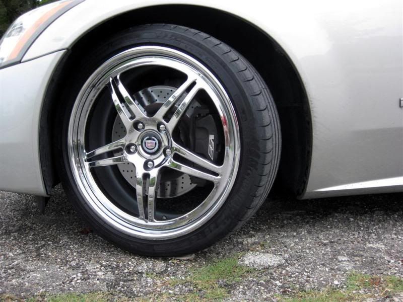

After two long months, I finally have my new tires and wheels mounted on my 06 XLR-V.
Forgeline SP3P 20" 3-piece wheels... hidden hardware, chrome, with
break-away stems, and internal TPMS brackets.
http://www.forgeline.com/<wbr>products/performance-series-<wbr>step-lip/19inch-and-20inch-<wbr>performance-series/sp3s.html
They were spec'ed and ordered by D3 for me while keeping in mind that I may do a 6-piston front and 4-piston rear brake upgrade. So the offsets and such were set to make room for them in the future.
255/35/20 front and 285/30/20 rear Michelin Pilot Sport PS2 tires.
http://www.michelinman.com/tires/ultra-high-performance-sport/pilot-sport-ps2/
I wanted the widest possible tire in the rear since I've been having issues keeping the tires from spinning when driving aggressively. the 285's fit just fine (and there maybe room for a little more :D)
SureValve break-away stems:
http://www.hcwsinc.com/<wbr>gallery.htm
I was initially concerned that the ride would be harsher moving from the 19" to the 20" tires, but moving from run-flats to non-run-flats took care of that... in fact, I think that these new tires ride better and quieter than those Pirelli's that come OE (and the wet traction was terrible as well).
I guess the only downside is that I now have to carry a plug-kit and air-pump incase I get a flat.
Photos below (car is a bit dirty :)):

BTW, make sure you remove the clips...
I forgot to mention... when bolting on aftermarket wheels, you must remove the retaining clips that hold the brake rotors in place. They are placed on there during the build process at the plant to keep the rotors from falling off during assembly. There should be two per rotor at all four corners - they may not be there if your car has been serviced and they had to remove the clips to fix a problem.
What the clips look like (I shot it after half removing it so its easier to see):
The stock wheels have a little cutout for them, but aftermarket wheels don't and will cause your new tires and wheels will not seat correctly and they'll probably behave like they're out of balance.
What the back of stock wheels look like to accomomdate the clips:
Additionally, the TPM sensors for 05+ XLR's must use an RF tool to trigger them for the car to learn its position. If you want to buy one, the least expensive one I found that will work is the ATEQ VT10 for about $100. I ended up finding a local shop that had one and they took care of it for me. The process looks like this:

Didn't Standby have a post on here somewhere about his tires rubbing the inner fender wells? I thought they were 275's tire. How you get a 285 tire to work?
Edit: Found it!!! Post #23
https://www.xlr-net.com/forums/showthread.php?t=3340&page=2
I actually responded to that thread yesterday (post 30).
I don't know why Standby had a problem. I'm assuming he has an offset issue with the foose rims he has. Its possible that a small spacer will fix his problem.
My wheels were specifically built for the XLR by Forgeline and spec'ed by D3. They were completely custom fitted. You can see from the photos that the 285's fit fine... and when I mounted them it looked like I could even go to a 295 - and maybe I'll try that when I wear these PS2's down.

Wow - ok...
I still don't understand how that could be... when you look at this photo I measured about 3 inches of space between the fender and tire.
I'm having no issues with rubbing... and D3 doesn't seem to have any issues either - and all of their mod'ed cars are lowered to the ground like this:
I wonder whats up with standby's car...
[shrug]
Regardless - I have 285's on mine... and I'm pretty certain that a 295 would fit.
