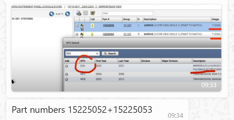

does anyone actually have power folding mirrors> ibought a couple that turned out to be just foldable power mirrors. you have to manullly fold them in. I see listing for both but no option codes on any and none listed anywhere .If you have them , was it part of a package and how do they work. I read somewhere that the mirror switch needed to be in the neutral postion then press it. Thanks for the help. tight spaces so I would like to add them as I am going to add the outer turn signal lights on the mirrors at the same time.

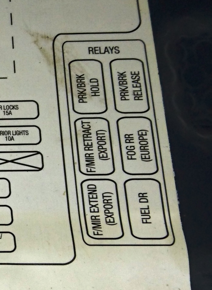

I have, and works very well. It has own switch. I think only export option (like intrusion sensor).

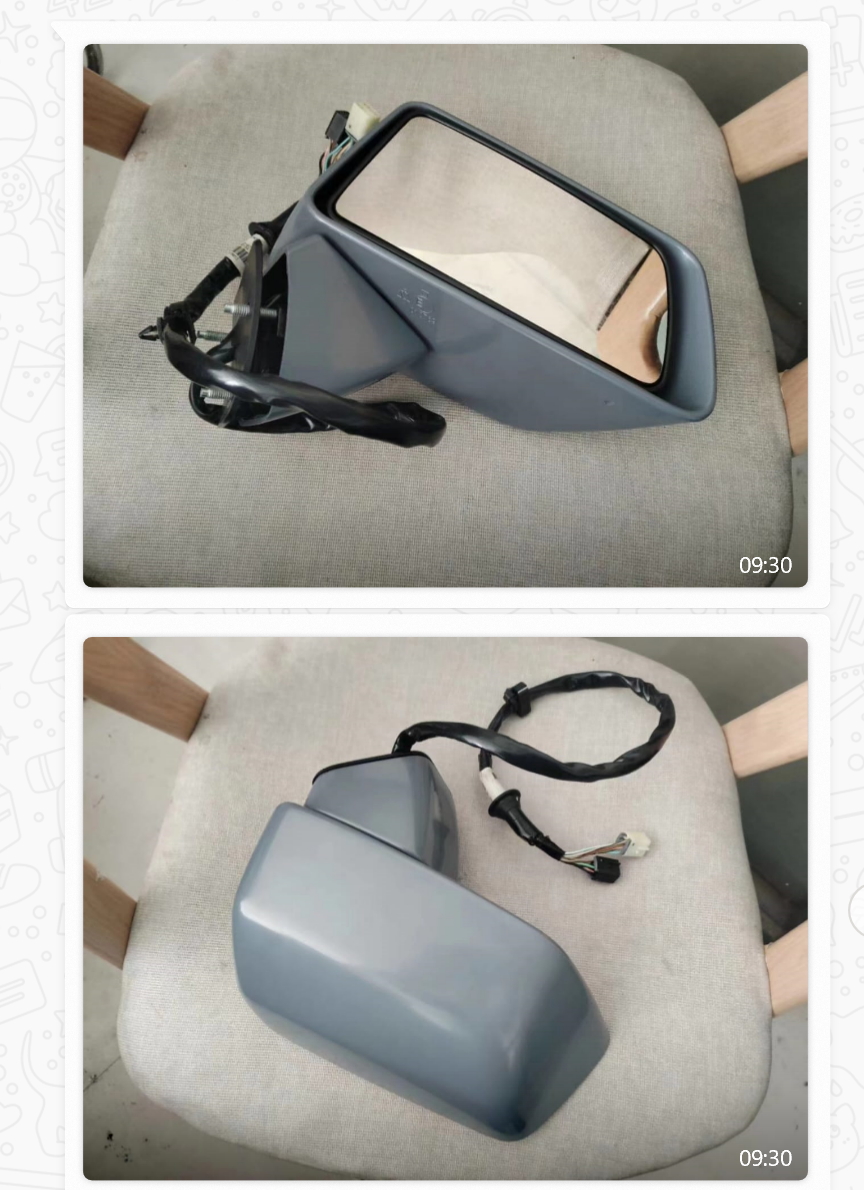

Mirrors are same -only with motor. Switch is just above mirrors 4 way switch. Sorry, pics later -car stays in garage because of half a meter snow...

that's the ones I got except bought them from their ebay site. they do not have motors in them to power fold. One side has Arabic writing but I can change the glass if they had actually been power folding and not folding, power mirrors. Got them cheap enough will use them for something
