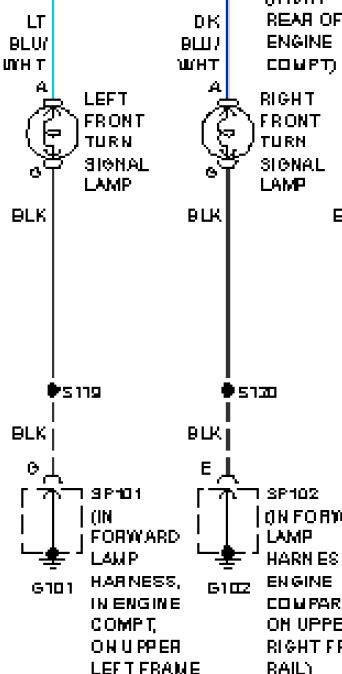

I think you're mistaken. There are only three wires on the socket. Two ground (black) and the brighter turn signal filament (blue wire.) I tried using the resistor only for blinker, but the system DIC still shows an error. Other people have said that they have working switchback bulbs without any fancy extra stuff, so there may be something available that I couldn't find. It would need to have a circuit inside it that could differentiate from a continuous signal (DRL) and a pulsing signal (turn or hazard). It seems unlikely there is one because this is a really uncommon way to do it. Maybe we should move this to a new post for those who may want to find it later?
This is the schematic showing only one filament and one signal (blue)

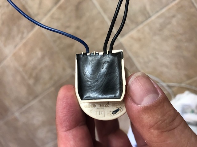

Here's the socket itself.
I am talking about inside the socket were the bulb goes. There are four contact wires there .I forget but on some sockets the grounds are both on the same sides on other sockets the grounds are on opposite sides. This is why many bulbs wont work with the factory sockets. the ground wire splits inside the housing of the socket and feeds both sides of the bulb. It does not matter on a regular bulb which wire is hot and which is ground but an led does as you know.
I don’t disagree with any of that, but I am positive that the way our DRLs work is a continuous +12V on the blue wire with respect to the black wires, and the turn signal is a pulsed +12V on the same two wires. It isn’t obvious, but the socket has two ground wires that are connected together internally. From memory, one is the ground connection from the vehicle wiring harness and the other provides ground to the little white marker lamp. Most other systems use three wires. As you said, two common grounds and +12 for each, independent filament. So that’s what the after market companies are designing for, not our unusual method.
