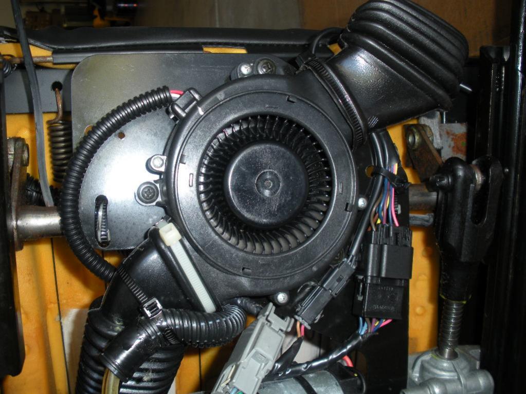

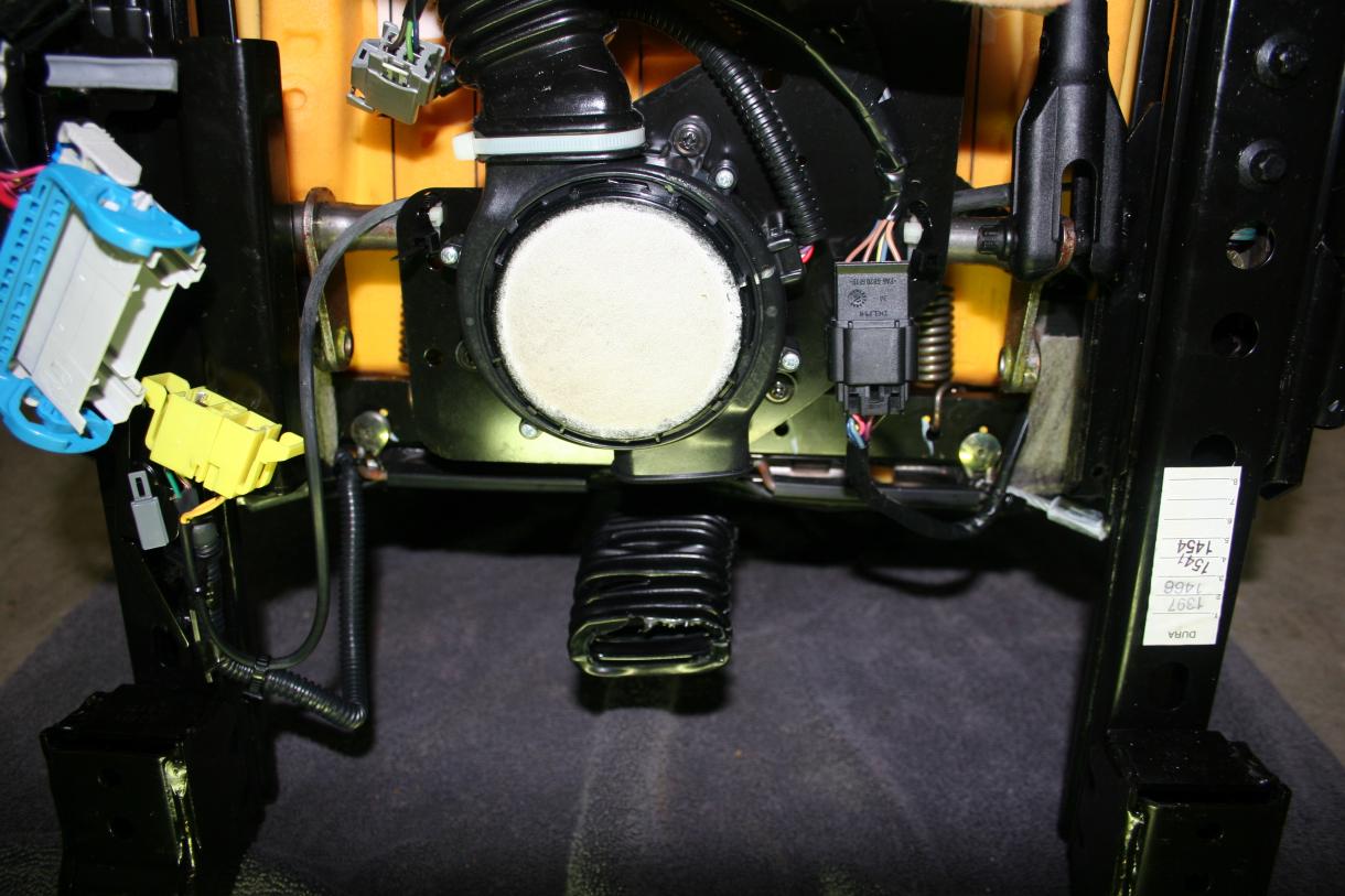

I found this round filter today underneath on the back bottom of both seats they turn on / off with like one click , righty c tight c/ lefty C loose c.... Drivers side was darker and dirtier which would seem normal! Did anyone else know they where there?
Here's a pic of both side top n bottom, there near the back in the center area underneath kind of hard to get you need to raise up and forward all the way to get underneath to reach your hand under to turn them! There only about 3" round!
Here's a little additional detail to clarify where the seat air filter lives. The top picture is of the driver's side seat cooler assembly. The TEC is above the filter. The bottom picture is from the underside of the passenger side seat with the filter exposed.

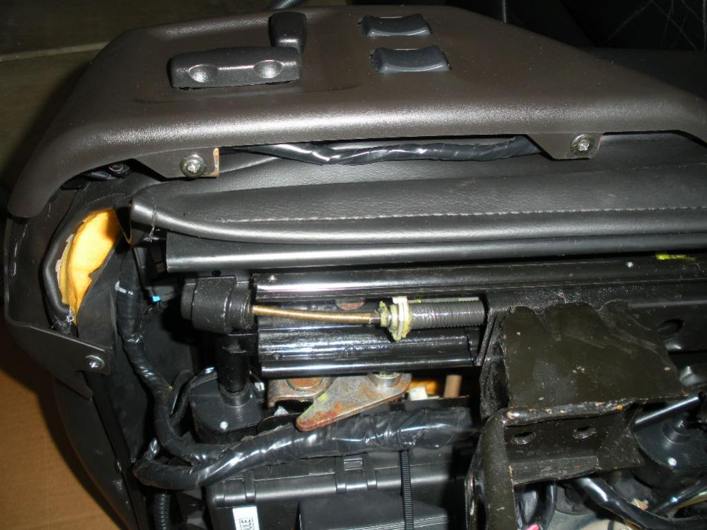

Do you need to replace these or can they be cleaned?? Didn't even know they were there...
