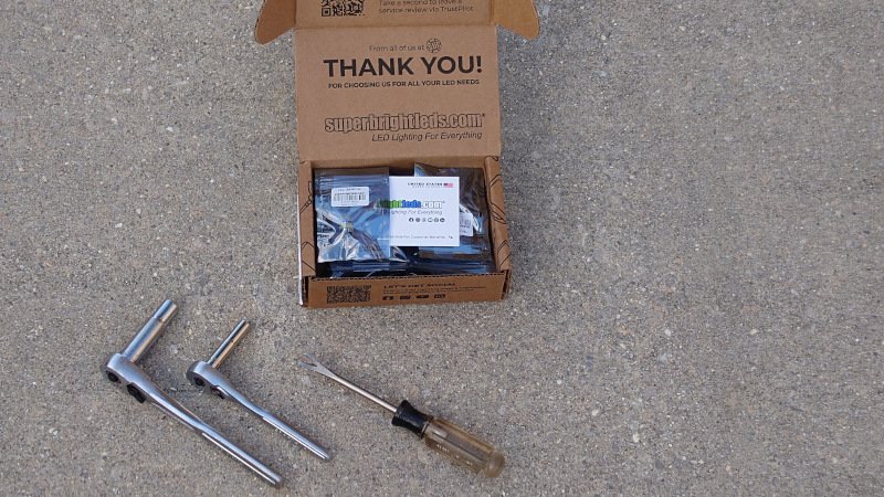

Since the yellow daytime running lights go well with the Steele Blue color of my car, I just ordered the Super Bright LED DRLs along with a bunch of other LEDs to replace the incandescent bubls. They have already arrived, and I installed them yesterday. They are brighter than the halogen 3157NA and are cool enough to hold in my hand. I got the switchbacks, so if I decide to build the 2-pole to 3-pole circuit later, I can still get white lights while driving and yellow on turn signal. The new reverse LEDs seem more than twice as bright!
