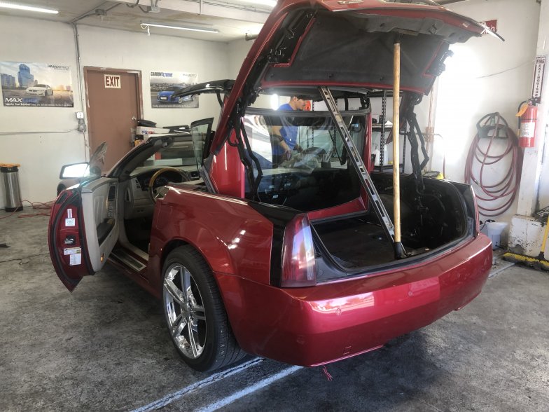

The broomstick mod? Yeah, it's nice - surprisngly enough the roof hydraulic parts were'nt all that heavy. Just a lot of small parts. . . . My xLR is def not in the condition I wish it currently is, but I don't mind - I don't have a garage any more, so it will always have to be outside. Right now it's perfect - I have nothing but time. . . . I haven't even done a thing to it since I bought it last year for 5 Grand, till this crap hit. It just seemed like a great deal atm & I always did want one of these. Now I have time, not a whole lot of $ - but I have the time - unfortunately, otherwise I'd put about another 5 into it & run it on a nice nitrous shot - sh!t, the motor's for these are cheaper than a tail light

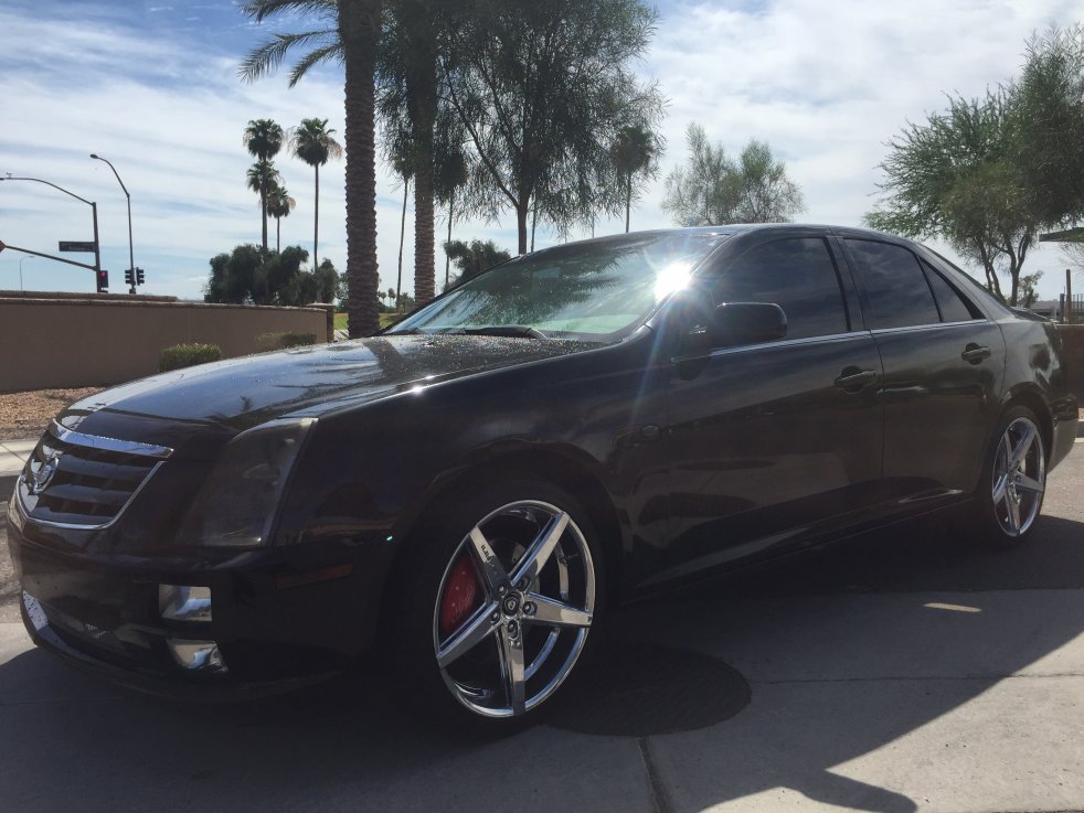

I had the MRC's on my STS fully functional, but that was almost a decade ago. . . .I remember it rode excellent. Back then, each MRC was about 700 Bucks for my car. . . . I sold it as soon as it seen 70k
Gawd I loved that car, after that I always had to have at least one Cadillac around

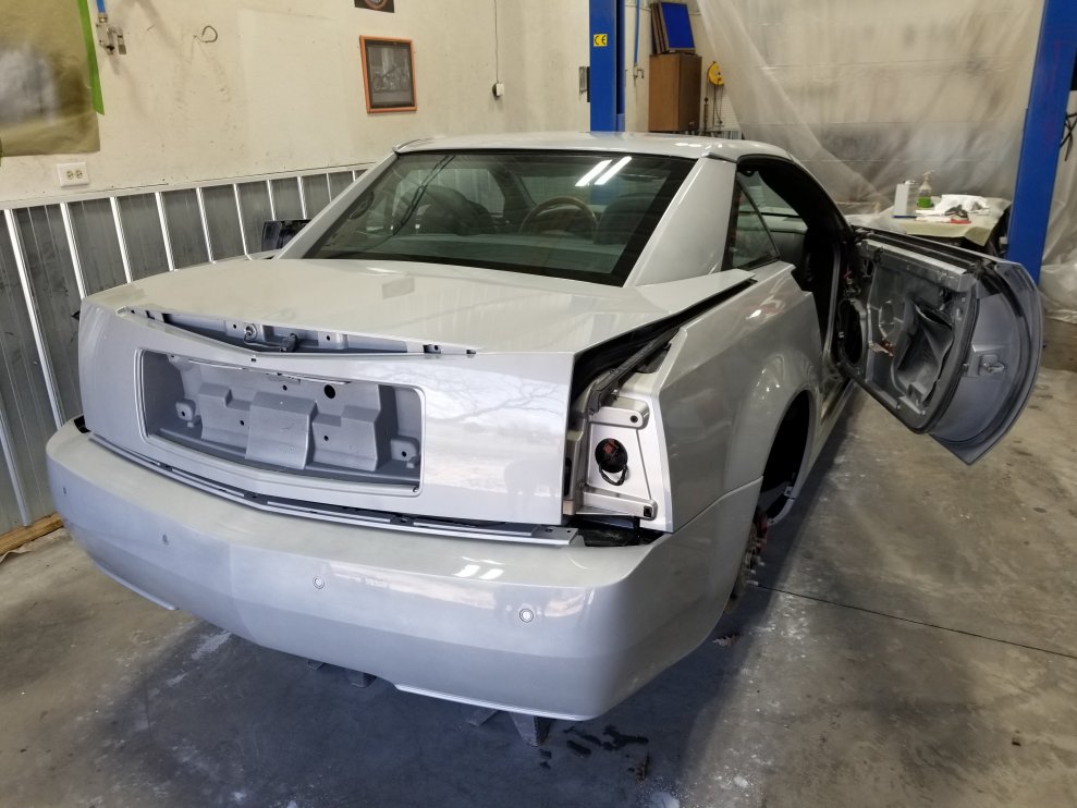

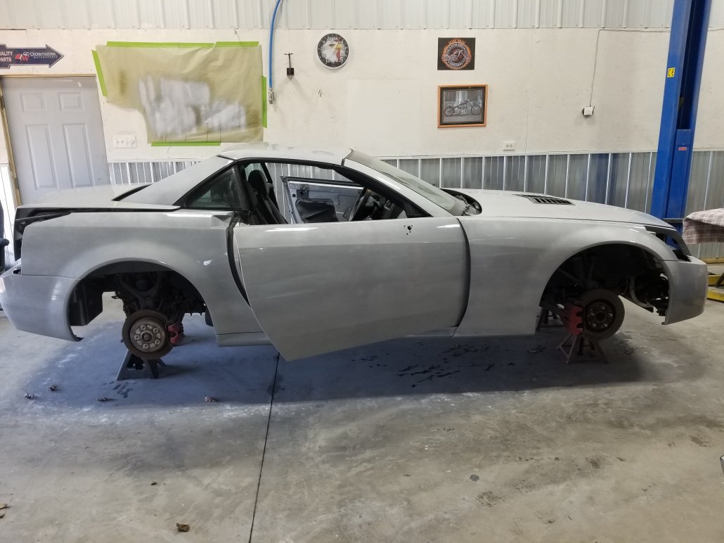

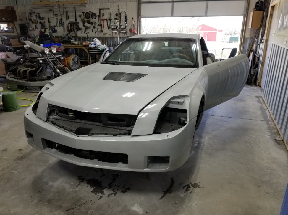

Finally finished the base and clear, had to do the clear in three sections just to try and keep the dirt out of it. Not sure why but every little fuz piece no matter how small shows up like a sore thumb! Mostly because of the high gloss I think.
Now it's time to put everything together then wet sand some areas and polish!

Looks mighty fine Vetter - good work! :thumbsup

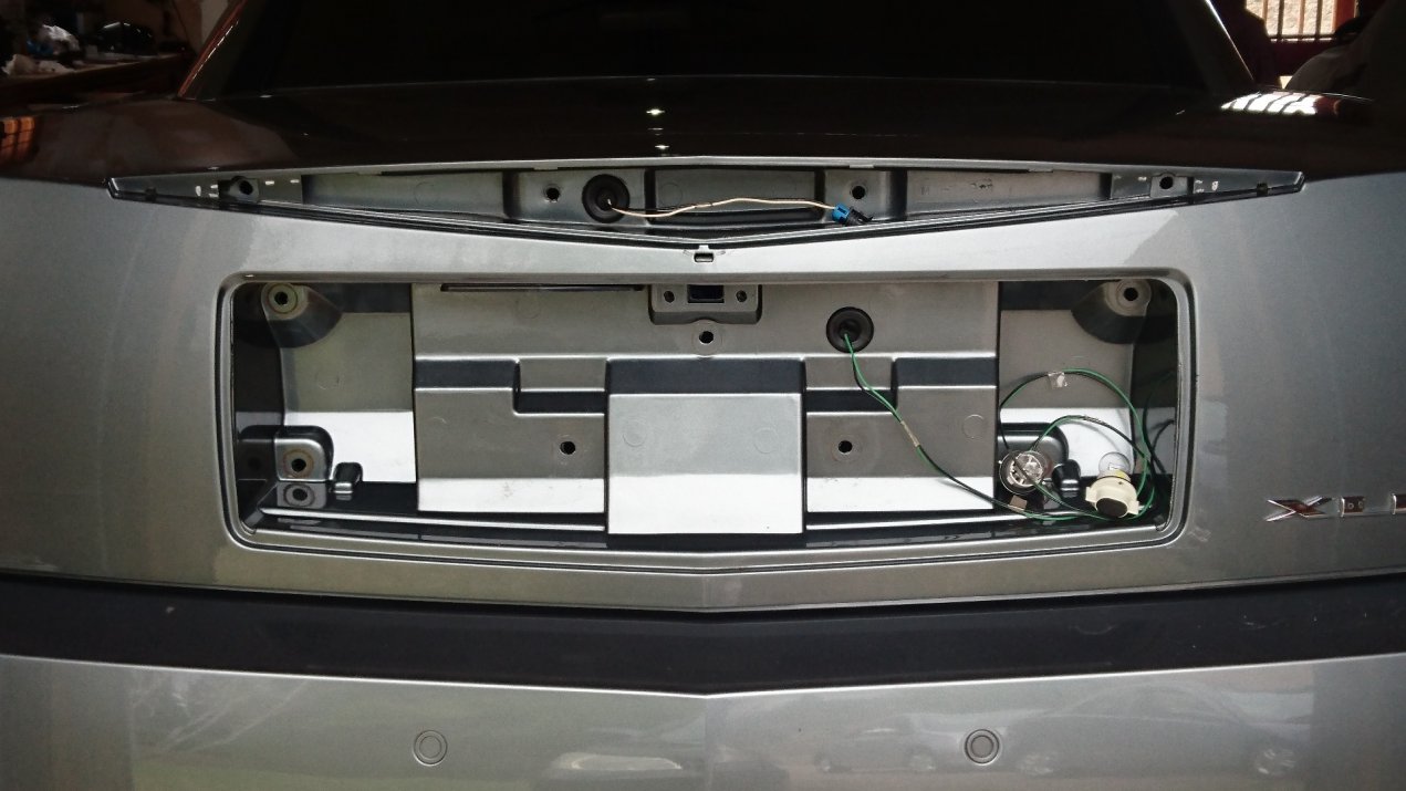

So here's a little warning for everyone.
Not knowing the entire history of #67, all I can do is guess that the license plate panel had never been removed from the car...ever. The amount of sand and debris in there was really substantial, and add to that, the mounting pin backing washers were obviously not well protected or plated at all.
You may notice some traces of rust where they were tightened against the mounting holes. I'll get to that and I'll clean up and coat those backing washers properly before the re-install.
The big nuisance happened to be one of the little 4mm diameter license plate lamp screws. Again, poorly plated if at all and while 3 of the 4 came out with a bit of heat and penetrating oil, the 4th one snapped and took a couple of hours to fidget out the remains. If you break one, you'll need a small right-angled drill to get to it, and a shipload of patience.
The word of advice is, if your XLR is still stuck in a holding pattern or maybe if you're just curious, go check this area of the car out carefully. Force nothing. Oil and wait and oil and wait because being so tiny, there's little to no room for error if one does happen to snap.
I happen to have the good fortune to have enough of the necessary tools and equipment to handle this, and an abundant supply of fasteners from all sorts of other things. All the fasteners I've removed go right in the trash and I'll replace 'em with stainless, and lube their tiny little threads properly prior to the install.
Ditto for the rear hood release switch (known to become intermittent and require rework or changing). Those screws were rusty however did come out without any fuss, but I will make sure they are replaced with stainless as well.
I don't think your car has to necessarily be driven in wet or dirty conditions. When driving, it's a low pressure area which means corrosive exhaust fumes and fine road dust must get blown up in to that area all the time. Curious that GM didn't seal this area a bit better and consider even one notch above average fasteners.

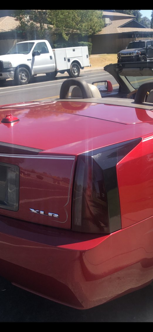

Got the windows all limo tinted + the tail lights partially vinyl wrapped + did some cf vinyl on the 3rd brake light
how does the side marker in the taillight shine thru the wrap? that would fail inspection in our state .It looks good though. I would wrap it in car color. I assume you are hiding the broken cracked top of the lights ? We have fixed a few with a 3m red wrap that is almost the same color of the light and looks nice. wrap the windshield post in black for me and let me know how it looks. I was going to do one like that but never got around to it. Save me the time. HAHA

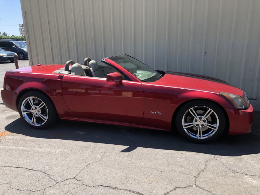

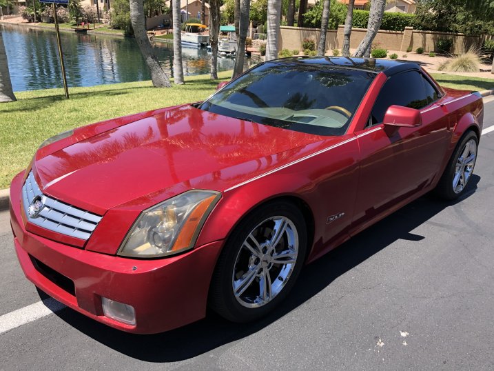

A well needed complete paint stripping of old wax, with MultiClean, then some paint correction, then a ceramic coating to a give Roxy her a high gloss shine! Next is add the Quick N Slick to seal the ceramic coat, then top with Endure XXL whole car including wheels, glass, then tires coated with Tire Shine, then interior cleaning with leather cleaning & conditioning! Done with all my CroftgateUSA Products, which i sell and ship free

Nice job on the XLR
^ that’s amazing!

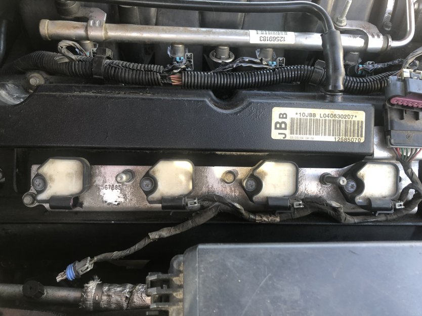

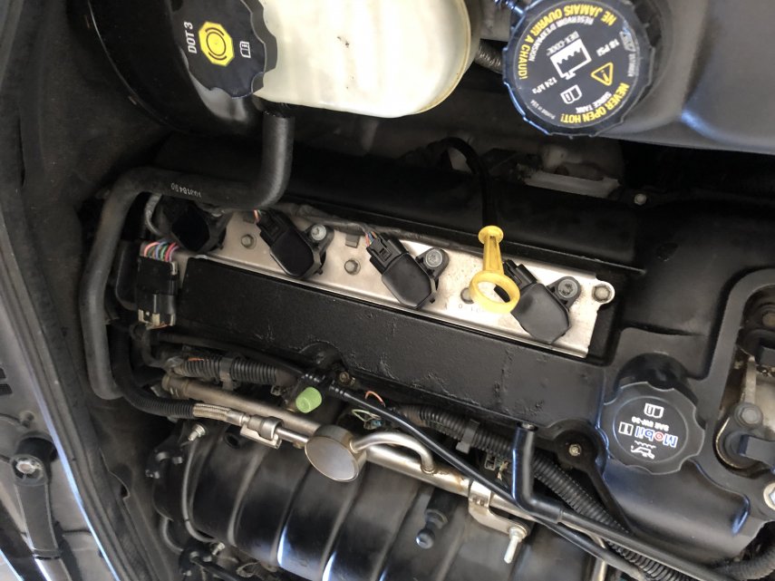

Burned the #7 coil pack - went to pull the plugs & one just shatters. And, the plug wells have a little oil in em
The driver side rail has already been swapped to the newer style. So, I’ll be replacing the passenger side coil rail & doing the valve covers here shortly0B1161FC-FD78-4EA9-8FE5-6EBAEF30FA81.jpg
