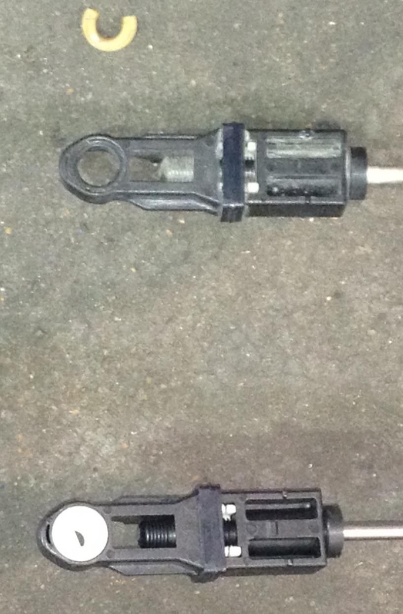

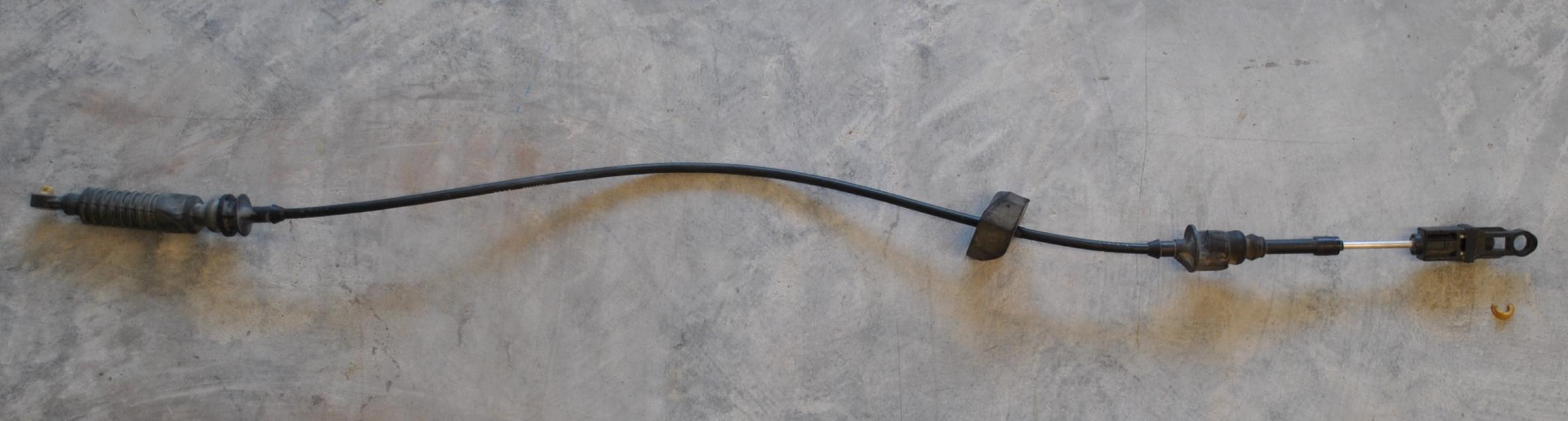

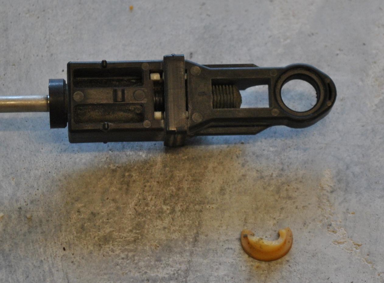

The first thumbnail is the new and old cables side by side; new one is on the bottom. Second is the entire length of the old cable. Last is what they found when they took the tunnel cover off -- the half moon is all that was left of the grommet. Guess the rest is in a parking lot in Pa.!

I was in such a hurry last night that I forgot to correct my original post - the broken piece was back at the transmission, not up at the gear shift.

Wow. Apparently it at the Tranny end that the cable grommet broke. I am sure a brass bushing could be machined and attached to replace the plastic. Sad that it was cheaped up to save a few cents. Thanks for the photos. Ordering a spare next week.
