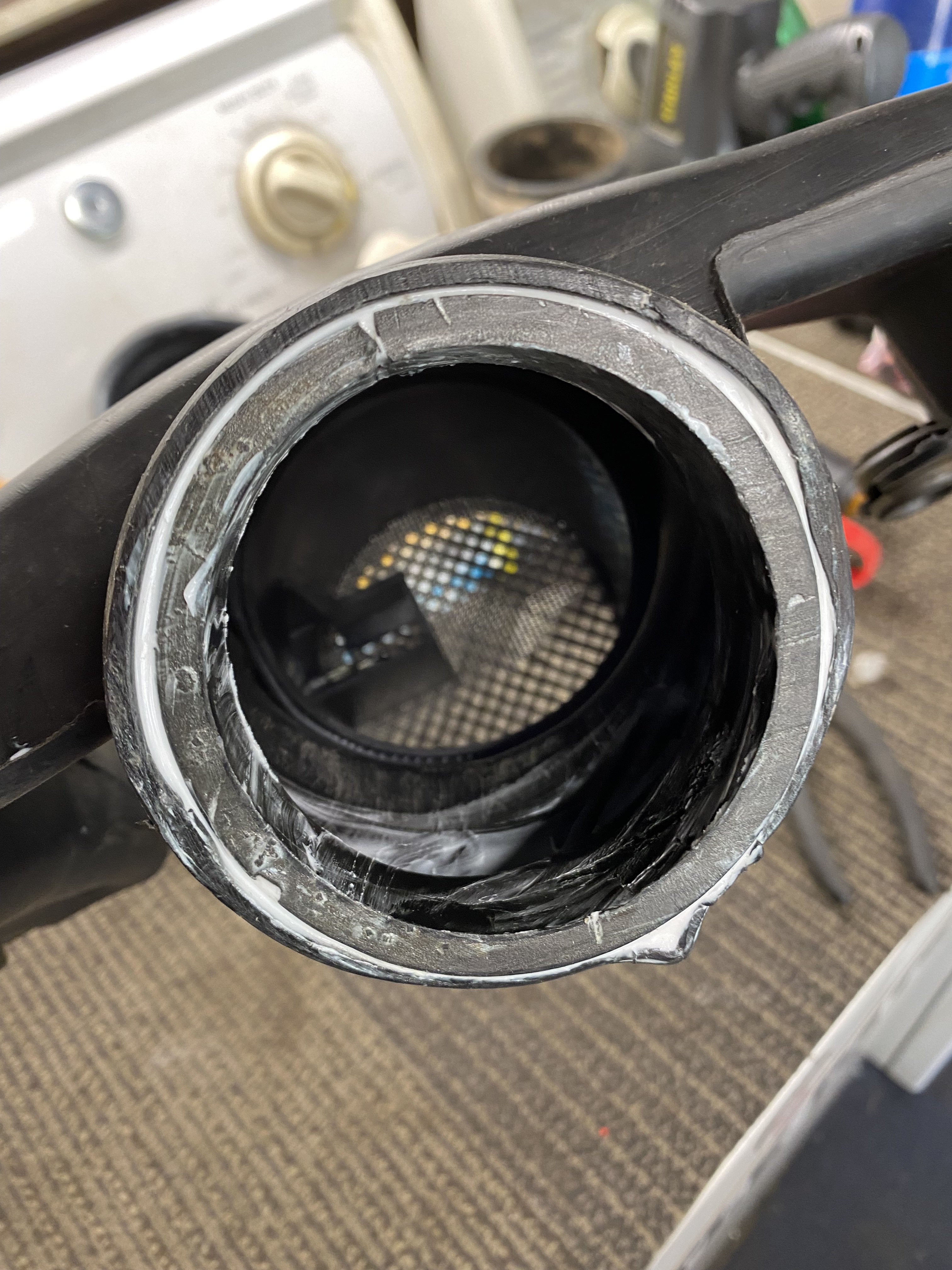

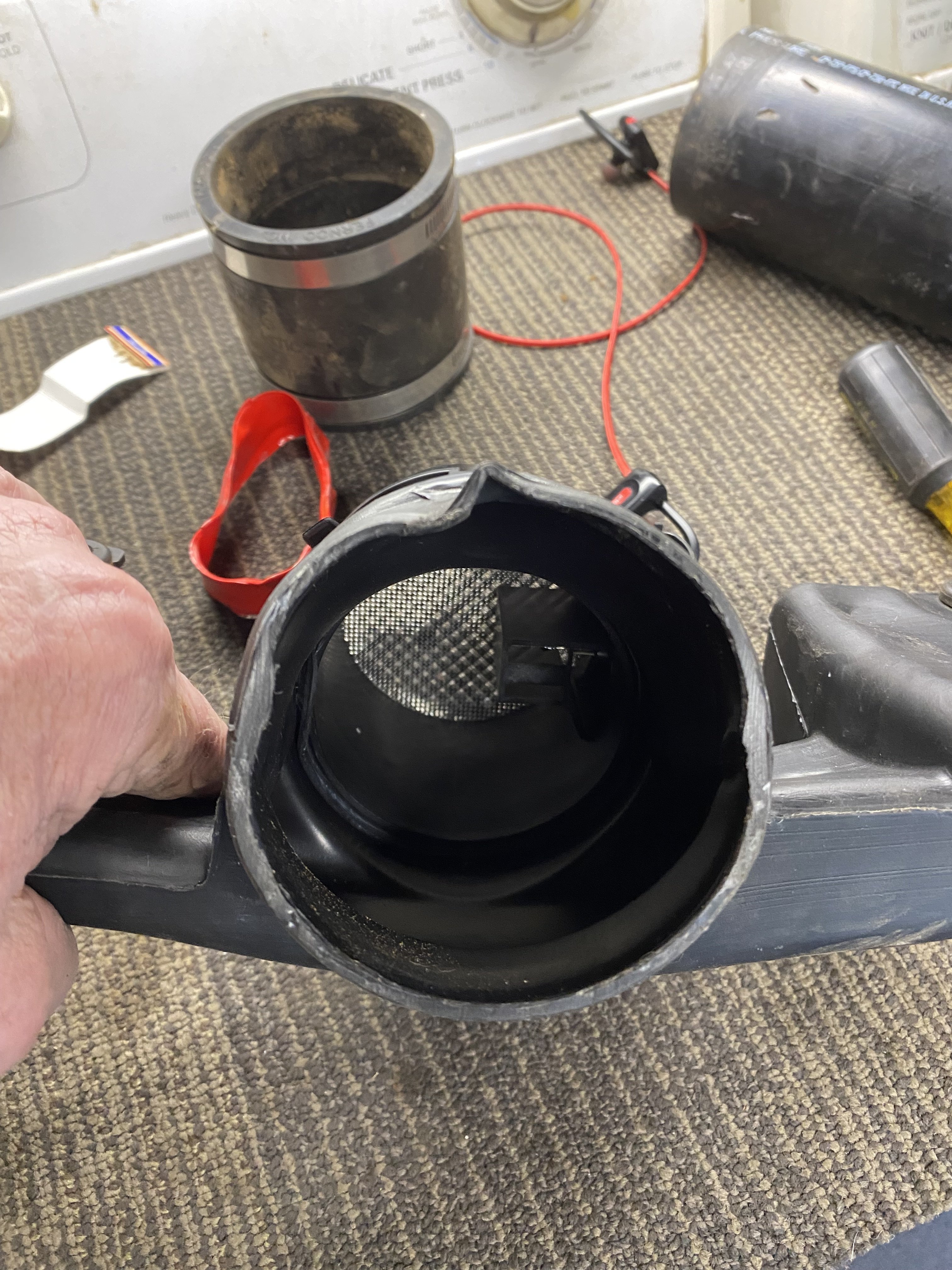

During COVID, I replaced most everything under the Hood.
All hoses (fuel, vacuum and coolant), Radiator, Thermostat, injectors, throttle body, MAF, MAP, Valve cover seals, Coils, Plugs, Intake Seals, Plenum and all 3 "Boots" or connectors. Not just throwing parts at it, just felt all needed to be replaced as it was at 140,000 miles/18years and all original.
It has/was running fine, last year had the AC Compressor replaced and a P0171 pops up occasionally. Started troubleshooting and finally found that when the Mechanic reinstalled the plenum he must have tightened the clamps with a breaker bar as the new plenum (rockauto $135) was deformed so much it was leaking at the throttle body connection. Corrected by heating up and inserting a short length of 3.5" ABS that I reduced to about 3.3" OD to act as a reinforcement, not going to bother replacing again as this is my 3rd.
Terrible designed intake/plenums, Shame as I never had any issues with my Corvettes but this car has always been problem with vacuum/intake leaks.
Seems to be working but have only driven a few short trips.
Thanks again for your assistance, J

Thank you for the details.
The air diffuser get crushed by the rubber connector when installing you must connect to the diffuser first then to the throttle body the angle will deform the air diffuser. I had the same condition on mine mainly because the MAF was wrong and to long making it diffuclt to make the connection. The main problems come from the plenum not being torqued, and the small hose coming off the right side valve cover to the air diffuser, and in my case wrong MAF.
