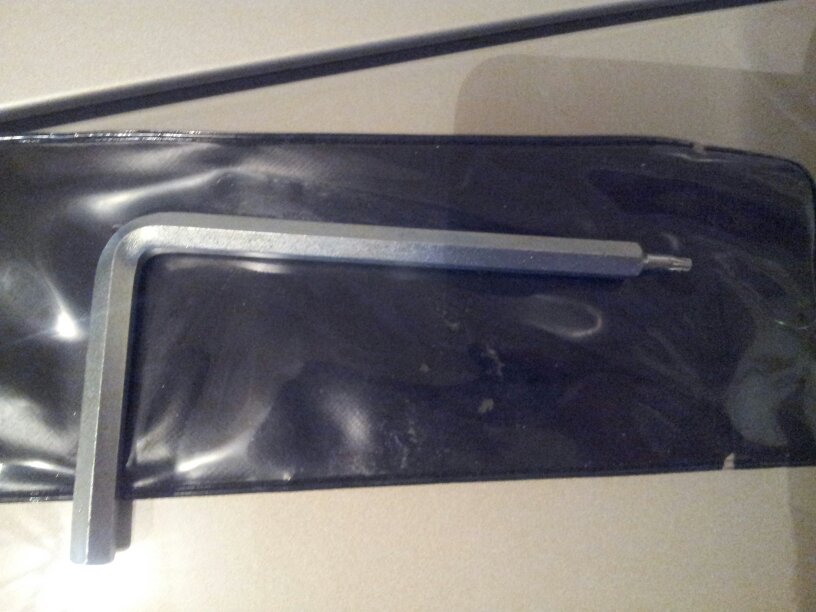

Magic Tool?
Thanks for the suggestion that we read the manual about this situation. It was sure helpful. HOWEVER, the text in the manual references some "tool", and it seems to be used for several things during the manual raising/lowering process. I'm the second owner of my XLR, and there's no such tool to be found in my vehicle. Can someone please post a description of what makes up the "tool", and where I might come by one? :dunno:

Here is a picture of the tool in question, I found mine in the glove box when I purchased the car.

Ah... Looks like a combo tool w/ a Torx and an Allen wrench. Is that right?
What are the two sizes?

Yes, that is correct. The Torx is a T-15 and the Allen wrench is 8mm. There are several owners without the correct tool that carry two separate tools. I happened to find mine on Ebay several years ago.
Looks like a good excuse for me to head to Harbor Freight. :chuckle I already found a spare 8mm Allen wrench, so I'll get a set of torx heads to fit a ratcheting screwdriver set, and I'll be good to go. ;)
