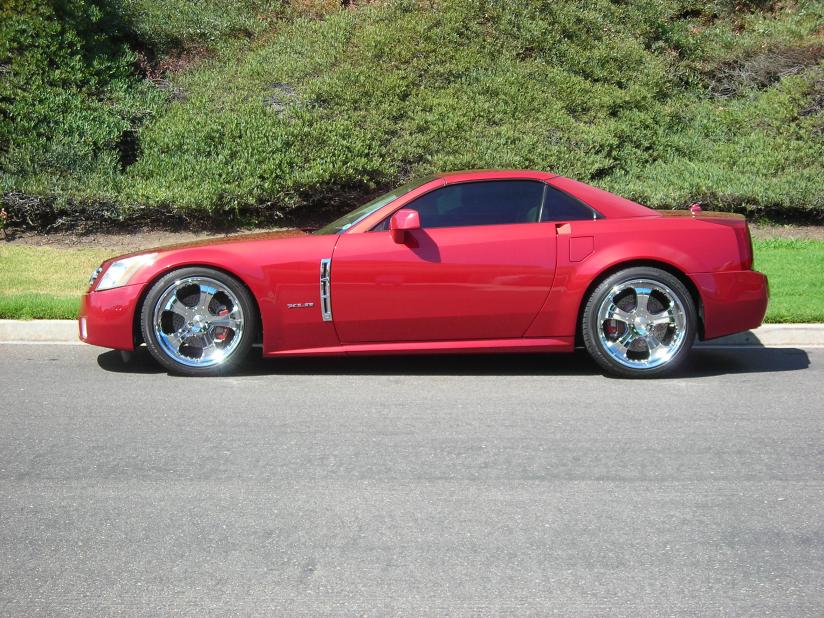

OK, Mad-wheel-man, more pictures and details, as requested.
First the wheel spec's
- Front 20 X 9 with 47mm offset
- Back 20 X 10 with 47 mm offset (yes, this makes them stick out for a wider stance than stock)
The side view, with top up

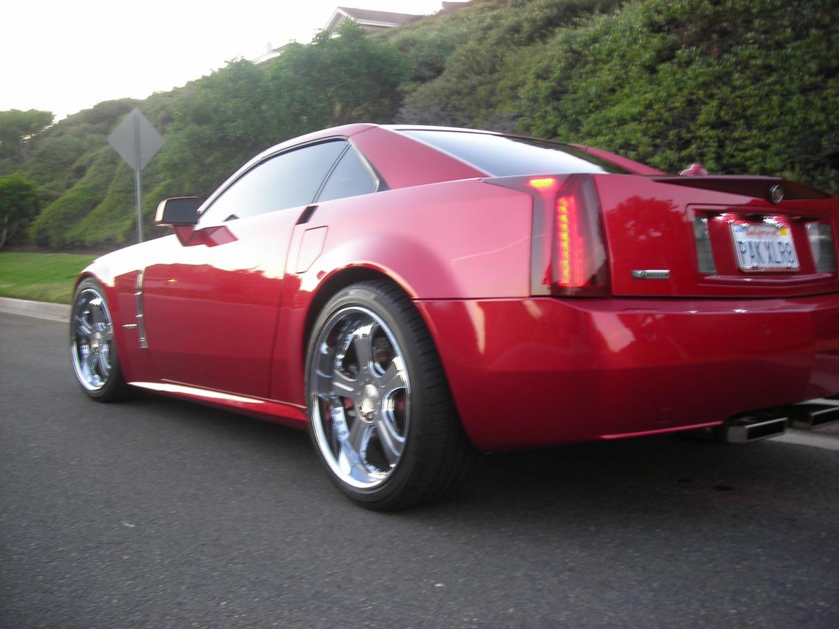

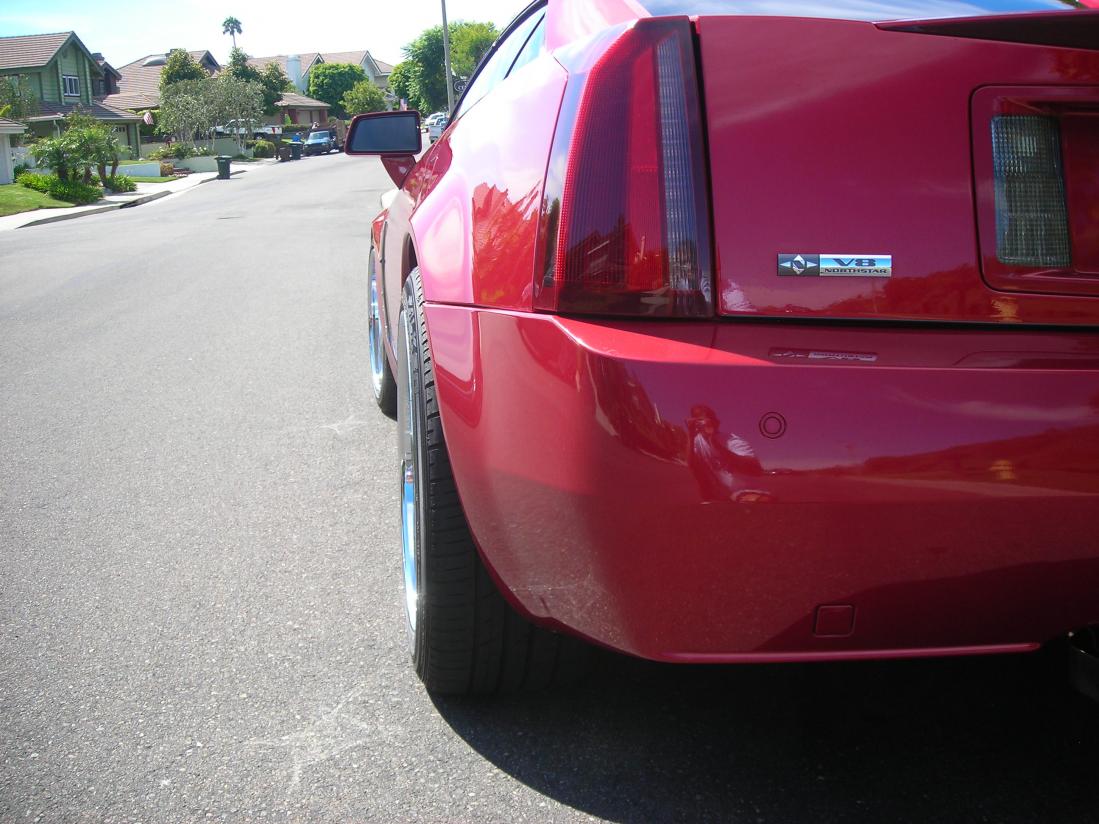

Rear quarter view
Back tire flush to rear fender

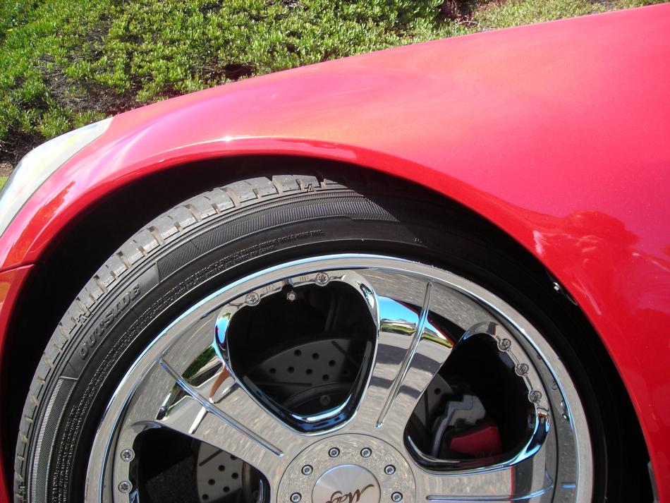

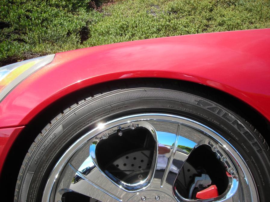

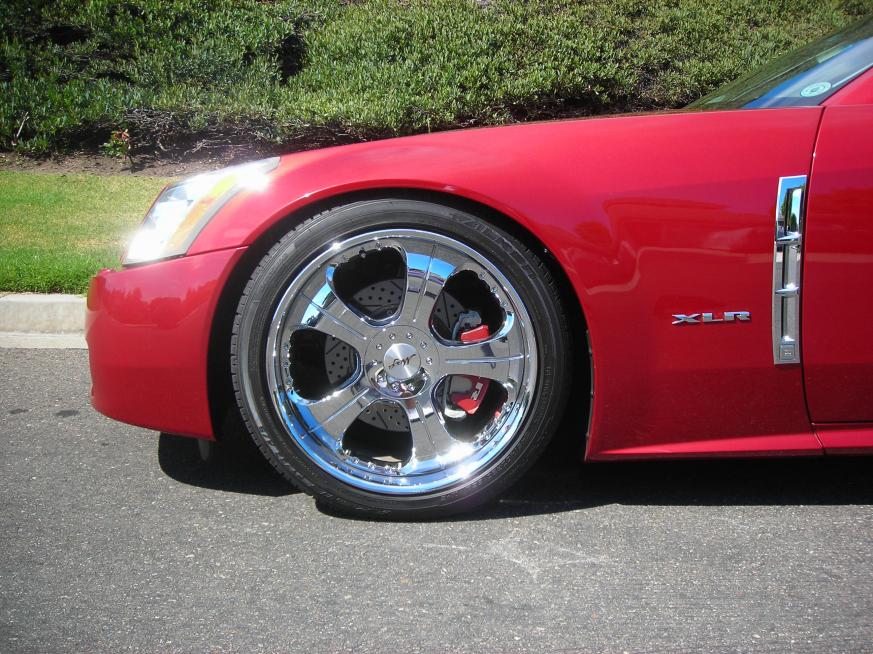

Front tire close up
Front tire clearance
Front tire turn clearance - no rub, barely
