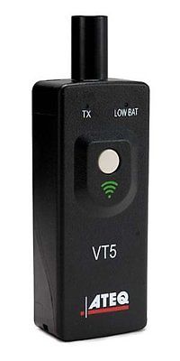

I was doing this so much last year while racing 2 or 3 times a month, I had to go ahead and get my own tool. Since I like trolling eBay I found an ATEQ VT5 for $49.99 and pounced on it. (they're normally $80 or more)
Works great so I keep it on the shelf below my 2 sets of racing wheels/tires. Whenever I change config, its right there in front of me ready to go. Compact, light and one button idiot proof (well almost, gotta change the 9V battery when it says so).
