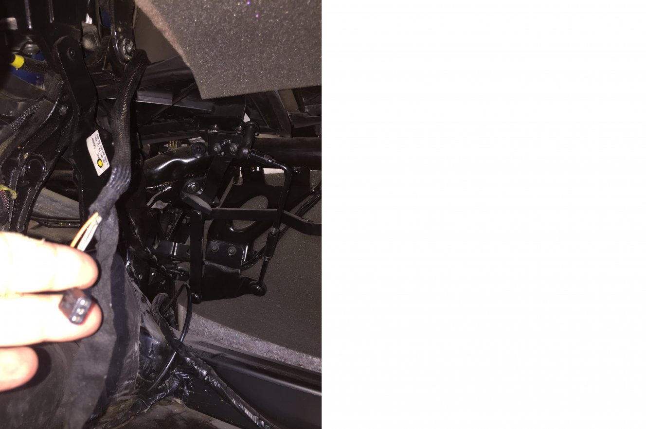

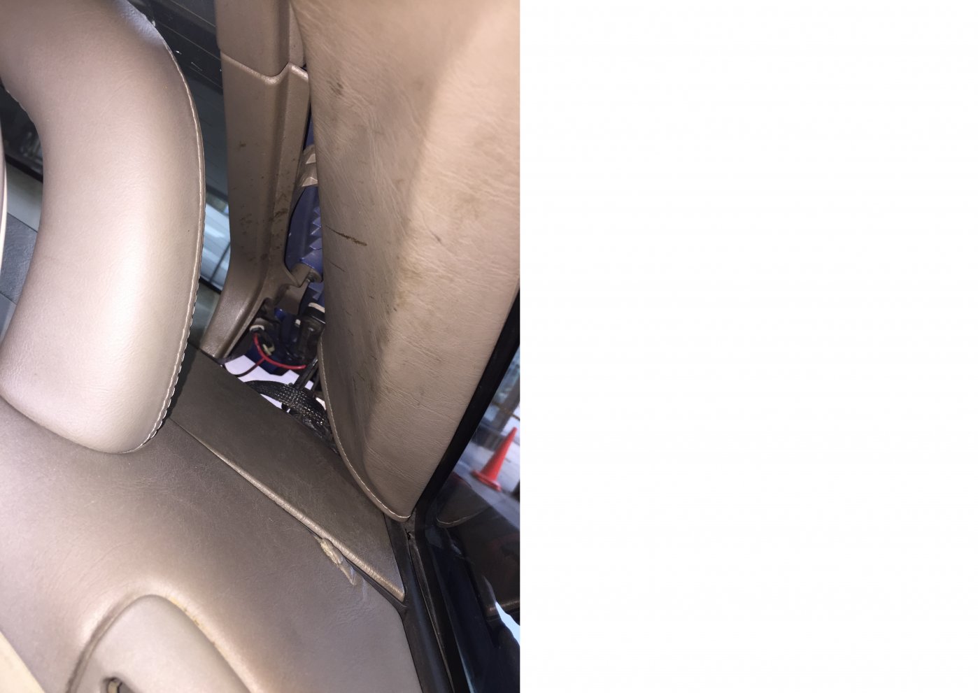

Here is a pic of my interior just behind the drivers seat. It is open to the trunk, Am I missing something or are they all like that?

The first picture looks like the vinyl cover was not installed correctly to cover the gap. It should look similar to the passenger side. There's a clip on the bottom that is a PITA to install if it comes loose. I suspect that is the problem.

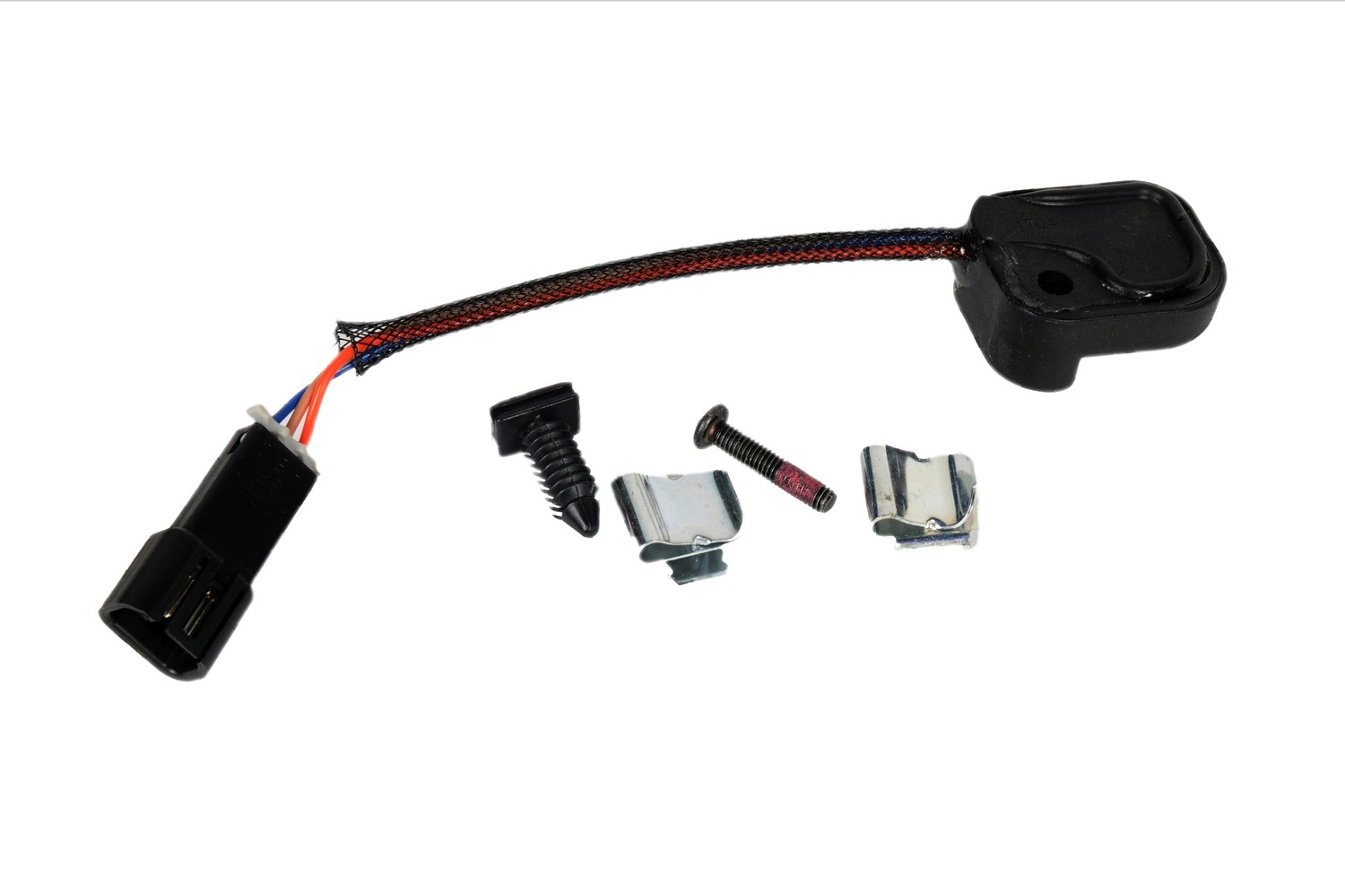

Note in the sample sensor picture, the wires are Blue-Tan-Orange; there may be different revisions through the years for this part, since Grey is called out in the wiring diagrams.

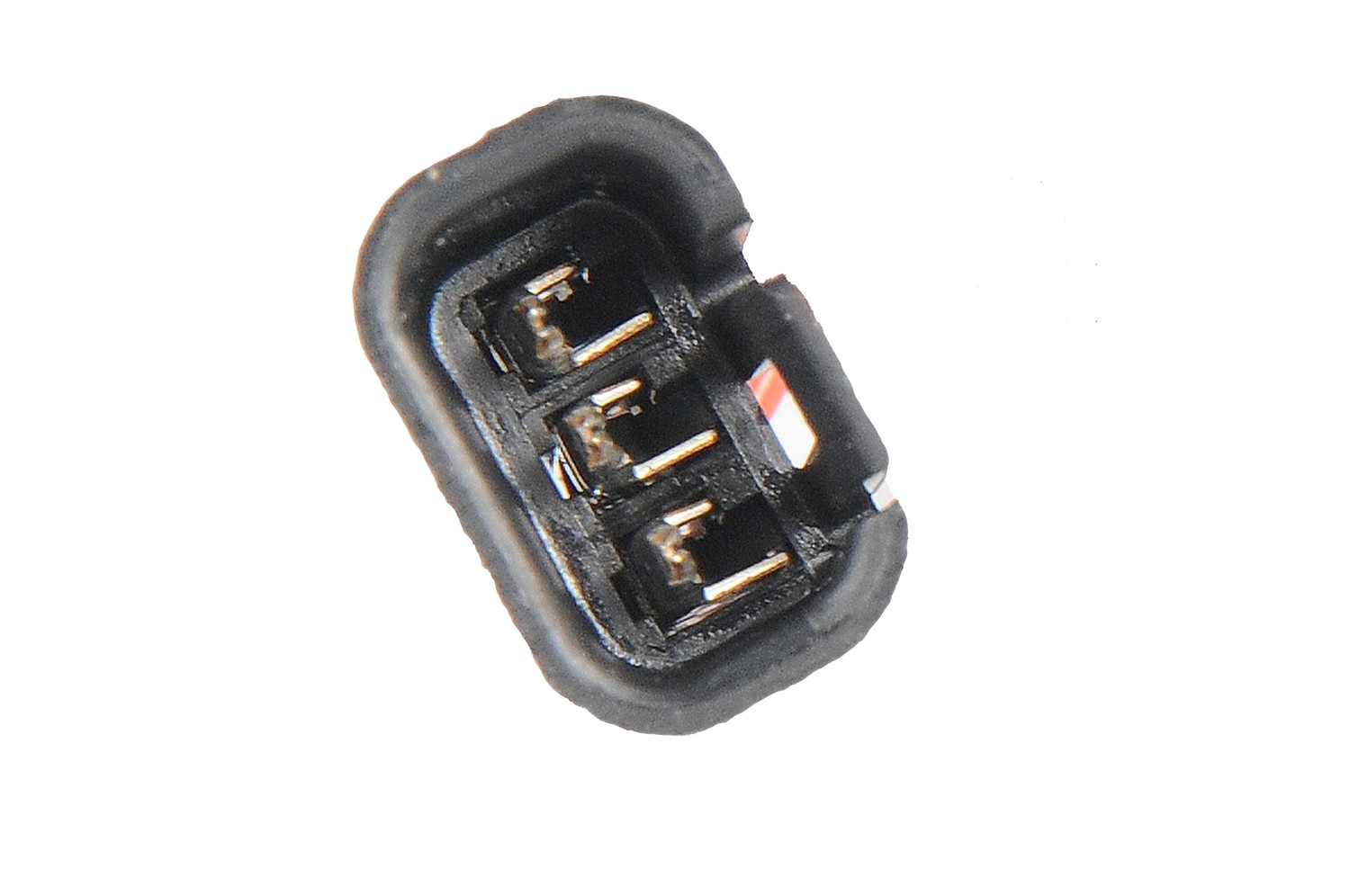

Looking at the (sensor side) connector face with the clips oriented upwards, the pinouts are from L-R: A-B-C. The P/N is 19210515 (Called a switch, but it's a sensor.)

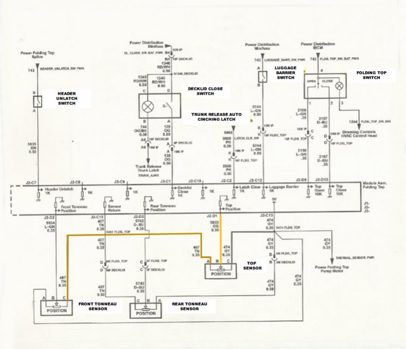

I've enclosed a sensor wiring diagram with the hope it will make your troubleshooting easier.
CC :wave:
