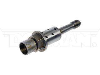

Check engine light came on. Went to local Cadillac dealer and the 4.6 Northstar engine needs this control valve. The dealer said that they have no parts available and will make some calls to try to find a used part somewhere. Anyone know where I can get this part? 2005 Cadillac XLR.

I think he needs the control valve. there have been none of those around anywhere for about 2 years now. Moog had them listed as back ordered but they never made any and dropped the part number. I saw a couple of used ones on ebay bring 500$ each .Give us the part number the dealer says you need and we can advise you as people call the same part by different names
The dealer gave me the following part numbers-12613455 (GM), Dorman 916-870 (out of stock).

I do need the control valve. Just chatted with Susan at dormanproducts.com. The part number is still active #916-870 and they are just out of stock. She told me that they still make the part and they expect a shipment in 90 days. Good news? I will try to double check the information.
Called Dorman. She told me that they are expecting a shipment of this part at their Kentucky location November 3. I was reassured that this is the Dorman 916-870 VVT oil control valve (GM 12613455) that I need per the dealership.

Those valves are just long enough to hit the radiator when being pulled out. Techs who actually has done this job, will know this. Also few techs will do this because of the actuator gasket issue GM caused.
