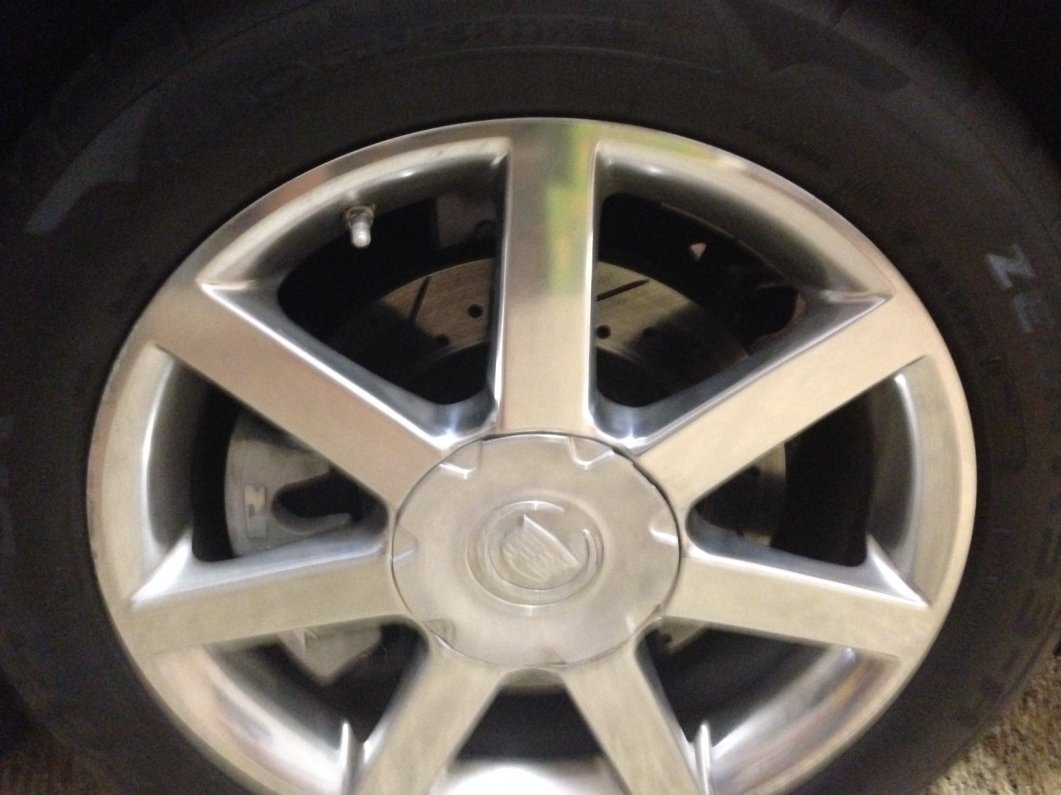

installed black R1 drilled and slotted rotors and ceramic pads
So the brakes work great. I was having problems with pulsing when I was applying my brakes at speed and decided to upgrade. Makes a huge difference. I need to get the calipers powder coated now.

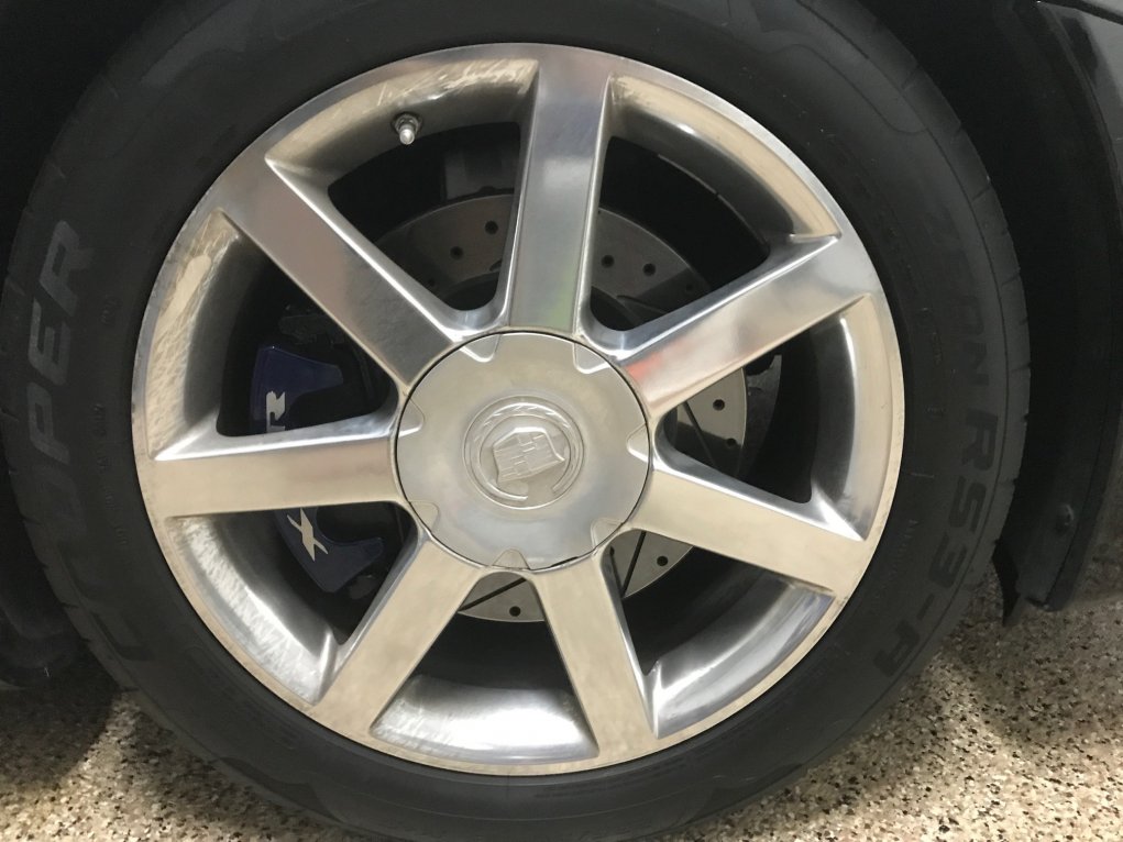

Contact Cadillac Tech. He has access to a powder coater that as a set of caliper cores. That way you get the new powder coated calipers and send your cores back after the new ones are installed. You need to tell him what color combo you want. I went with infrared calipers with black brackets and silver lettering.
They still look good. The wheels are dirty but took a picture for you just now.
