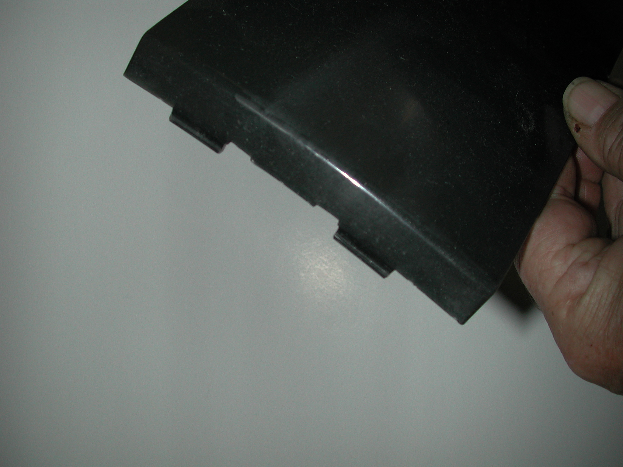

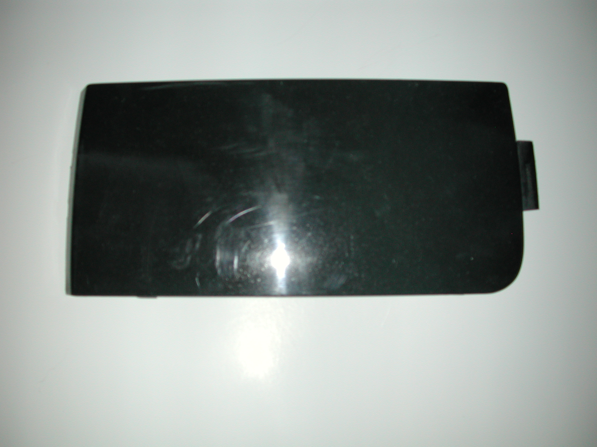

no need to remove the grille .it is held on with two snap in tabs on the square end and one larger slotted one on the rounded end be carefull not to break the grill on the two tabs .just pry gently to pop it out
Yes, Thanks I did remove and find debris and dirt in the lens! I cleaned it inside and out and the box behind the lens. I did a test drive and the message returned several times on a 50 mile round trip! Tried moving the steering wheel up and down and around also! Rains came so I will continue on with the search for and answer!
