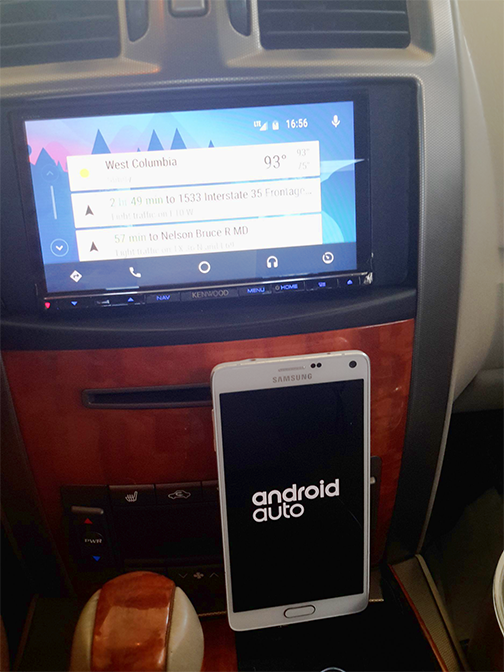

I decided to upgrade the radio/navigation system in my 2009 XLR. With no current maps available, and no interface with newer services (like Apple CarPlay,) I decided to bring the navigation/entertainment system into the 21th century!
Yesterday, I had a Kenwood DMX957XR system installed. It totally replaced the old navigation, radio, CD player, etc. without losing any of the existing Cadillac functions like steering controls, backup sensor, heads-up display, etc. I added the Sirius/XM module as well so have that functionality as well. Navigation now comes from Apple CarPlay, using the constantly updated Apple (or Google) maps. Full hands free phone functionality, talking text messaging, and all other functions we have on our smart phones. I love it!

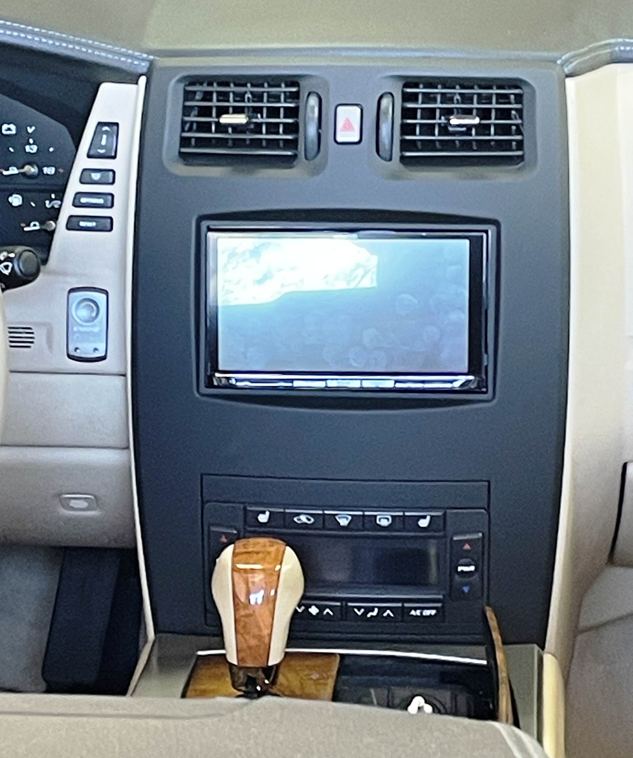

It did require the replacement of the center dash "fascia." However, the replacement fascia looks great. See the attached photo.
I am very happy with the result, especially the expanded hands free functionality!

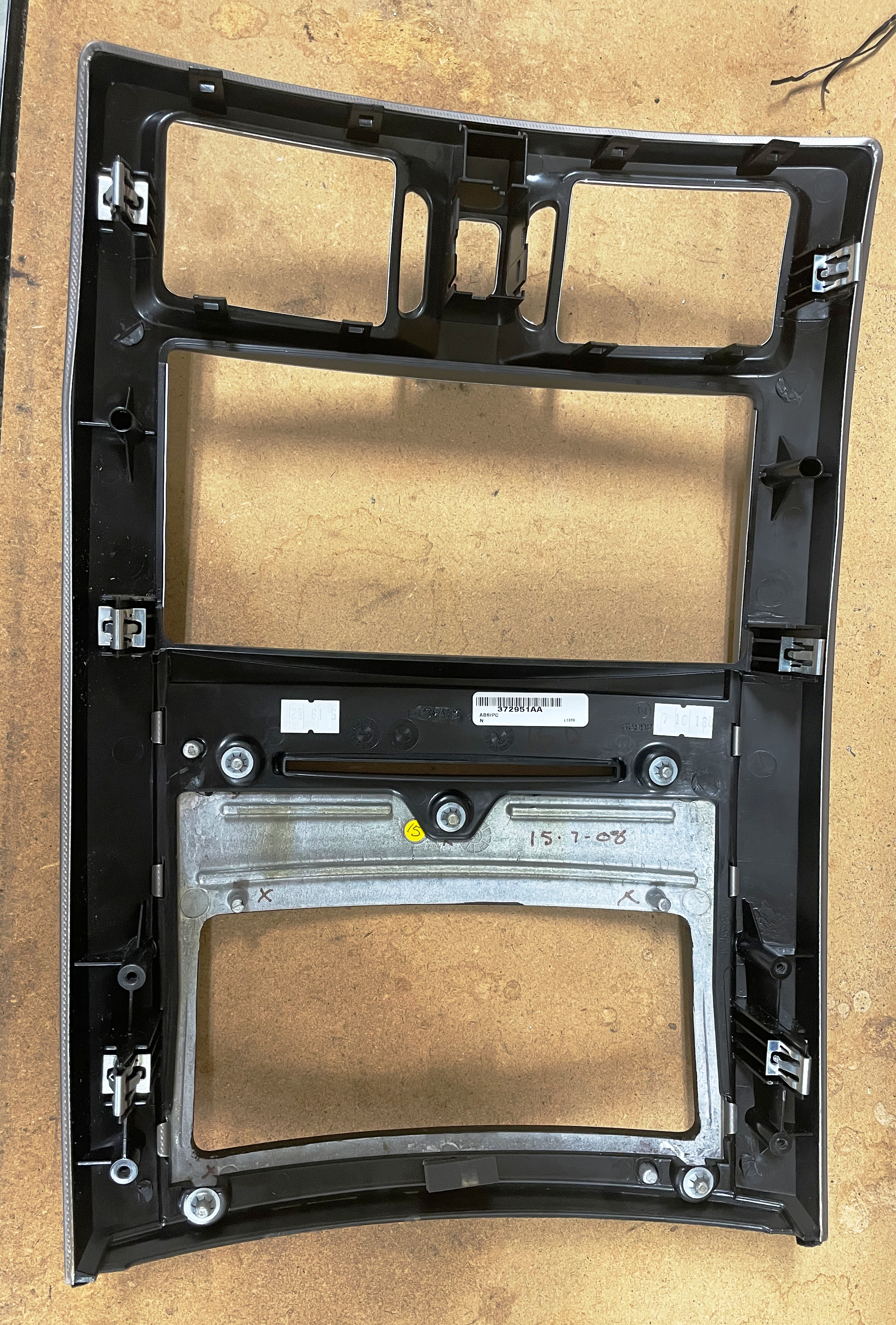

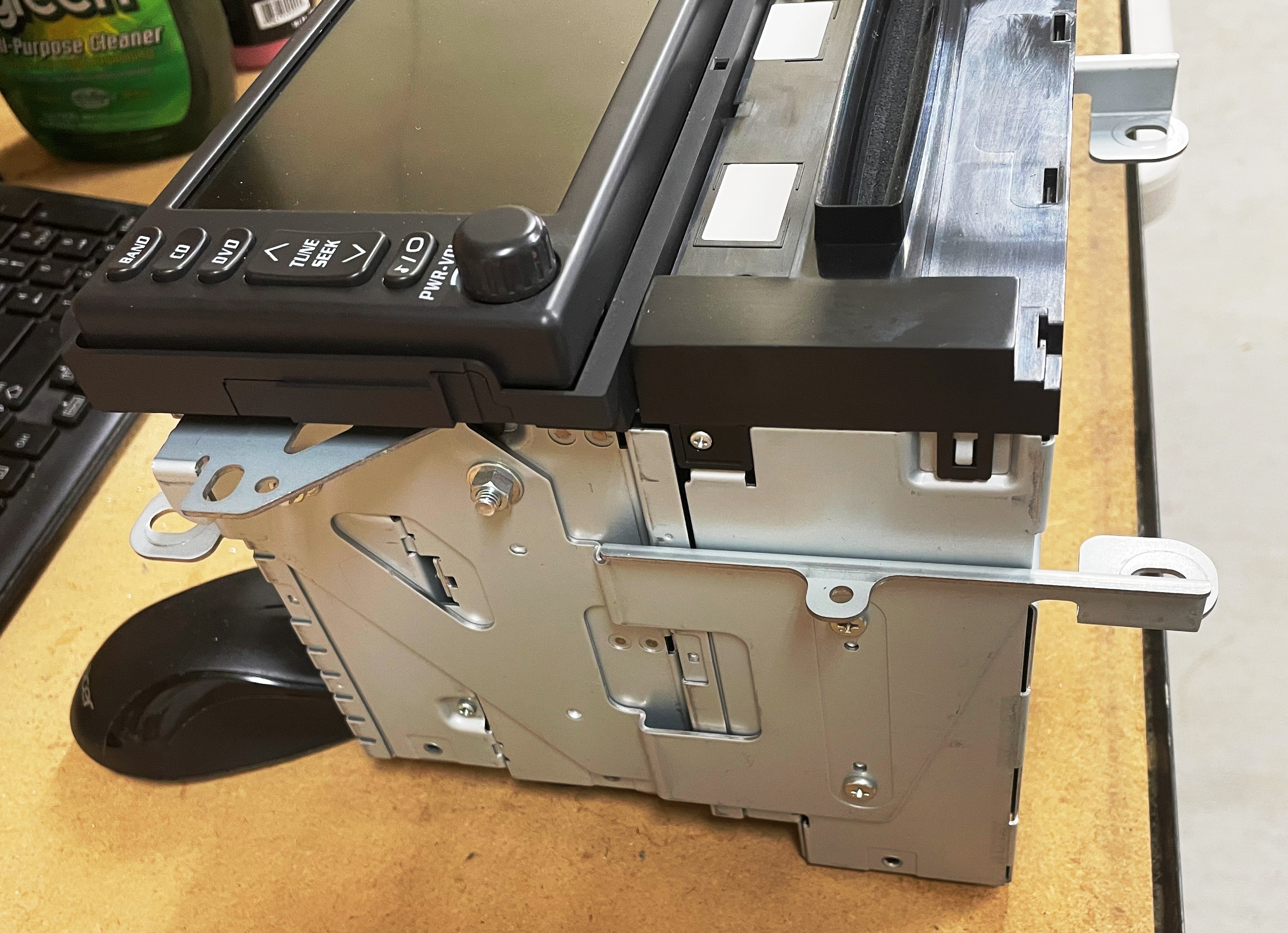

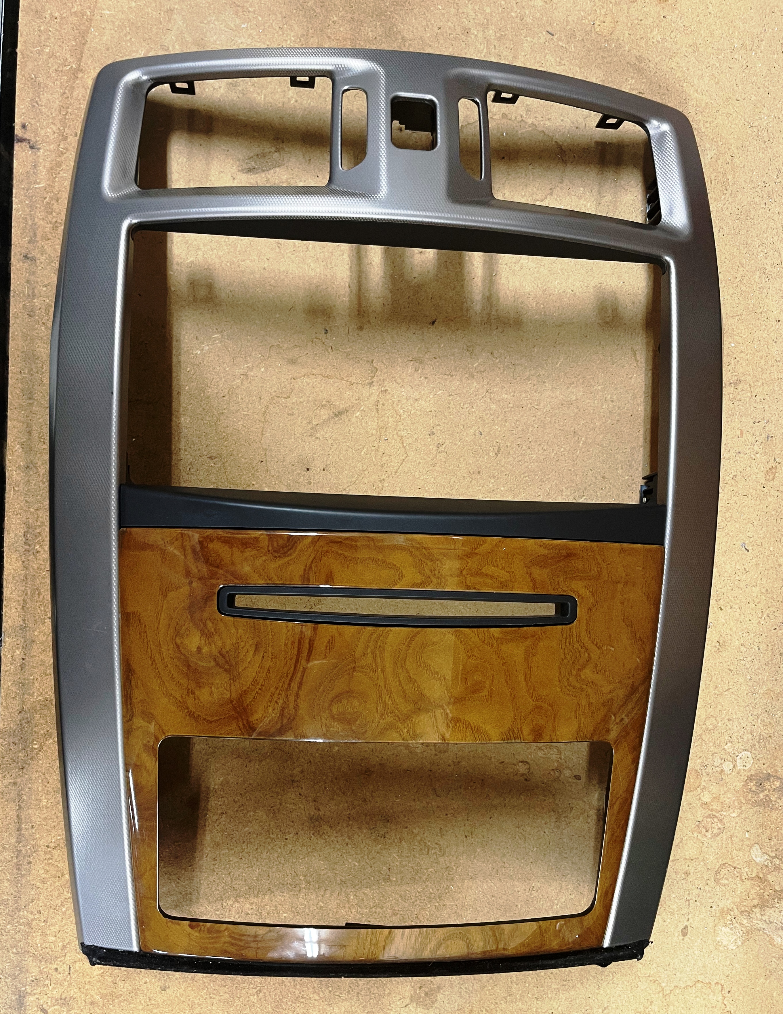

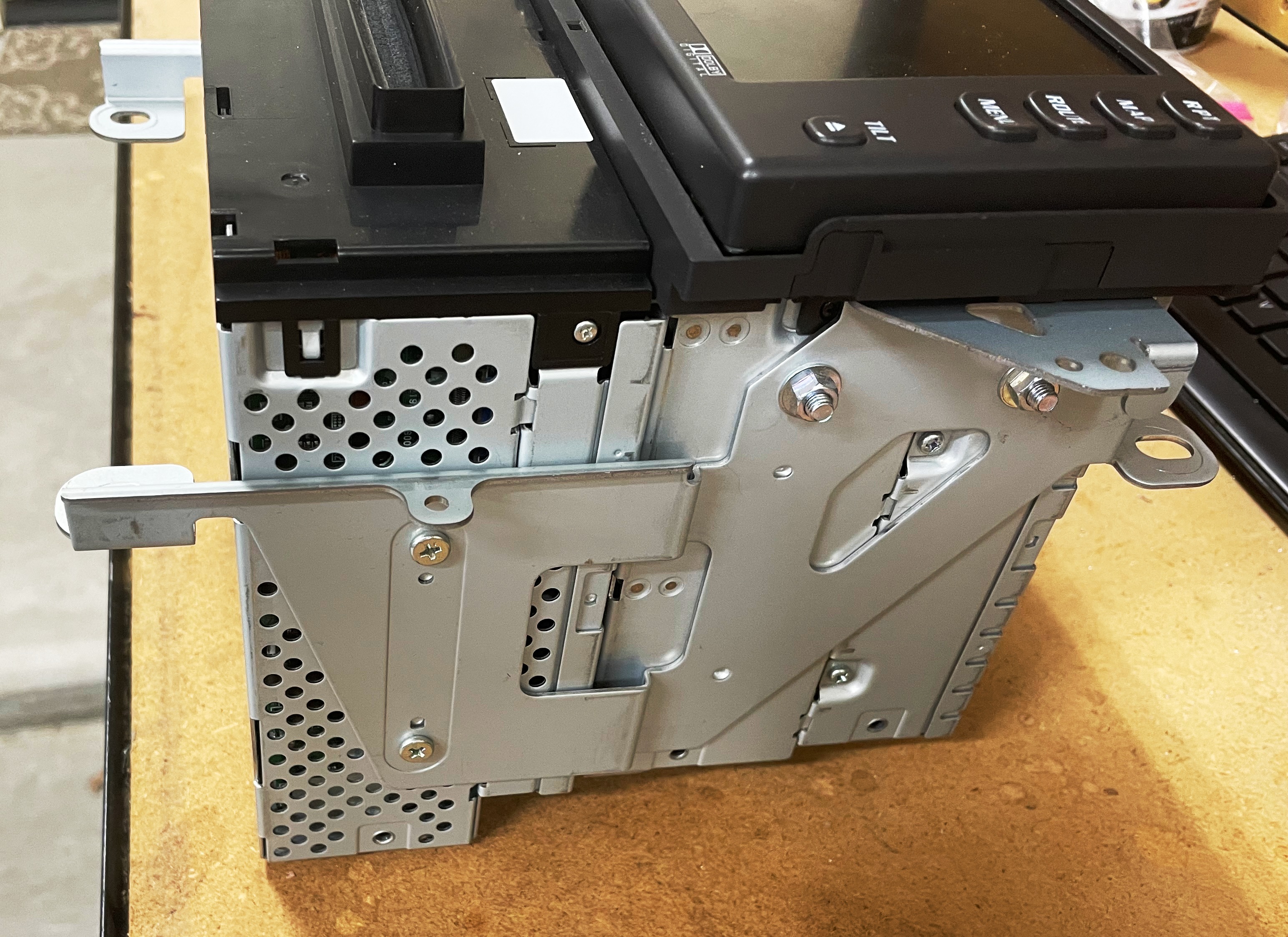

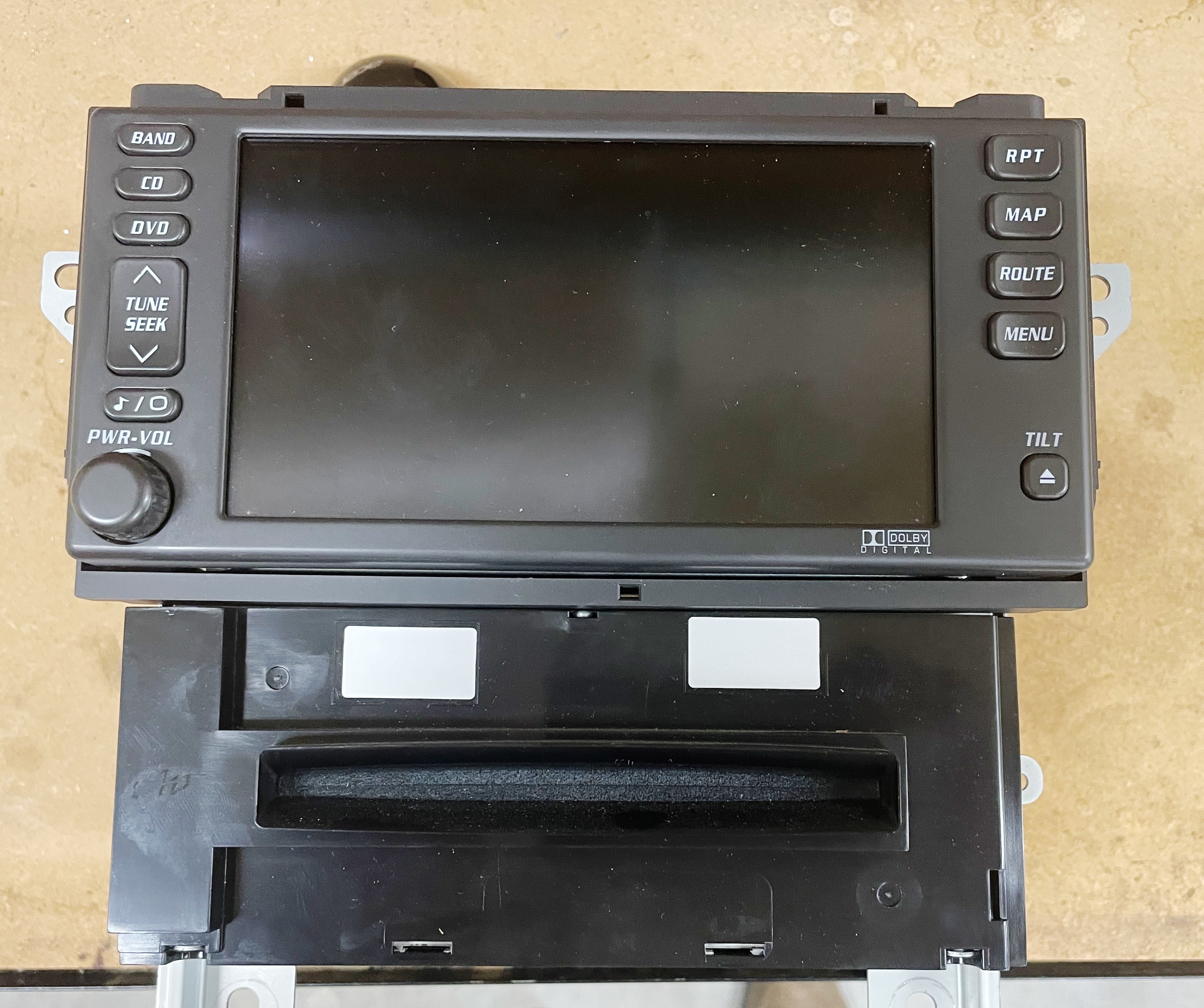

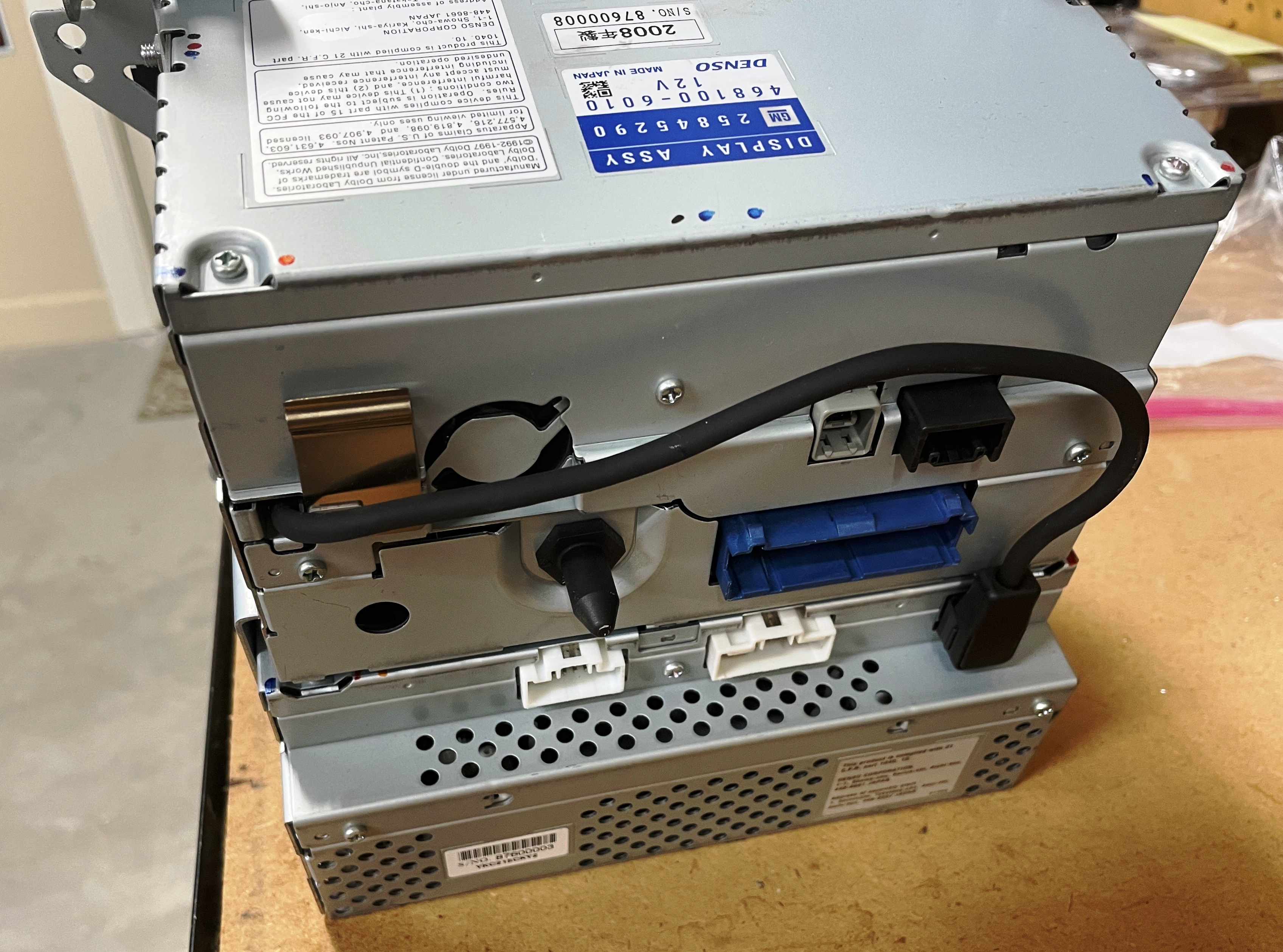

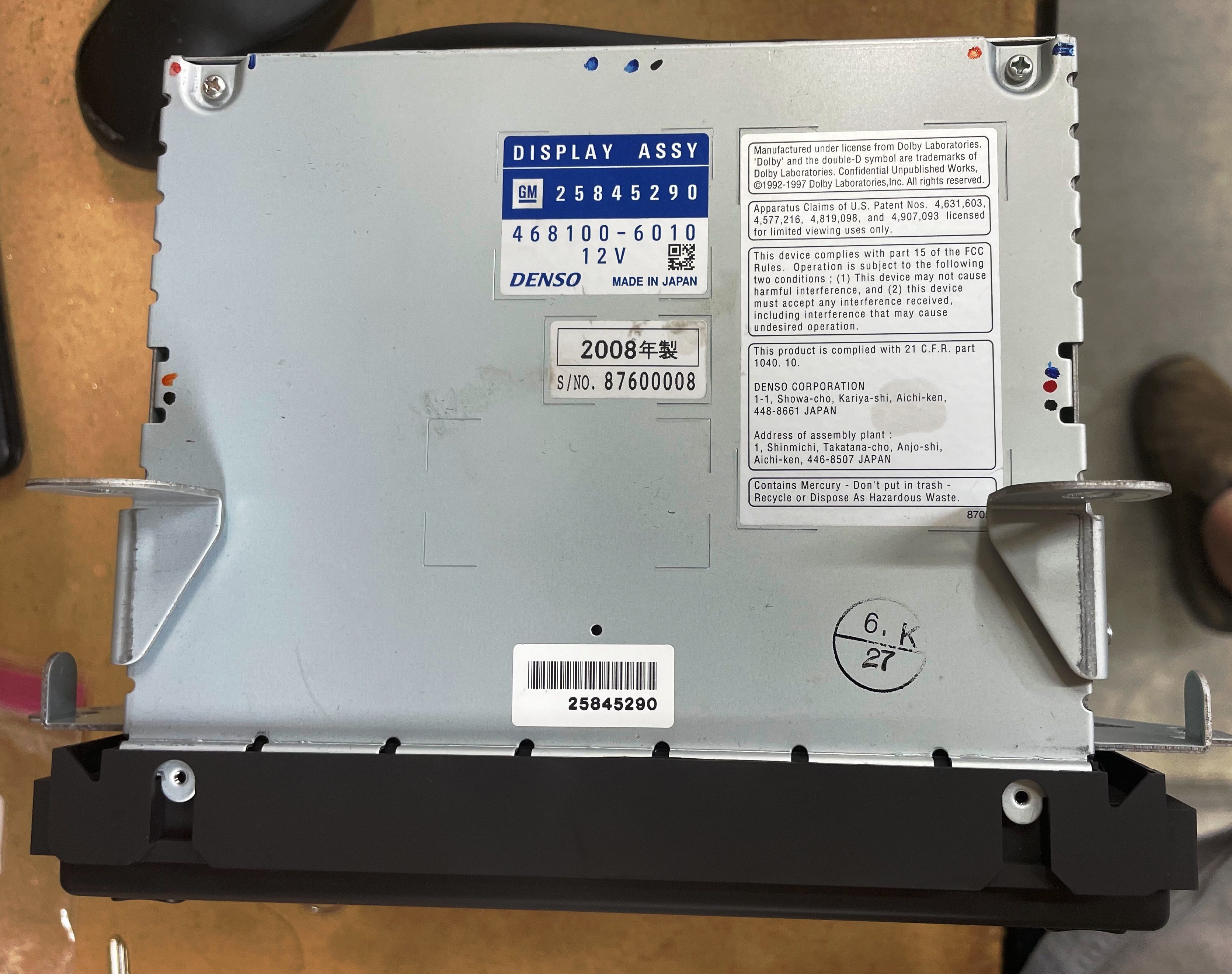

I will be selling the old system, as well as the original dash fascia. These are from a 20k mile car so close to new! If anyone is interested in these parts, send me a private message. Thanks. Hal

@rexster:
Easy way to make it look better would be to vinyl wrap it (carbon fiber or wood look) or paint it. They come black ABS so easy to make look better if you want. I would probably do something like that if I ever update mine.
As long as Hal is happy with it is all that matters. We all have different tastes and priorities.
@rexster:
I'm sure he's happy with it. I'm happy stating my opinion as well.
You have to excuse me, but that faceplate is just plain butt ugly. Doesn't do the car any favors.
I agree it would look better with some wood trim like the original. The black dash pad, in my opinion, made it acceptable. I do like the suggestion of some sort of "wrap" over some of the black. Perhaps I'll look into who might be able to do something like that. All that said, the added functionality of the radio (mainly Car-play,) is worth the compromise (to me!)
