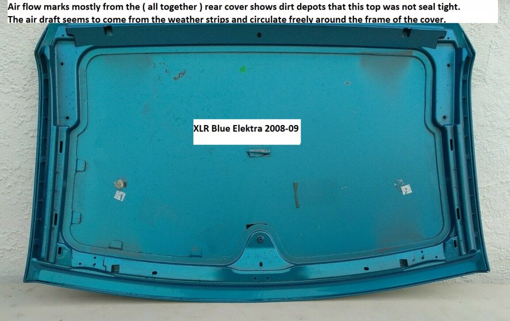

Now today i realise that it could happened, as we saw on this site some roof covers flying on the road, they say that a photo worth a thousand words is in it, enclosed is a photo on internet that shows a 2008 Elecktra completed roof cover, the cover shows internaly the air that circulated freely and the air seems to come from the rear and the sides weatherstrips.

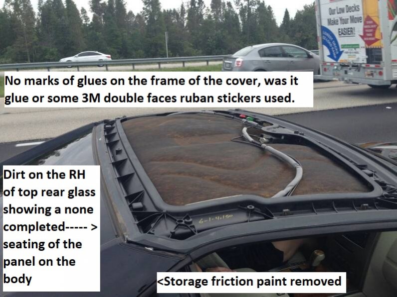

An other photo shows of pop out roof cover, showing dirt on the RH side indicating that the cover was not seating properly on the roof boby and it could get the air coming in as per previous photo shows it, the possibility of unlevelled cover could withthe help of the vibrations and the hot weather had the roof unlock and creating a very strong air pressure.

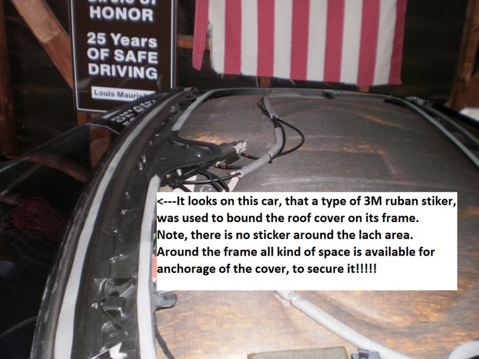

An other photo shows the type of material to bound the cover on the roof frame, it looks like a 3M ruban stickers, if that tiny ruban do not propely with both shapes of the components there could be a chance off bad bounds is in it.

The top skin is secured to the substructure with panel bond .A product that has been around and used since the early 80's in production autos and since the mid 70's in Formula one. The xlr has a full perimeter of bond all the way around the top skin plus an inner bond area.. The dirty corner he shows is because the outer skin does sit proud on the cornerof the inner frame so as to align with the back glass sections. The top latches DO NOT COME LOOSE> There are many fail safes that will not allow the top to partially latch. The switch in the latch is the last to stop the cycle. The latching of the top has nothing to do with the outer skin coming off. Since the bonding material has lasted much longer on the xlr than the problem that was discovered with the corvette , it is most likely a different reason. there may be many reasons for this. Most likely the heat that the cars are subject to In Florida has a lot to do with it. AS A black car In the sun in florida can get to temps of 140 degrees and higher, that gets close to the temp needed to release the bonding material.
The site administrator here I believe was looking into the location of the cars with known failures and also the years and color.
Most likely GM used the 3m product as the fusor and other may have been used. All have a very similar temp range. The mixing ratio is very critical in the application process as is the install working time .As this is all controlled at the factory and they know these limits I doubt that is the problem. Most of the exotic Italian cars that are also bonded require that they not have the paint repair baked but be air dried as the heat cycle In a paint booth can cause premature failure of bonded areas. Most likely just the heat is the problem as the cars I have seen are darker colors. if the bonding material releases of course the wind will get under it and cause wind noise and full release of the outer skin. If you stop your top in the open position you can look to see if the seal has any gaps or simply tap the roof panel to see if it is a solid sound or a drum type sound..
The reason the seal appears smooth is the underside of the top is smooth and their is a complete failure of the bond to the top. It could also be because of reside from the mold release used on the smc top panel not being fully cleaned and the heat causes the waxes to leach out of the smc material over time. The top is not taped on with double sided tape.

The main reason for me to wright this issue, is the elektra blue XlR roof cover, that bother me a lot, for that air getting in side on a 2008 XLR and it is not 2004-05 models, is this happening the same on all our XLR..... i am seriously wondering.
The air that getting in, shows that the retractable top is not air tight and that is something new for many of us is in it.

Regarding the bounds material used, we all agreed that GM is not using wall paper glue….. what ever how good it is…. the bound material has fail.

since its an issue on dark cars only and in the hotter areas exposed to sun heat, It will be by a case by case. They will not issue a recall. They are letting the cars just die off as wrecked or flooded and will have fewer and fewer to deal with in the future. It is not an issue of time. Its an issue of heat cycles that is causing the failures. This is the same bonding materials used back in 93 forward on the saturns without any failures .the tops on those also were bolted and bonded and were metal that displaced the heat better. Just read all about it over on the corvette forums. In depth stories there.

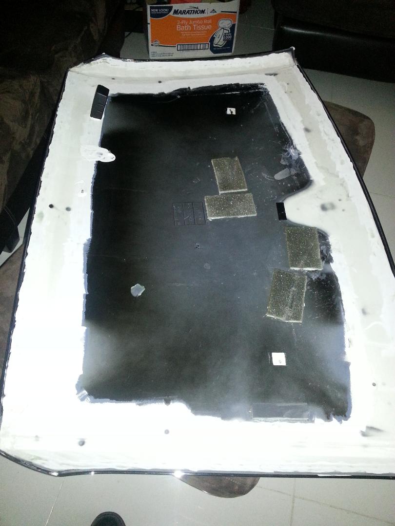

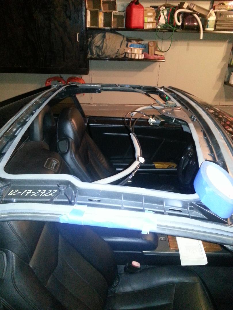

When i purchase mine from the auction i always believe that it detached because of the minor door accident that it had. but i guess im not the only one.i was cruising in some road with lots of trees lots of space around and pheewwww i look my rear view mirror and the car behind me pass me and kept honking at me pointing to the back so i stop got out of the car and right away saw my roof gone i drove back and saw it on the side grass area i was lucky it landed on grass. but i do notice my panel 04 is different from the 06 07 08 09, mine its just plane and simple has no brackets or nothing to grab and drill holes to put zipties or anything for extra securing, so even though i put it back with some heavy duty glue its very tempting to just drill some holes and put counter sync screws an cover them with bondo and paint them since ill probably wont be able to find another one for sale with out somebody wanting 1000+ for one if it decides to fly away from me again
did you grind all the bonding material away? I would think GM would get you a new one based on it coming off. Black in a hot climate is what is doing it
i really dont remember what i did, this happen 4 years ago. i think i did got my dremel to clean it. But yeap that black didnt help especially in Houston, Texas
